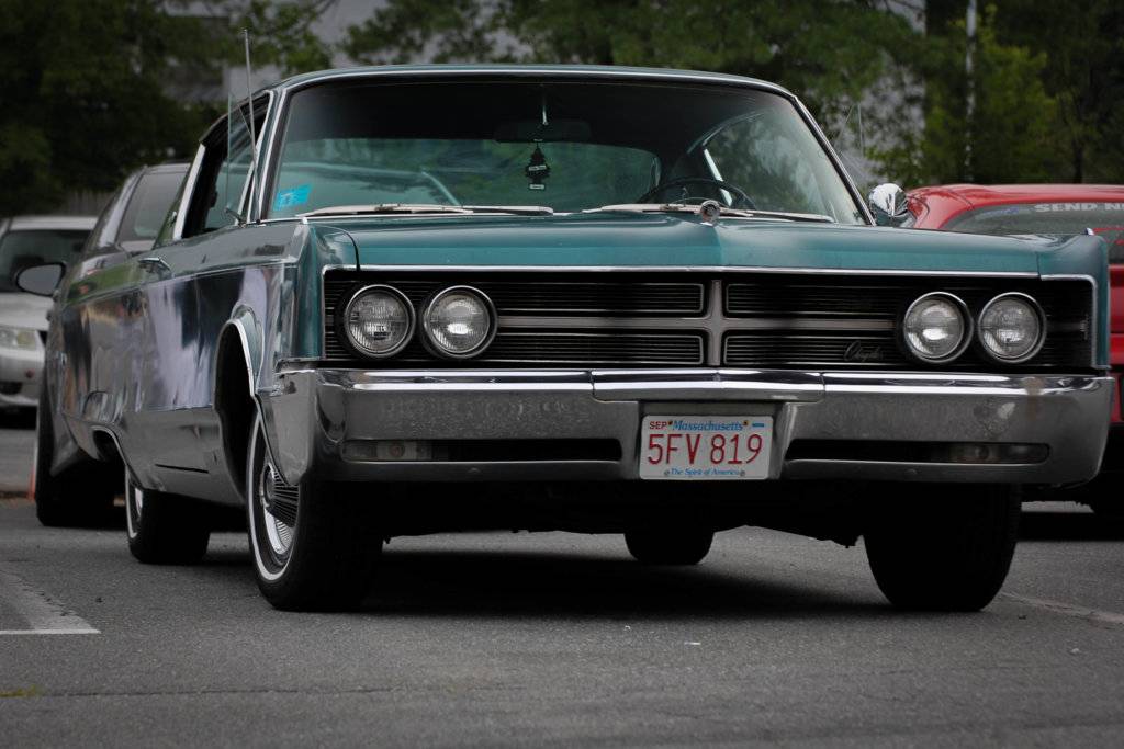

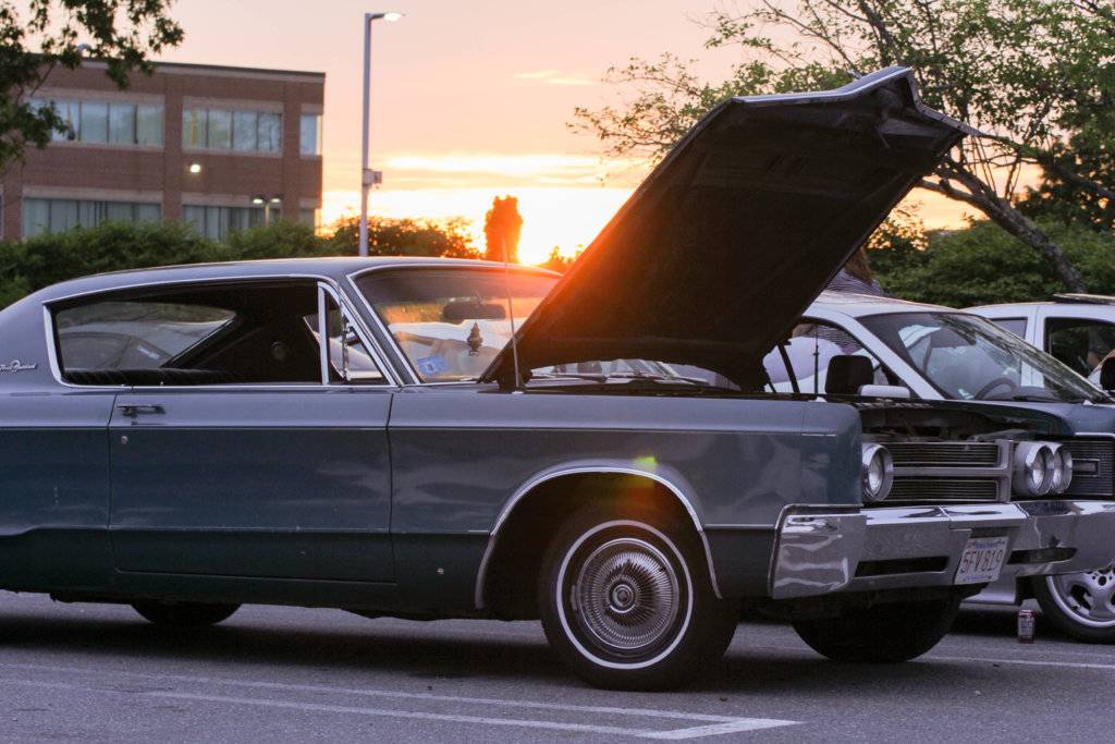

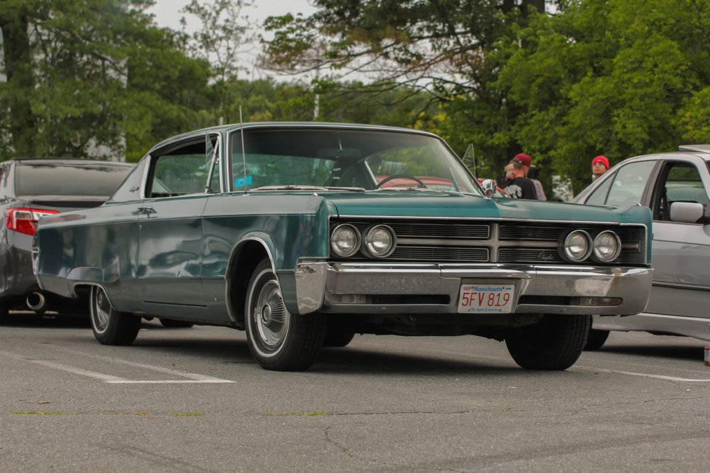

Here are some pictures of the car and how it looks now. My little brother took the pictures. He convinced me to take it to what he called a "car show." Well it was more like a car meet up of kids with imports who smoked weed in a burger king parking lot and had lowered cars on cheap rims.
But he took some decent photos so here she is.
View attachment 206218 View attachment 206219 View attachment 206220
She's purdy...keep her that way. And drive her as much as you can damn it! When the ricers start gettin stooopid, bounce out of there and hit a country road for a cruise.
