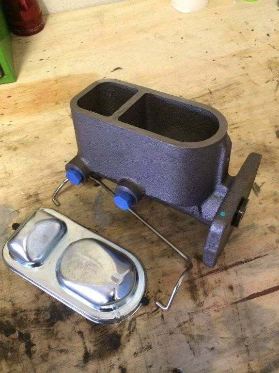

The UPS guy dropped off my new MC. I'm going to bench bleed it tomorrow and install on Saturday morning.
Front (small) reservoir goes to discs?
Rear (large) reservoir goes to drums?
The front port is larger than the rear. Not sure if my current setup is threaded the same (probably not). Guess I'll have to sort that out before I get started.
Wish me luck.
Wish me luck.
The large reservoir is for the front brakes, small one for the rear.
Kevin
Wish me luck.
I ran into this on my truck, I had to cut the ends off the lines and swap the threaded fittings and put the double flare back on them.
