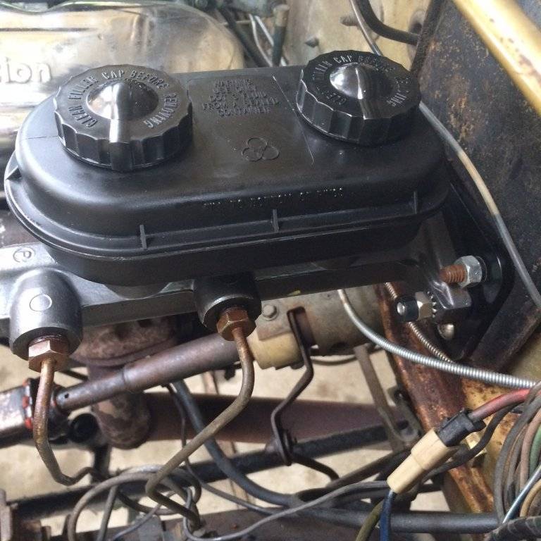

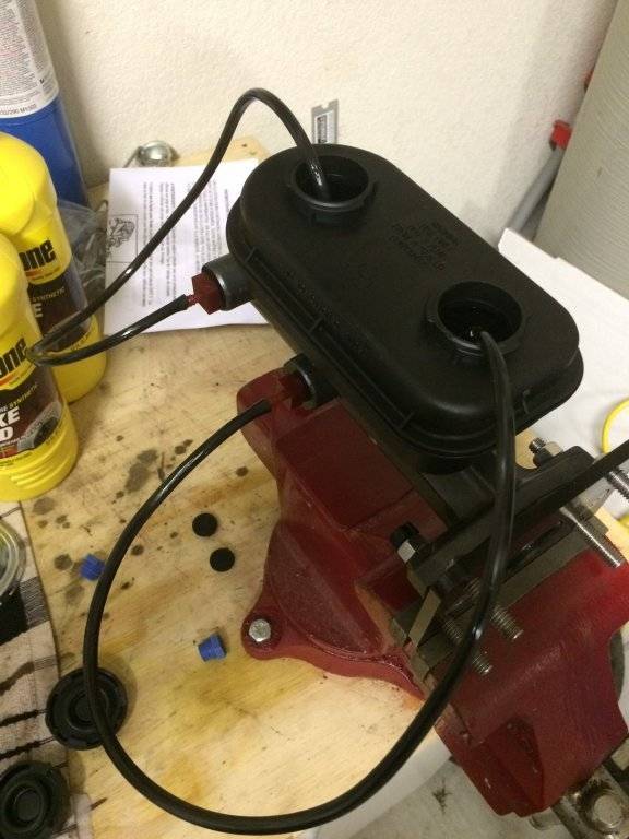

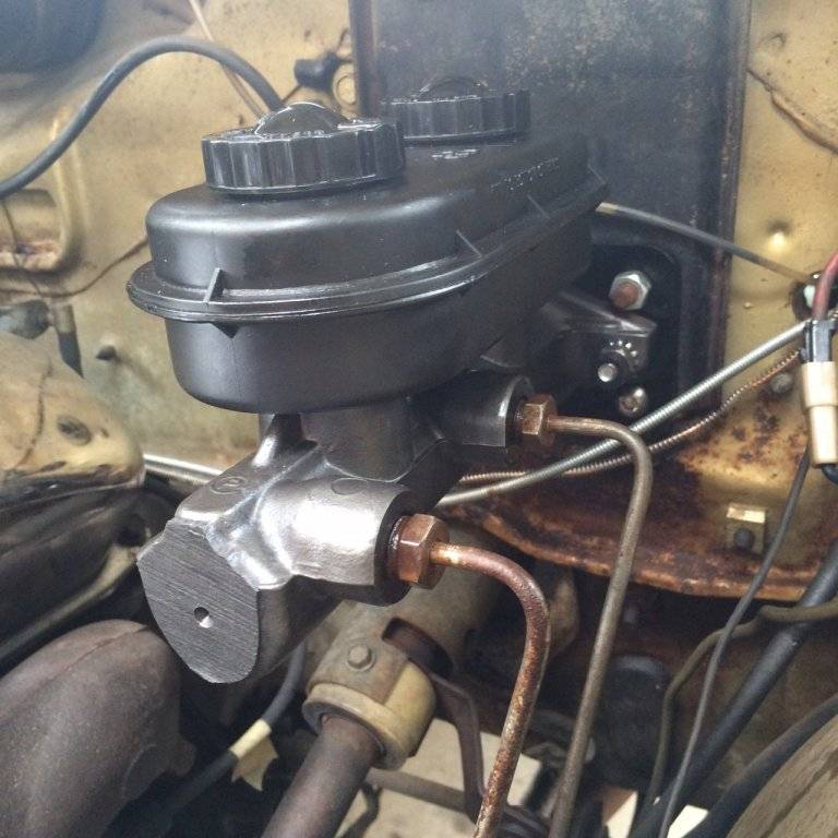

The new MC from Dr. Diff came in on Saturday and I bench bled it and installed this morning. Installation went fine and it bolted up nicely. I bled the brakes at all 4 tires but didn't realize I had the e-brake on. So I'll do that again tomorrow and give it a test drive.
The wife just let me know the brake lights were on. Looks like the brake pedal doesn't quite sit where it used to and the pedal doesn't engage the switch any more. Need to figure that out next.
Update:
Re-bled the brakes today and topped off the MC and took it for a test drive. What a difference. I get a nice, light pedal travel, and can bring the car to a stop quicker. I didn't try to lock up the brakes or anything, but did a series of quick stops and long slow downs. I'm happy.
I did find the brake light switch and bracket that mounts it. There's a bolt up under there and looks like it will allow me to adjust it down/up, but I think I'll need a 3rd elbow to get at it. I have a feeling that the bracket the new MC is mounted on dropped the brake pedal down an 1/16 of an inch causing the gap.
That'll do it. That bracket appears to be about 3/16 thick so it will space the MC out from the firewall and lower the brake pedal.
You could buy an adjustable push rod to raise the pedal back up or adjust the brake light switch down to hit the pedal in its new location.
