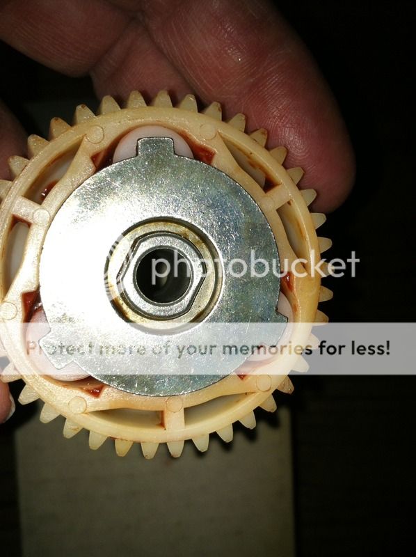

Well I owe Mr C a big thank you today. Rebuilt my D/S power window motor using the steel nut system and it worked perfectly. The window motor is humming along nicely and for the first time since I've owned it the driver's window isn't held up by wood wedges!! Love this forum! Next up brake booster then selector shaft seal. Road worthy in time for Critters unveiling? MB......
Thanks to all who have contributed to this thread. I finished rebuilding my first power window motor with help from this thread. I purchased a ten foot length of Acetal, equivalent of delrin, 1/2 inch or 12.7 mm, lathed down to 12mm and cut to 10.5mm long. Couple spoons of Lucas red and tacky and she is working better than ever. Checked the carbon brushes they were good. Love the simplicity of these old cars. Also used the drill hole technique. Hole was present in geared side, matched up with other side
Have to say of all the things i have learned from this forum this was the most interesting and cheapest fix so far! Thanks FCBO!

Have to say of all the things i have learned from this forum this was the most interesting and cheapest fix so far! Thanks FCBO![/QUOTE. I second that, very simple, yet incredibly satisfying results, Just remember those important warnings, that spring does not mess around.
Damn it! Both of the front windows don't work correctly on the NYB. The front left definitely has the puck problem and the right front will probably work with a smack with a hammer. I did the steel nut repair on both rear windows and they work great. I have one day off until Carlisle and I have to replace the idler arm, do an oil change and other maintenance to get ready for the show. I'll have to wait until after Carlisle to fix the windows. Thank God the A/C works. Those dang door panels can't take much more on and off episodes....I'll wait until fall and bulletproof the repairs on the front windows once and for all.
