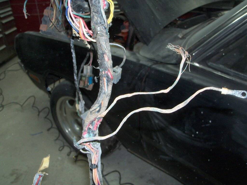

Not uncommon to start with a glob like this...
