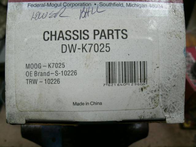

Are all of them made in China? My future son in law works at Advanced and he says its hit or miss, some are American made and others are made in China. Are all your Moog parts made in China or some of them?
Same as what your future SIL said. All the parts were a mixed bag of made in USA and Chinese. I went with the name figuring...
Well, you know how it is.
< Sent from my tablet >
Yeah, I was hoping you had better luck. I gotta buy two cars worth and I am not using China parts
I bought 2 receiver driers for my NYB recently from AAP. Both were 4 Seasons label.......one made in Canada and the other made in China.
