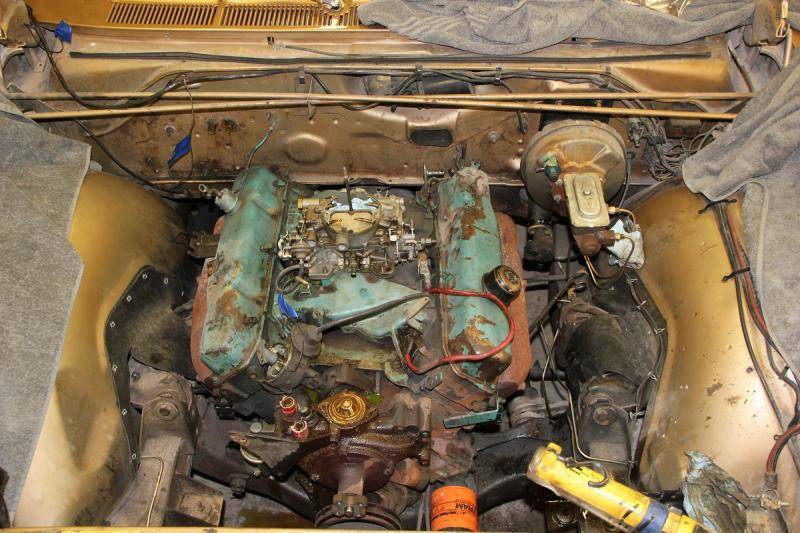

I had a good day working on the engine bay. The only thing that gave me any problems was removing the steering box from the pitman arm. I was working on both ends of the pitman arm and finally got it removed from the tie rod. I am going to have it rebuilt at Steer and Gear, boy was it oily.
I was amazed at how easy the exhaust unbolted from the exhaust manifold. I sprayed it with Liquid wrench late morning and removed them after lunch. I used 3/8 ratchet to brake it loose and after 1 rotation I could spin it off the rusted bolt with my fingers.
Everything in the engine bay is basically disconnected and the radiator removed. I am going to have my local Mopar buddy come a week from Monday to help me pull the engine and transmission.:eek:s_dancing2:
Looking good, Mike. If you are planning to restore the bay, I would recommend removing the grill and core support to easily remove the assembled motor and trans. The stuff is going to be removed anyway to properly do the engine bay. I wouldn't reassemble until the motor and trans are back in. It just makes it sooooo much easier to slide in and out with the core support out of the way.
I just did this as some of you may remember. I was just going to do the heads, cam, timing set, and rear main seal and I was going to leave it in the car to do it. I did end up pulling the engine so I could clean up the compartment and do the rear main seal without laying on my back and I'm glad I did. Anyway, what I'm getting at is that you will know what you need to do once you start getting into it and for the most part any and all parts you may need in even the worst case scenario are available immediately from Summit or Jegs. My 136,000 mile 440 surprised the hell out of me when I opened it up to find it didn't even need a timing chain! It was all original and had never been apart. I could have pulled the valve covers, put new valve seals on it and called it a day.
Concur with this and I'm trying hard as hell to resist going into the short block for this very reason. My Conv has 82K on it am I'm reckoning i's fine. When I pulled the intake it looked like it only had a few thousand miles on it and when I turned it over I could hear the compression strokes as it sucked and pushed air.
I've had a set of 915 heads done and am seriously thinking of putting a MP 272 cam in but am resisting because its a slippery slope. Everything outside the short block will be replaced or refurbed and it will be repainted turquoise and put back in..
BTW getting a set of better later heads like 915 / 906 / 452 done with hardened seats minimal porting and performance multi-angle valve job and an electronic ignition if you don't have it already and a 750 eddy carb and you are probably at 400 crank HP anyway. If not a mild retro purple shaft cam and you are definitely there with a nice set of heads.
Forgot one thing you should also add a modern dual plan alum intake and you can still paint it and it will look still like an original engine. And before you change heads see what casting number you have.
If they are closed chamber the only thing you need to do is enlarge the ex valve to 1.74 and a little porting or just go with the stealth heads and get them checked out and install better locks. Can't recall older intakes sizes but if they aren't already 2.08s probably cheaper to get one of the heads I mentioned above
Thanks Scott, that is my plan. It want to repaint the silver and black areas around the grill and the only way I can do that also it to have it all removed. That makes it a no brainer.

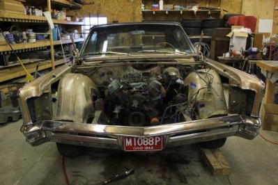

Don't forget to black out the core support. Take note of the factory spray pattern and don't mask it. It shouldn't be a clean line. I feee handed mine with a spray can.
Thanks for the reminder, I remember reading the original thread where this topic was discussed. Did you just use a rattle can for the effect or did you use urethane and then coat everything with clear?
I roughed up the bc/cc on the core support with 150 or 200 grit then sprayed it with flat black, no top coat.
I have everything ready to pull the engine and transmission a week ahead of time. That means I can move on to removing the rest of the engine bay next weekend and start sort what gets painted what color. So far so good.
