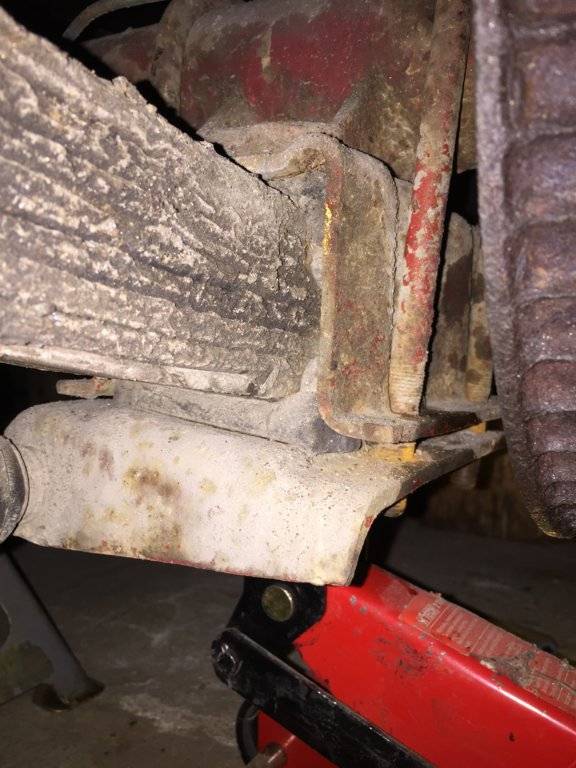

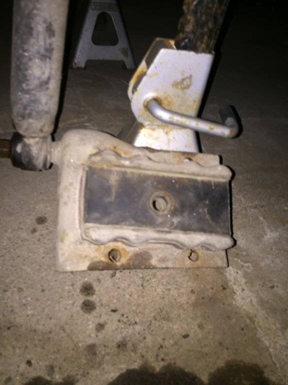

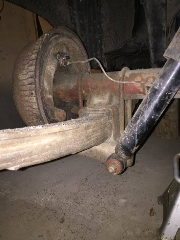

Most stock springs for this model Chrysler had only a maximum of 7 spring leaves with a big block engine. Looks like some one might have installed aftermarket "performance " springs which would account for the higher rear end ride. I count 8 leaves on this spring set. Probably not a good idea to take out any leaves, better to replace with the correct units.
Dave
the leaf springs are meant to work as a team. removing some will put undue stress on the remaining ones. i would start with replacement springs and the use lowering blocks if you want.

The springs aint saggin' bro, they are heavy as a...some heavy thing. Other leaf package is so tight that it wont even reach to the rear hanger. I have to use multiple diy techniques just get it back there. What about the 76 fury springs would they fit?
Sounds like yer rear suspension is a total mess. . . And I doubt any parts after 1973 will fit your car. I would look at finding and installing a complete differential assembly (with springs) and see how it all looks then.
Replacement stock springs are available at www.stengelbros.net among many others
