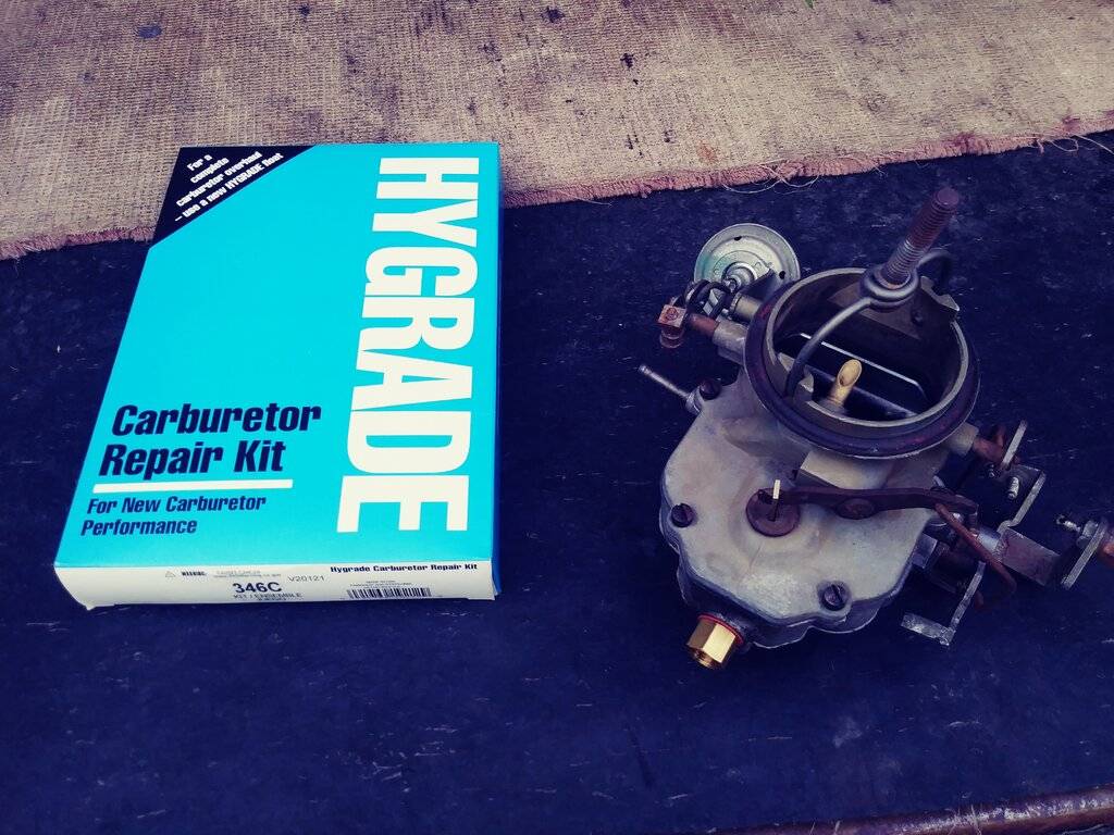

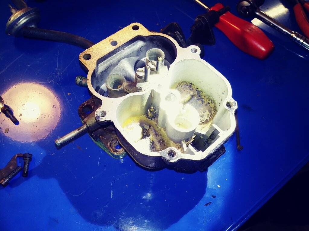

So I pulled the carb off andmy buddy James opened it up..
Yep...she will not run with the garbage inside the carb so time for a rebuild....
many thanks to James for helping me out .

That carb bowl is nasty
