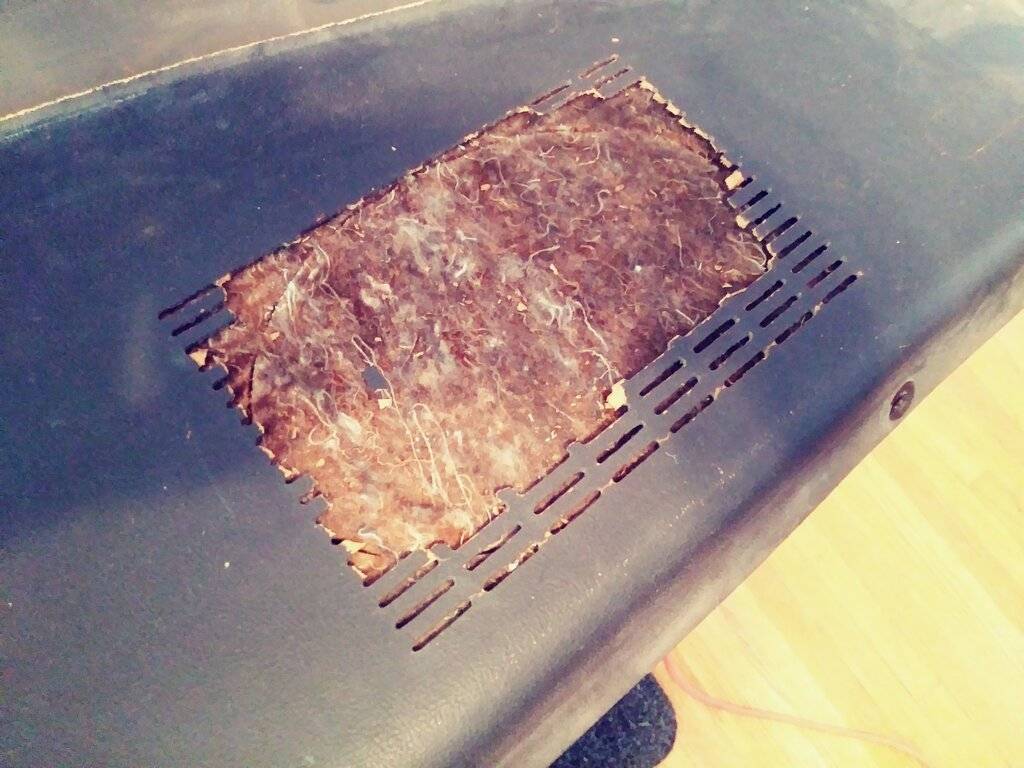

Yeah from the factory the insulation foam was NOT cut out for the rear defog and speaker (WTF) so in a way that saved our arse

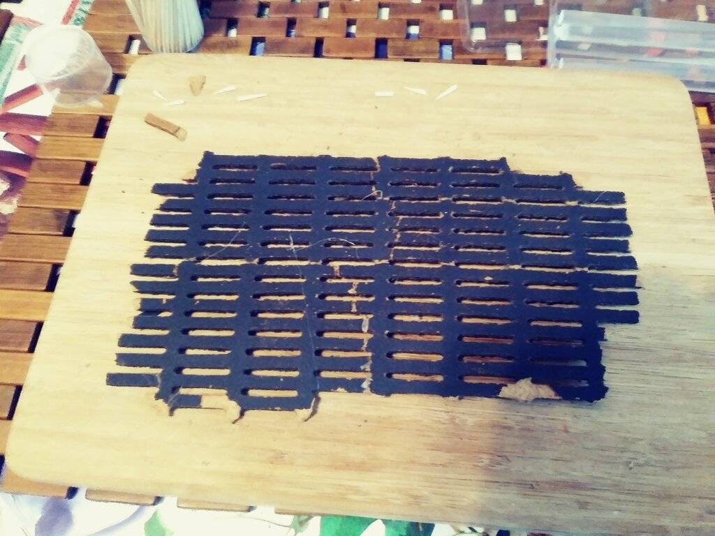

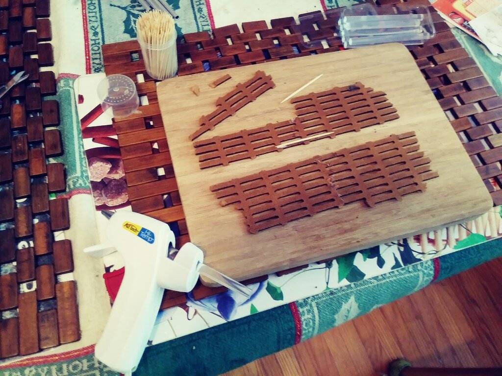

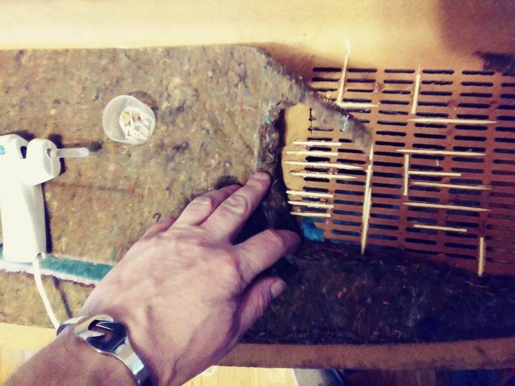

I started putting the pieces together at the table.

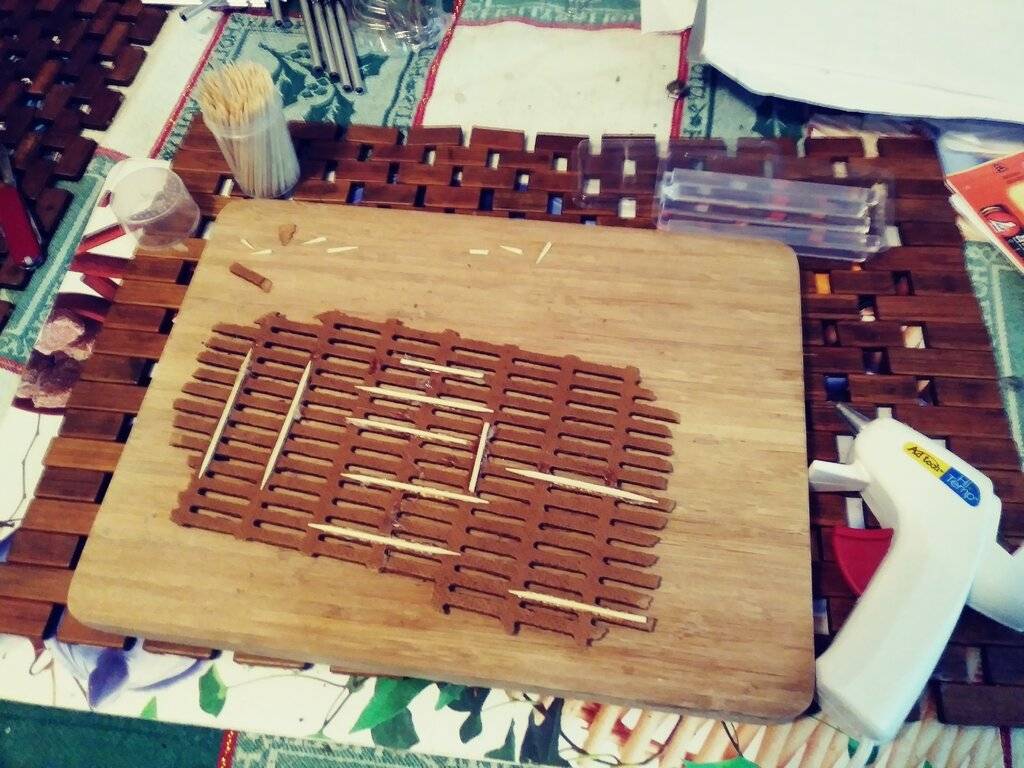

Using a hot glue gun and toothpicks for splints I made one large piece..
With the grille back as one piece,I put is back into the tray.
Again using the toothpicks to bridge it to the main tray.

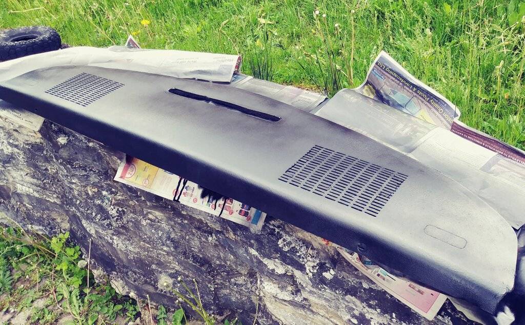

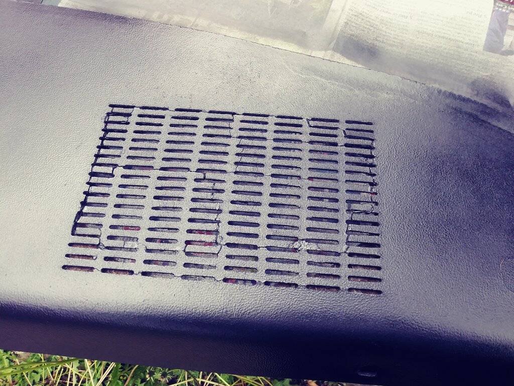

Tomorrow,a freah coat of flat black spray bomb will cover any cracks i could not cover with a Sharppie..
Not perfect but better than before...

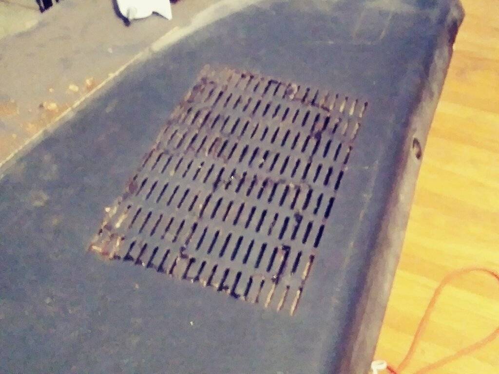

Before....
After....

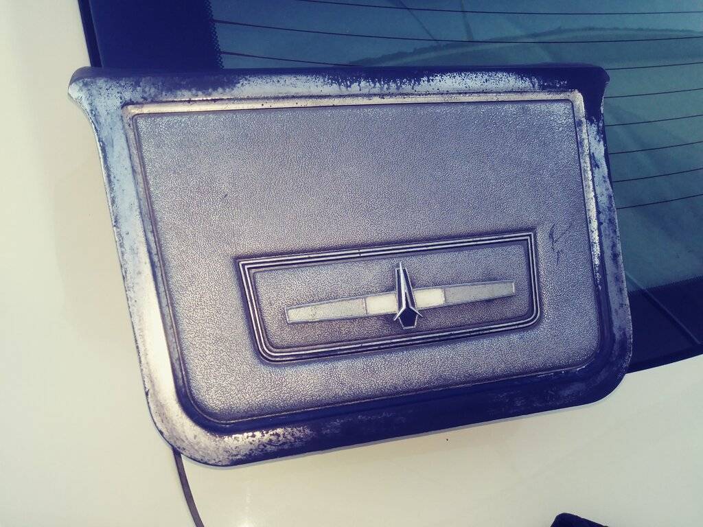

I know what should have been chrome is now black. But it works with the interior colors. I did not have enough Metal Foil to redo the chrome. My hobby shop is closed due to the pandemic.
