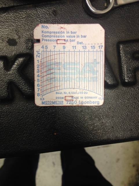

but i was able to run the engine again and get the oilpressure and compression.
Oilpressure looks fine.... the compression is attached ...

For anyone looking 6bar=87psi, 9bar=130psi... I am unfamiliar with the tool used for that printout, but I caution that if the readings were taken electronically (I suspect) they are not accurate numbers so much as a cylinder comparison. still not ideal, but you haven't run enough to have broken in anything as far as I can tell.
That brings up the question of camshaft break in. Careful you don't or haven't already gotten into trouble here... at startup the prelube wipes away... too many starts with out a full break in run could kill a cam.
Since you have run it again, pull the plugs to see which cylinders are the problem. That will narrow things down a little. If you find oil in all cylinders, either something went wrong installing the valve seals or the intake ... consider trying the stock intake and carb for break in and testing... All I can think of at the moment.
