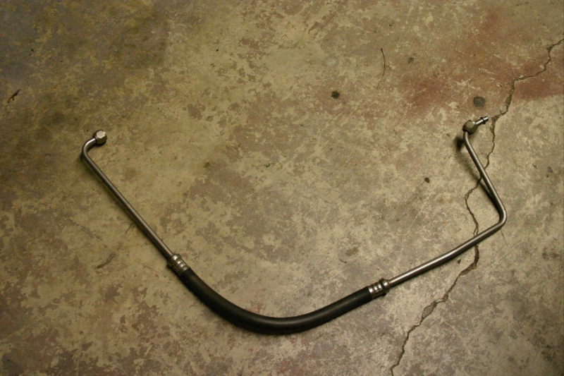

It is an effort but the transmission cooler lines can be installed after the engine is in, initially I had them on but my friend felt they were in the way.

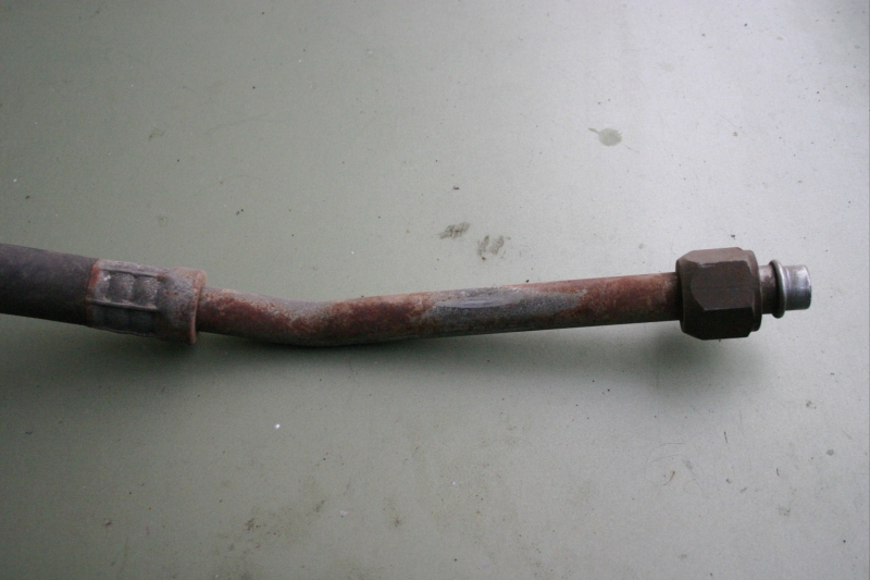

I wasn't happy with the fit of one of the cooler lines so over the weekend I pulled it out to make the adjustments.
This time I had the core support in but no radiator so it came right out. Made the adjustments and in it went, it does go through a 2" square opening under the engine mount but no real effort.

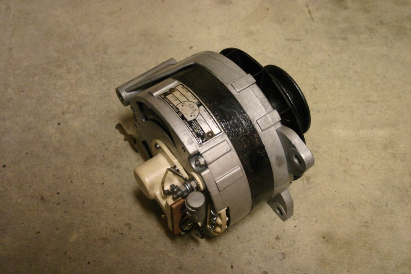

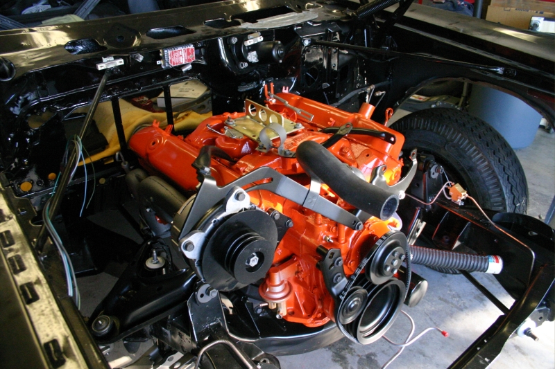

The original Leece Neville alternator was sent out for rebuild and came back looking almost like new. With the engine in the car some of the engine related parts could go on, the front pulleys and alternator were all I was able to do.

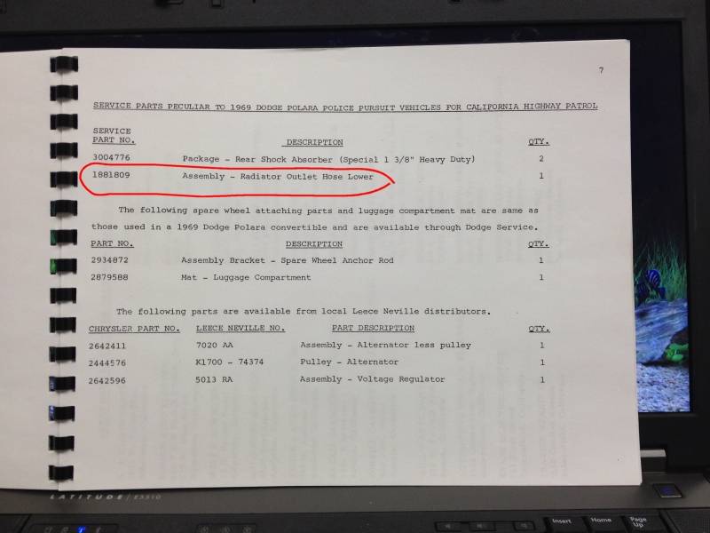

To Stan: Yes that is the Factory Correct lower radiator hose.
Now that the engine and transmission were in the car I could put the core support back on, the fenders are still loose but at least they are supported. Once the hood goes back on we’ll lock the fenders in place with the adjustments.
Alan
@Alan:
I want proof that it came out of the factory and went into service that way :D
The lower radiator hose is a MOPAR part and was installed by the factory on the CHP cars. The hose and rear shocks were two parts that were specified in the Dodge pamphlet outlining the differences in the CHP build.
Not seen in that picture are the screw down hose clamps as specified.

Not sure what you see, the old coolant bottle was a makeshift overflow bottle to replace the Cadillac one that the CHP had put on.
The fuel filter on the car was missing and the hard line mechanically pinched.
Other than dirt and weeds there was nothing else not factory under the hood of this car.
