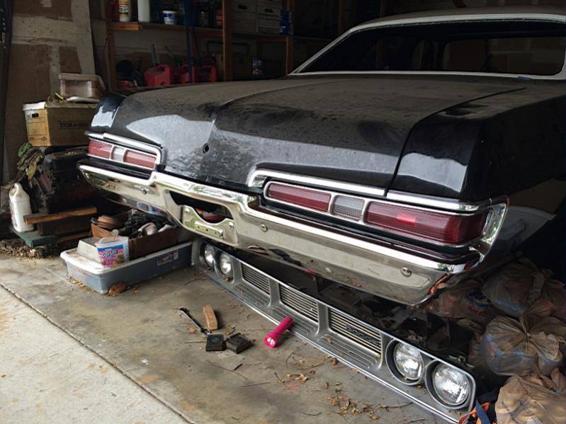

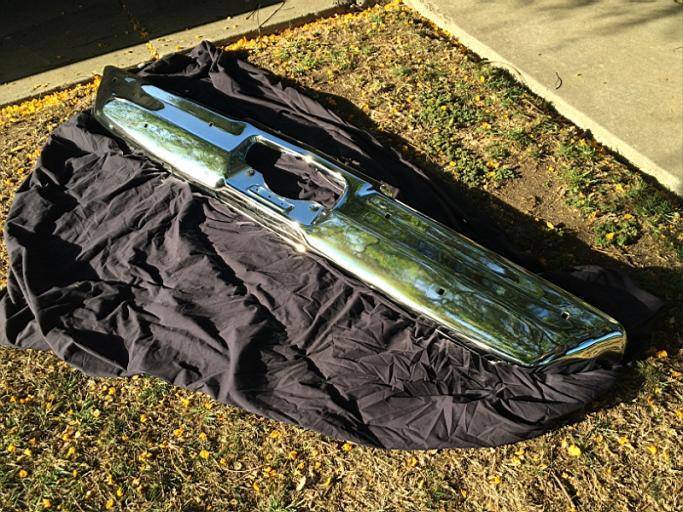

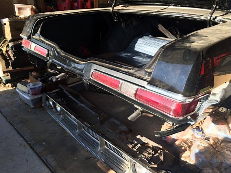

This weekend I was able to get some work done, I had a friend in town so I felt it was a good time to get the rear bumper on.
Before the bumper could go on I needed to touch up the blackout on the taillights, once that was done I put them on the car.
It took a little effort to get the end brackets with the spacer blocks to set right. They are in (those are spares on the floor).

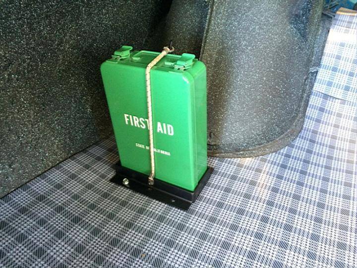

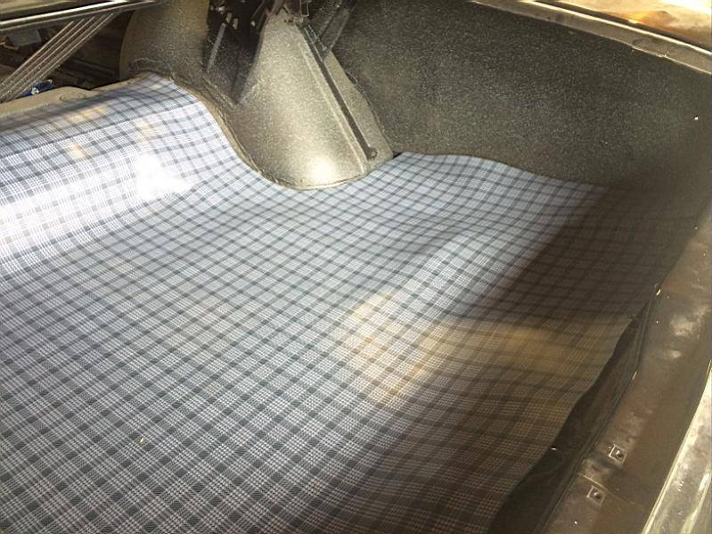

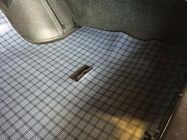

While we were working on the bumper FedEx dropped off the trunk mat

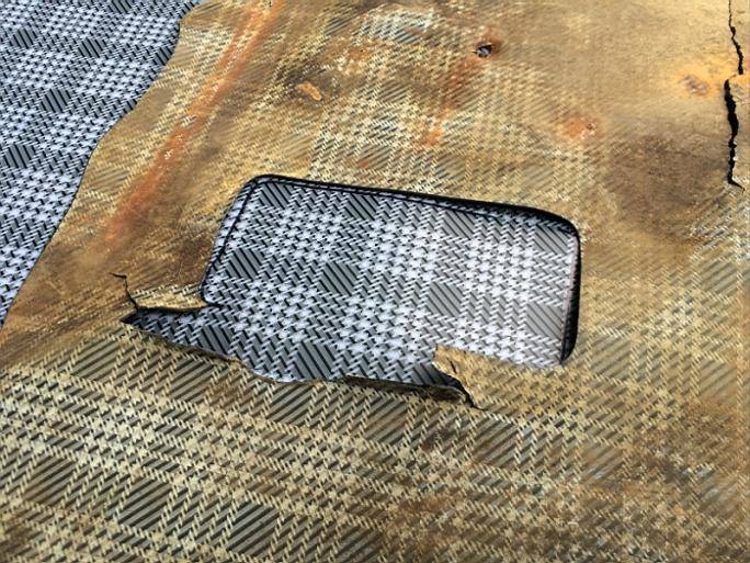

The material is almost as heavy as the original and it is uncut for the spare. The only real downside is that they needed to add material on the portion over the differential.
I got it from a seller on ebay not knowing it was a REM part. I compared it to the original intact one out of my other Polara and it was correct, there is about 3" more over the differential.
I needed to cut the hole for the spare tire hold-down (in my case it is like the convertible) the original was used as a template.
(I guess the bracket is a little off)
With that in I was able to install the first aid kit bracket.

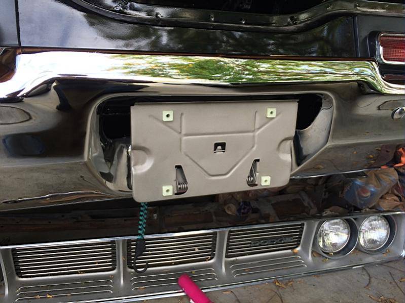

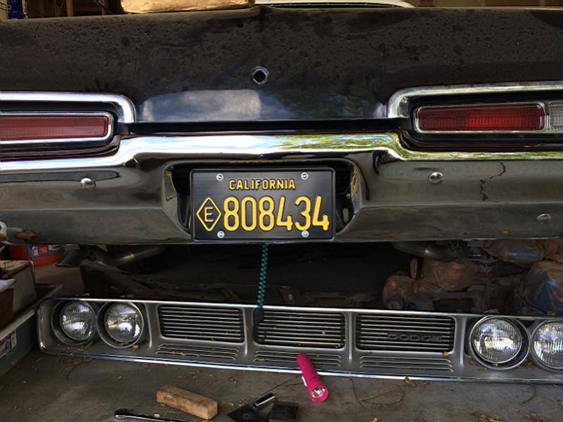

License plate bracket...
...and plate (temporary because I had to)
Not seen I also got the rear harness in.

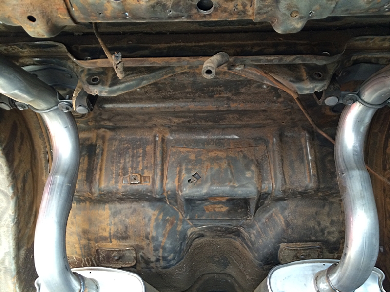

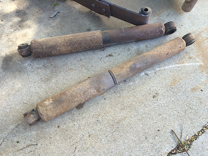

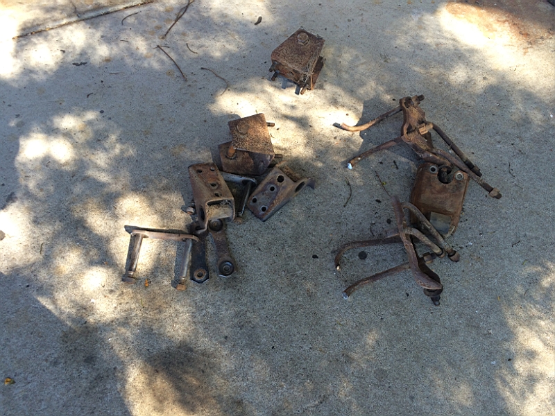

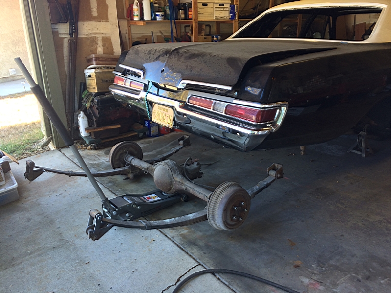

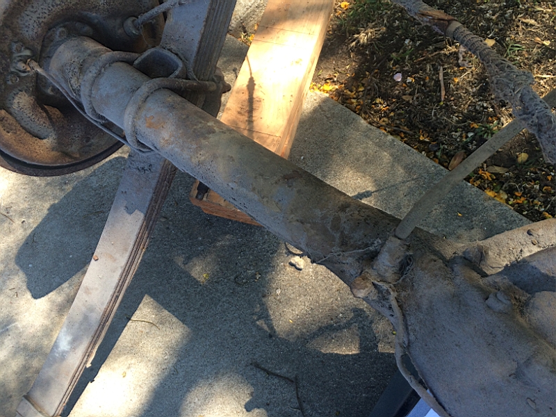

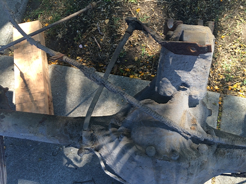

While I'm waiting on all that I chose to pull the rear end and start on it.
and after a couple hours cleaning...
The center will be done later when I can get it on a lift.
Alan

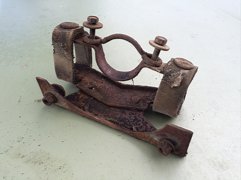

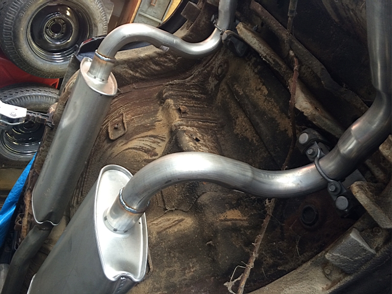

Now that's the way it is done. Hung correctly with appropriate hangers.
The devil is in the details.

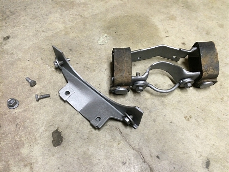

Where do you get them appropriate hangers at?
These are the factory ones that were on the car when I got it, it still had the original exhaust on it when I got it.
what's the gear ratio in the diff?
3.23 open
http://www.ebay.com/itm/380528671849?_trksid=p2055119.m1438.l2649&ssPageName=STRK%3AMEBIDX%3AIT
Whereas those have the same general look and may be functional replacements but are not identical.
