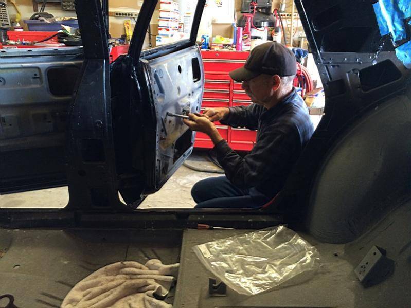

Over the weekend my friend Ron (who owns the fully restored 69 CHP Polara seen everywhere) came by to share his expertise in getting the doors back together.
With both of us working it still took 10 hours to get all 4 doors together. He started on the rear door with the runs and I sorted parts, I still had parts to two cars and not everything was labeled for which door location it belonged to. Mixed with sorting parts I was cleaning them, the glass have not been touched since the car was taken apart over 4 years ago.

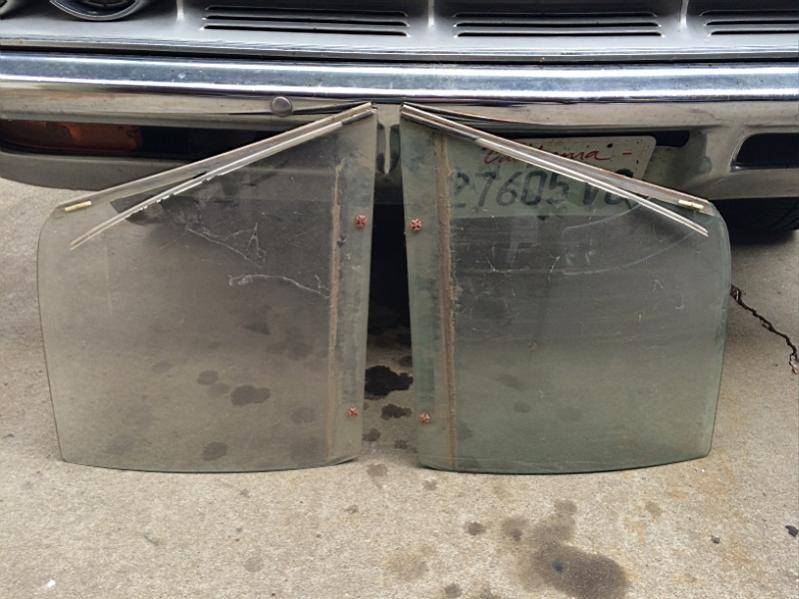

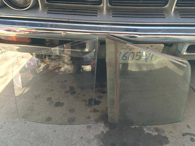

I was able to keep ahead of him through all 4 doors but bearly. On the fronts I was not happy with the quality of the chrome on the vent glass bracket, so I chose to remove them from my other Polara. Easier said than done, the vent window regulator needs to be detached from the bracket to get the bracket out. That point of attachment is swaged and probably done with the vent window assembly out of the car. Once I realized that they were swaged I came of with a way to remove the swage while in the car.
Cleaned up the assemby was installed into the door (a two person job). Even still I had to remove the other side and have it cleaned up before he needed it.
Everything went like clockwork till we got to the last door (drivers). We got the vent assembly with the door glass installed and pushed it up so we could get the regulator in. The problem is the window isn't square in the door, there is no adjustment for this like on a hardtop. We loosened everthing and tried to figure it out but it was getting late and we closed up for the day.

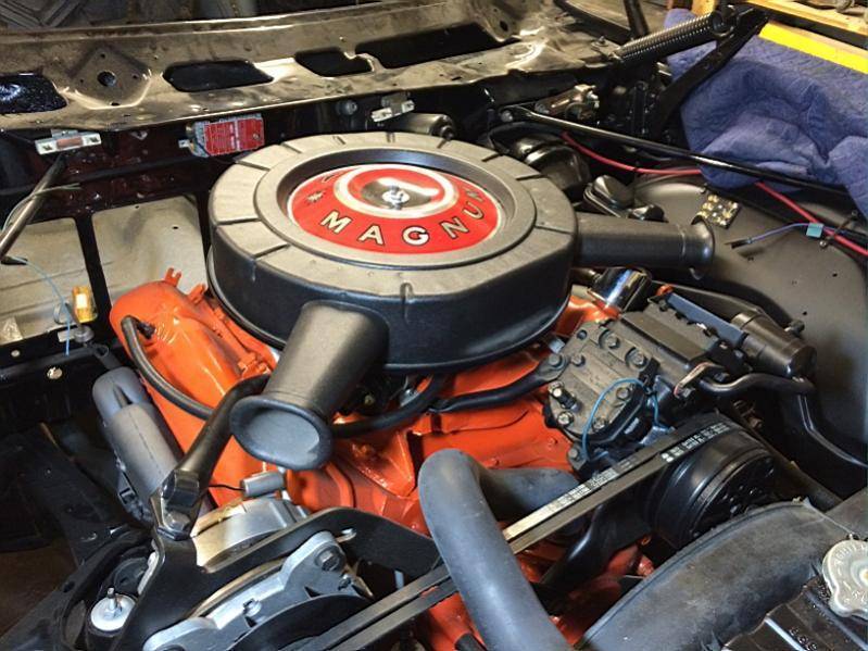

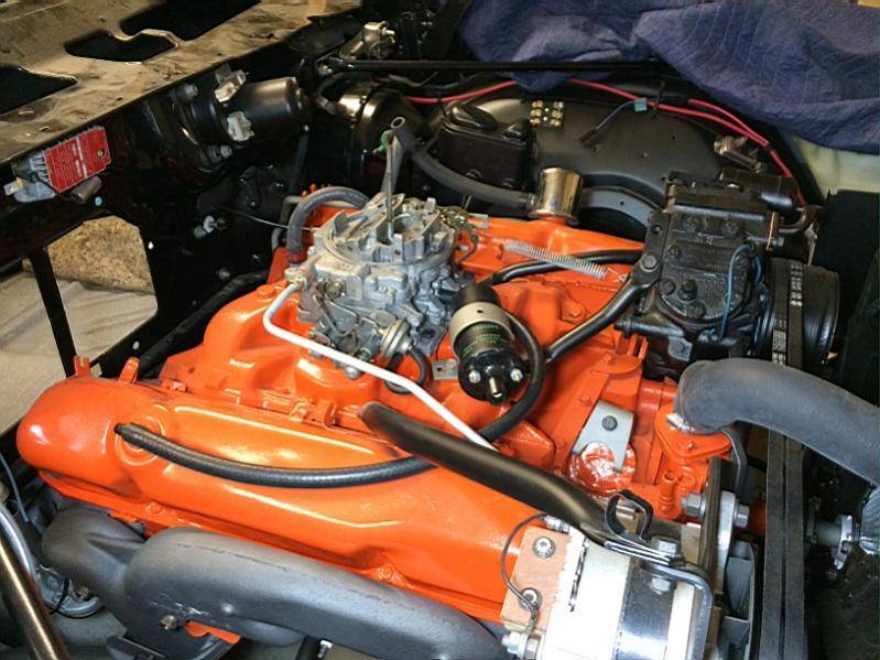

Recently a friend rebuilt my carburetor which opened up a bunch of stuff I could do.
I need to get a new kickdown spring but for now the original is on the car.
Original clamps were cleaned up and painted for the power brake booster and the breather cap.
The carb (as the rest of the engine) has the original hardware.
I still need to put the distributor in.
The hole in the pie tin was not centered so I took a step bit (uni-bit) and opened the hole up. The way it was the tin would jam up in the threads of the air cleaner stud.

amazing work. sometimes it's the details that take the longest. i can't imagine the amount of research you have done.
The oil breather was chrome from the factory? Looks a little bit lost as the only chrome piece in the engine bay.
Looking mighty fine there Alan. Look at that orange paint and those HP manifolds ! Aaarrff !
Yup, the original was on the car when I got it. I have a picture somewhere of a CHP car showing the chrome one.
The orange does look good in the black engine bay. I still think the orange is a little too orange and not more red. It should be Street Hemi Orange.
Alan
