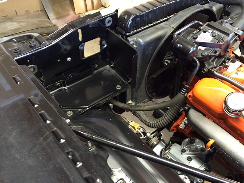

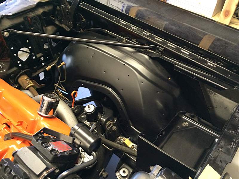

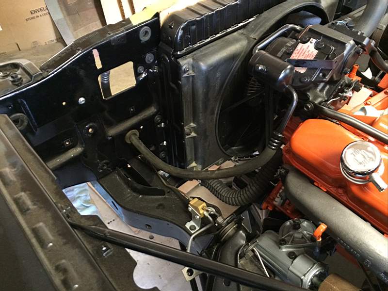

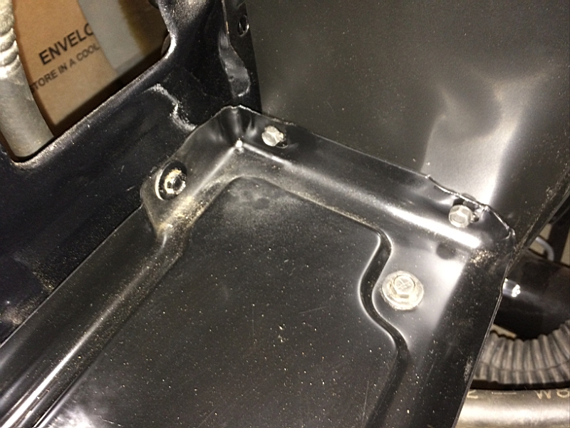

Over the weekend I put the driverside wheel liner in. Once you find the orientation that allows you to get it in it is pretty easy. One bolt at a time till you have them all started then lock them down. I went to move on to the battery tray and noticed I missed a couple bolts, the problem was I needed to put the clips in. I managed to get the clips in with the liner in place. The other problem was that a couple of the bolts that went into the frame were not even close to the hole, new holes were drilled and bolts put in. This may have been a result of my fixing a bent frame.
The battery tray and heat shield were put in but I didn’t like the way the heat shield fit. I didn’t see a better way to install it as the bolts hit the radiator the other way. Well in cleaning up more bolts were found also labeled heat shield and problem fixed.

Under the hood everything was black but what black? On my other Polara and the parts car, a green car and a red car I was able to determine what was painted Gloss Black with the body and what was underhood satin black. I have seen this done wrong on other cars that were done gloss black throughout.
It is hard to see in these pictures but the battery heat shield was satin black and was not on the car when painted, therefore none of the hardware would be painted. Likewise with the bolts in the bottom of the battery tray should not be painted (black) as they were put in after the body was painted.
We haven't even got to the hood latch support, a mixed bag there.

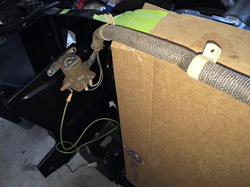

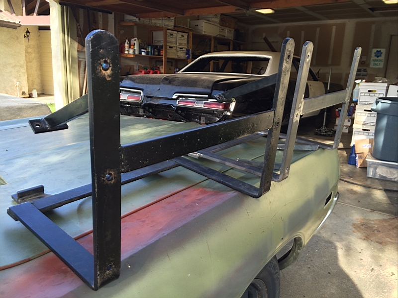

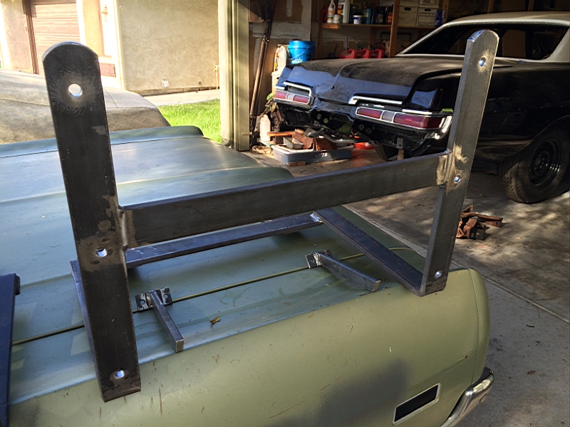

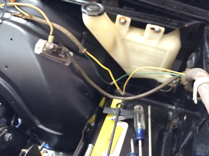

With the front of the car moving along and the bumpers having been sent out for chrome I felt it was time to have a push-bar made. My friend has the prototype assembly for the 69’s on his car and there was time between shows to get it off his car so it could be used as a sample, the copy was perfect. Along with the push-bar I borrowed a CHP wiring harness that we removed from a car, something that typically wasn’t left on the cars. I was able to document how the harness was built and have acquired most of the correct components to accurately recreate one to their specifications.
This was installed only to see the placement, all new tubing and wire will be used and relay.

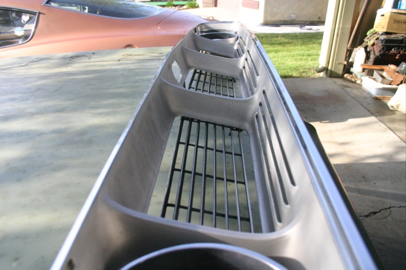

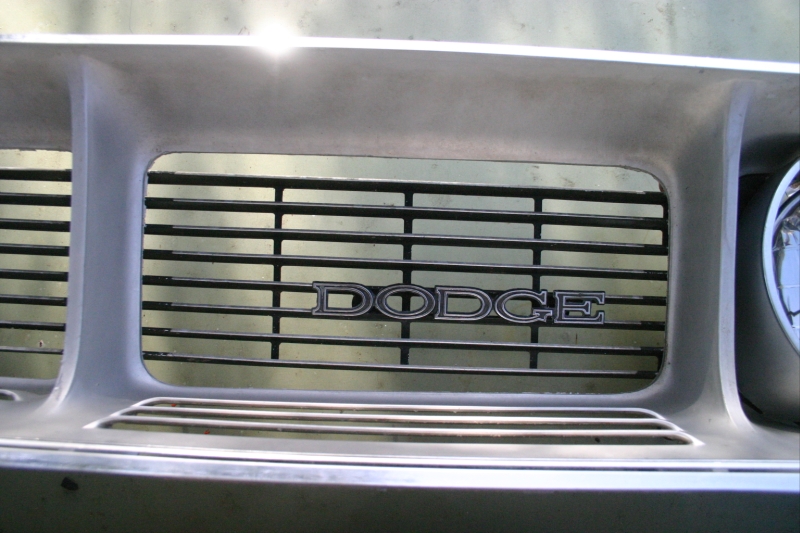

I now have a grill that will need little to no work, all the others (4) are either pitted or cracked.
