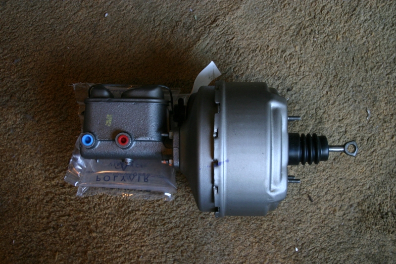

Well my brake parts came in today but the booster is not correct, the parts were purchased from RockAuto.
The website showed the correct booster that matched the one I have on the car but what I received was different.
It may be the correct unit in form, fit and function but not correct for my needs.
I hope they have the correct one, we'll see how they are to work with on issues like this.
Alan
Well RockAuto is not setup to go through stock and find a correct one.
My local NAPA ordered one, no deposit and is willing to send back if needed.
They said they will send mine in for rebuilding if needed.
Alan

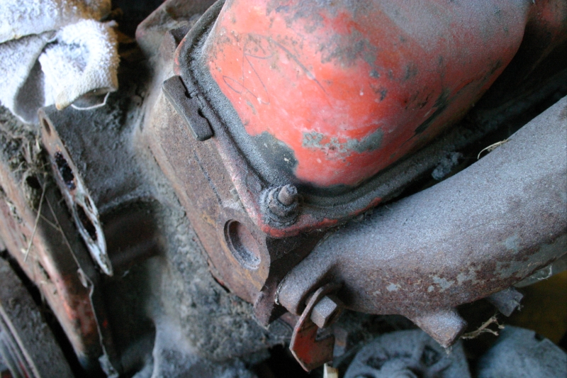

I'm currently cleaning hardware and brought me back to one of the valve cover bolts.
There were two studs (I can not recall where the second one was) but there is one on the front of the driver side.
I see no reason for this not to be factory but have not seen studs used for valve covers before?
Both have paint on them.
Alan
