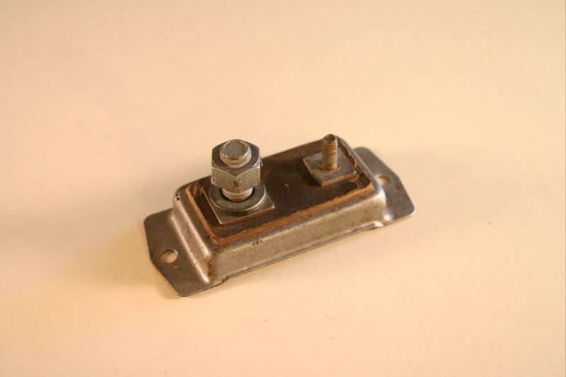

One thing I need is a junction/terminal block. This one is on loan from a friend and was pulled off of a CHP car.
Any information on this would be helpful. Manufacture, other industries that may have used them, source?
I just need more information to have a chance of tracking one down.
Thanks,
Alan
I'm very good at electrical archeology but I need everything printed on it.
Then again finding an electrical component today that was used 40+ years ago...
Posted via Topify on Android
If it was that easy I'd probably already have one, what you see is what you get.
It is about 3" overall in length.
I'm guess it may have millitary origins/applications, possibly made by Cole Hersee or Leece Neville.
There are no identifiers on this part, stampings, printed or otherwise.
Thanks,
Alan
That thing is as generic and universal as they come.
Can't be military if there's no identifiers.
Looks like something the garage bought locally when they were wiring up something. What was that juction block used in the wiring of?
They installed these on every car for most of the 60's (recycled from one year to the next).
It was mounted on the driverside wheel liner. They would cut the battery cable about 15" back and put lugs on each end, these would go on the large post where they would then run a 4 gauge cable up to the passengerside core support where there was a starter solenoid that activated the siren (which is a starter motor).
This particular piece was a salvage and was sandblasted.
Alan

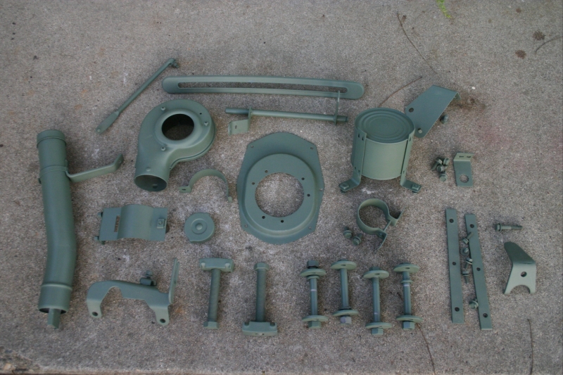

I have also been cleaning up many of the other small parts, most of these will receive rattle can finishes.
Alan

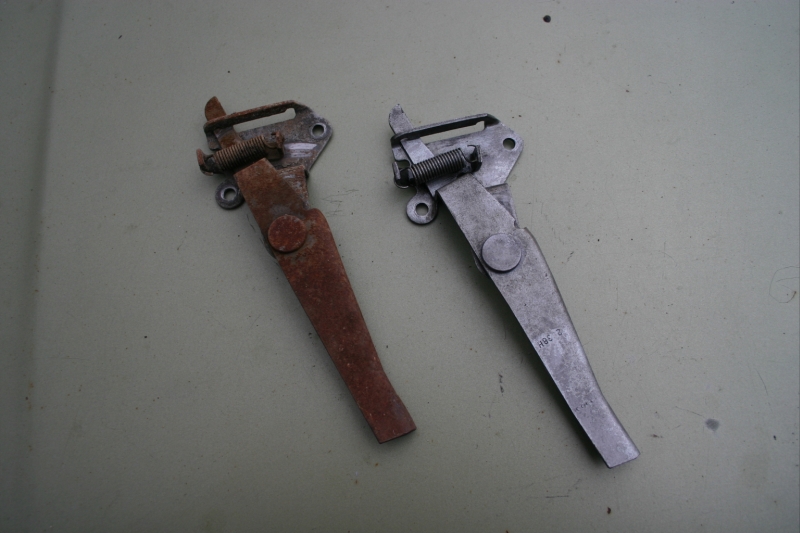

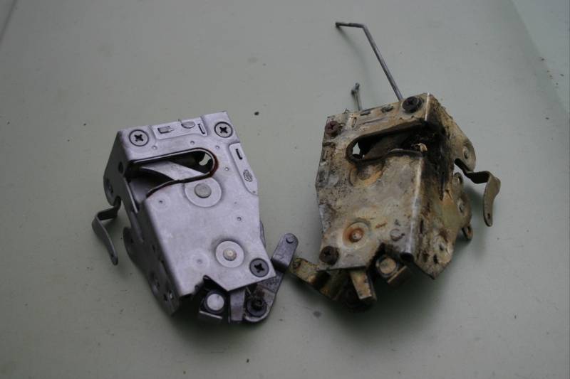

There was some recent talk here about using vinegar to clean parts and I thought I'd give it a try. The door latch mechanisms were something that badly needed cleaning and I didn't thing sandblasting was a good idea. at first I dropped the mechanisms in a bucket with the low grade stuff from the market and after a day I went over the parts with a wire brush and put them back for another day. The next day I pulled the parts and they were tacky as I think all the grease from in the mechanisms broke down and coated the parts. So some fresh vinegar was put in the bucket and another day.
This time the parts were clean, a little scrubbing and I set them aside to dry after rinsing in a bucket with baking soda water in it. With the parts basically dry I dunked them in WD-40 and placed them on a sheet of cardboard to dry. The next day I wiped them down and put them aside.
I still had some parts to do, some more door latch mechanisms but this time I let them sit over night in carb cleaner first. Still two days in one bucket wire brushing after each day moving them to a second cleaner bucket for another two days. The big difference was not going through the vinegar as quickly and less scrubbing each time.

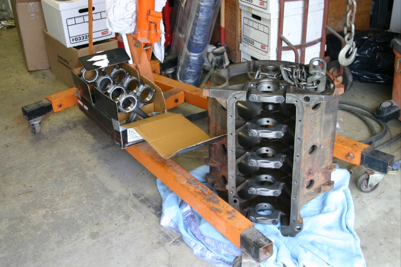

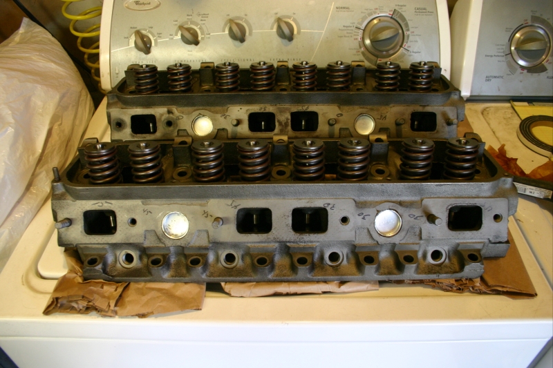

Next up and more importantly is I got the engine block and heads back from the machine shop. I am really happy with the workmanship and eager to start the assembly. I have never assembled an engine so YouTube here I come, no wait I am not that stupid, I have a good friend that has agreed to help.
One good thing about getting the engine is that it is paid for and now I can focus on the next big expenses like suspension and the transmission.

Nice work. I started using vinegar as well, since the evapo rust was getting expensive. I found that a first soak in purple cleaner does a de-greasing and then a three day soak in vinegar takes care of the rest. I found the 6% concentrate in Wal Mart. It's marked as "cleaning" vinegar, but it's a dollar more than the 5% grade.
