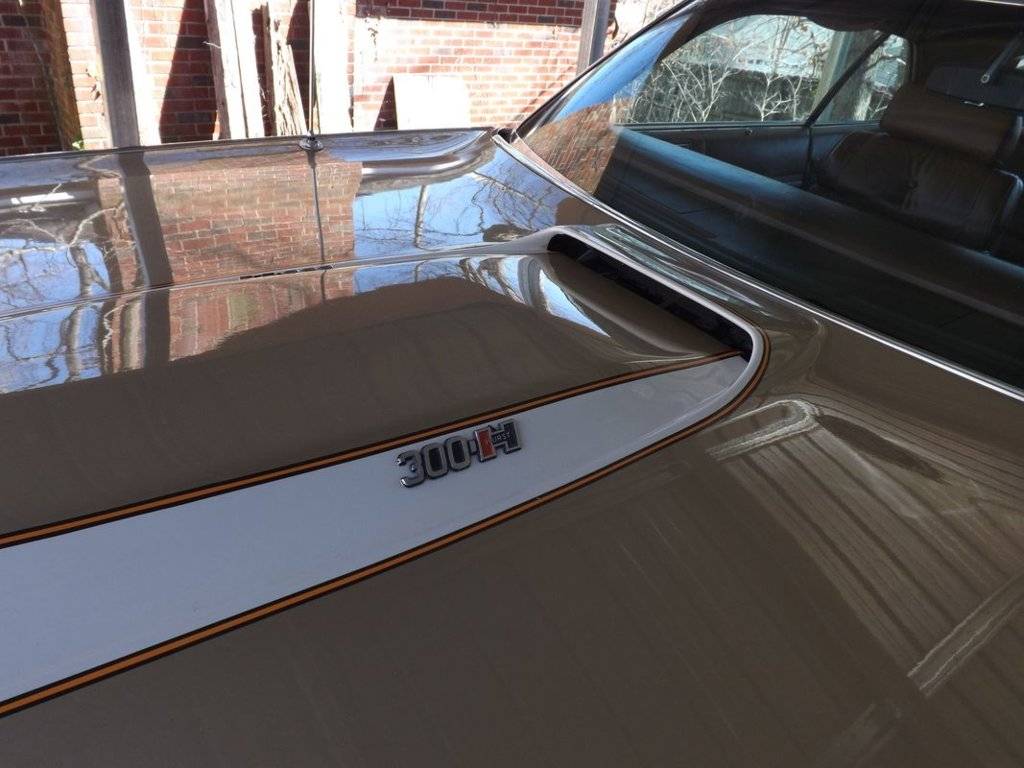

Can you give us the paint code you will be using ? ( i suppose it will be an exact match of original )
Thanks everyone. Yes I am using the original paint code. I am trying to determine the gold color yet as I have heard it is a cadillac color.
Sauterne Metallic: 1970 GM
DULUX: 5144DH
LUCITE: 5145L
I'm pretty sure this is what you are after. It's not a high gloss finish.
The 300/Hurst promotional cars were painted in "Hurst Gold" which is obviously different from the Sauterne Gold "mist".

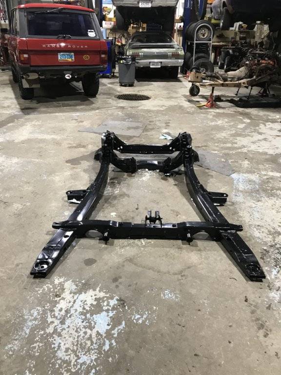

Received my sub frame and other parts back from the powder coater. Next step to start bolting new suspension on and drop engine and transmission in.
Very nice! By the way, I saw this car on the weekend at a friends place. Nice eye candy. It looked very original.

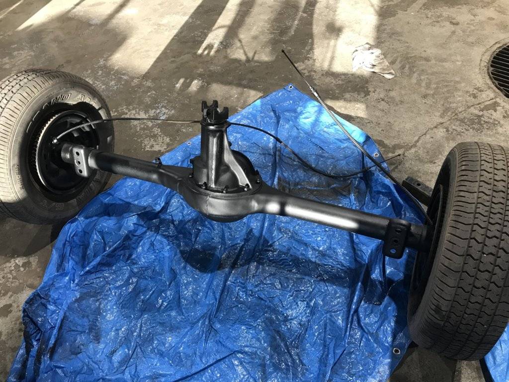

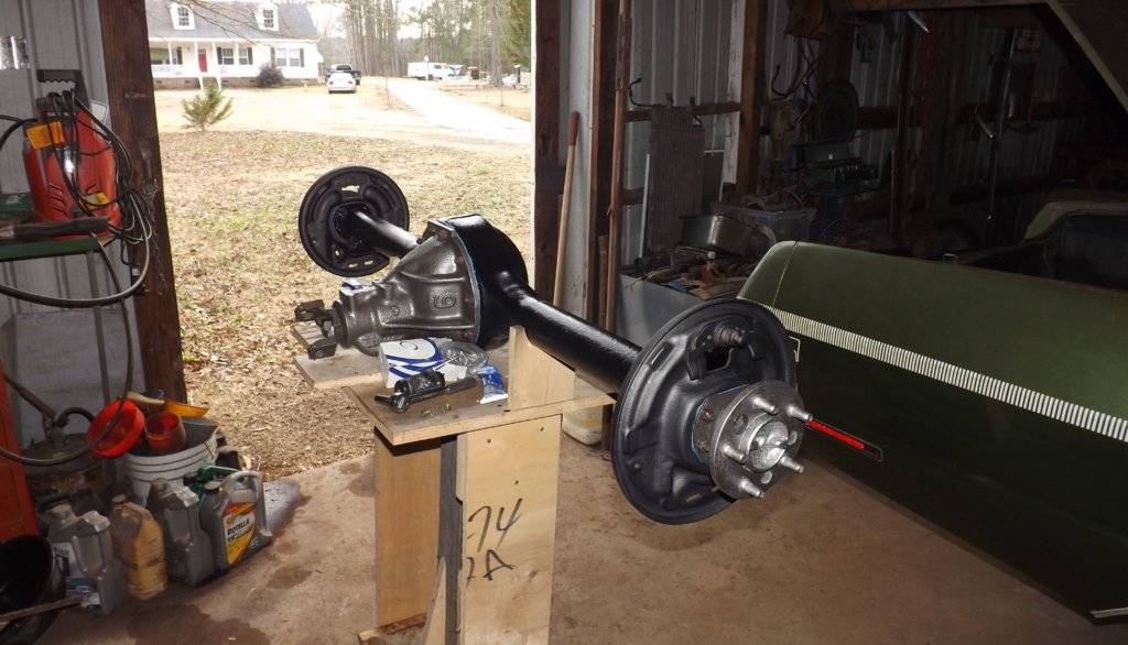

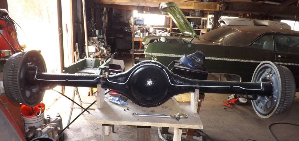

Cleaned up my rear ended housing and painted it with Eastwood’s rust encapsulater even though I didn’t likely need too. Will be shooting it with ceramic coat chassis black paint this week and then reapply the old factory stamps on it when fully cured. Have to research one mark I couldn’t make out yet.
View attachment 173296 Cleaned up my rear ended housing and painted it with Eastwood’s rust encapsulater even though I didn’t likely need too. Will be shooting it with ceramic coat chassis black paint this week and then reapply the old factory stamps on it when fully cured. Have to research one mark I couldn’t make out yet.
Will you be painting the hogshead in a cast iron metal paint color? The housings were painted a semi gloss black while the center stayed natural metal. The brake backing plates were zinc phosphate color too.
Yes I am going to try and find a color to shoot that looks close.
