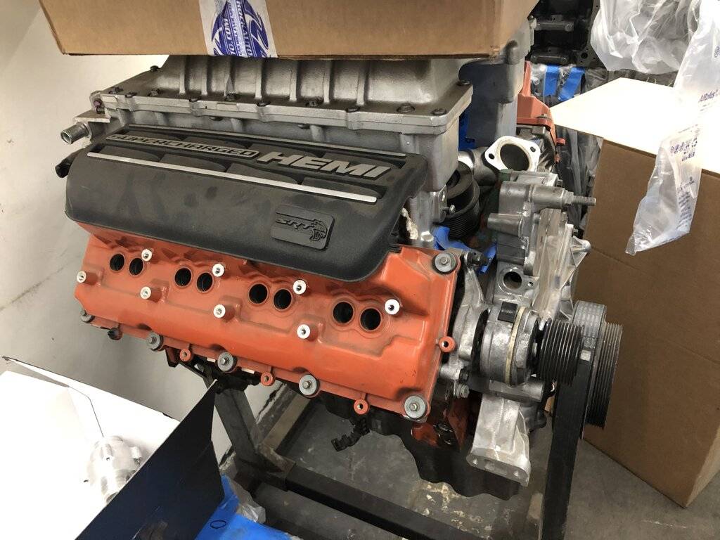

My 70 Fury 2 with a little bit better HP
Do you have any photos of the oil pan after modding? That pan fits pretty well in my Coronet but I would think a big chunk needs to come out to fit a C.
Holley is making this a lot easier with all the parts they make, for trucks and B's you just need a checkbook now.
Checkbook to pay for the magic plastic use?
It IS nice to see a major vendor sense the possible magnitude of ANY Chrysler-related market and seek to satisfy that need for non-LS stuff.
No I don’t , i will take one the next time when I have the Fury on the lift , you have to relocate the oil drain plug to the passenger side and have to make room for the idler arm.
I used the Holley b body swap mounts they move the engine 3/4 forward what is needed, if you use Schumacher mounts you have to cut the oil pan big time.
Interesting, I bought the mancini mounts for my Coronet, I wonder how much different the holley ones are... 3/4" I suppose :lol:
Lol that’s right 3/4 makes the difference, I already plan my next swap a little bit more extreme this time.
