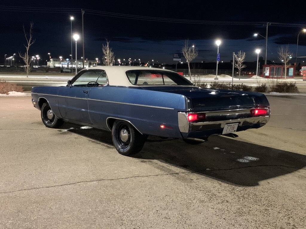

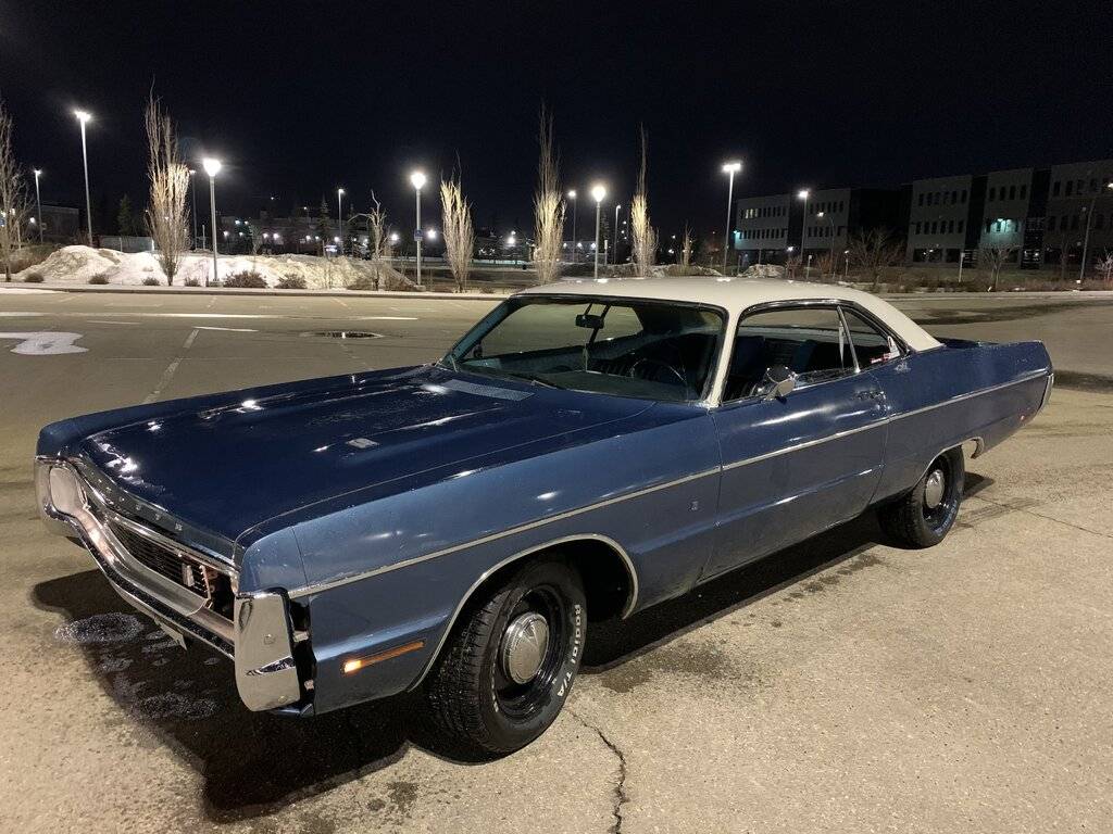

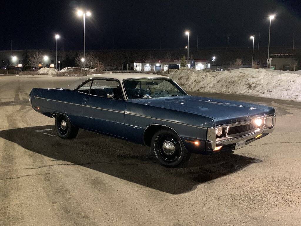

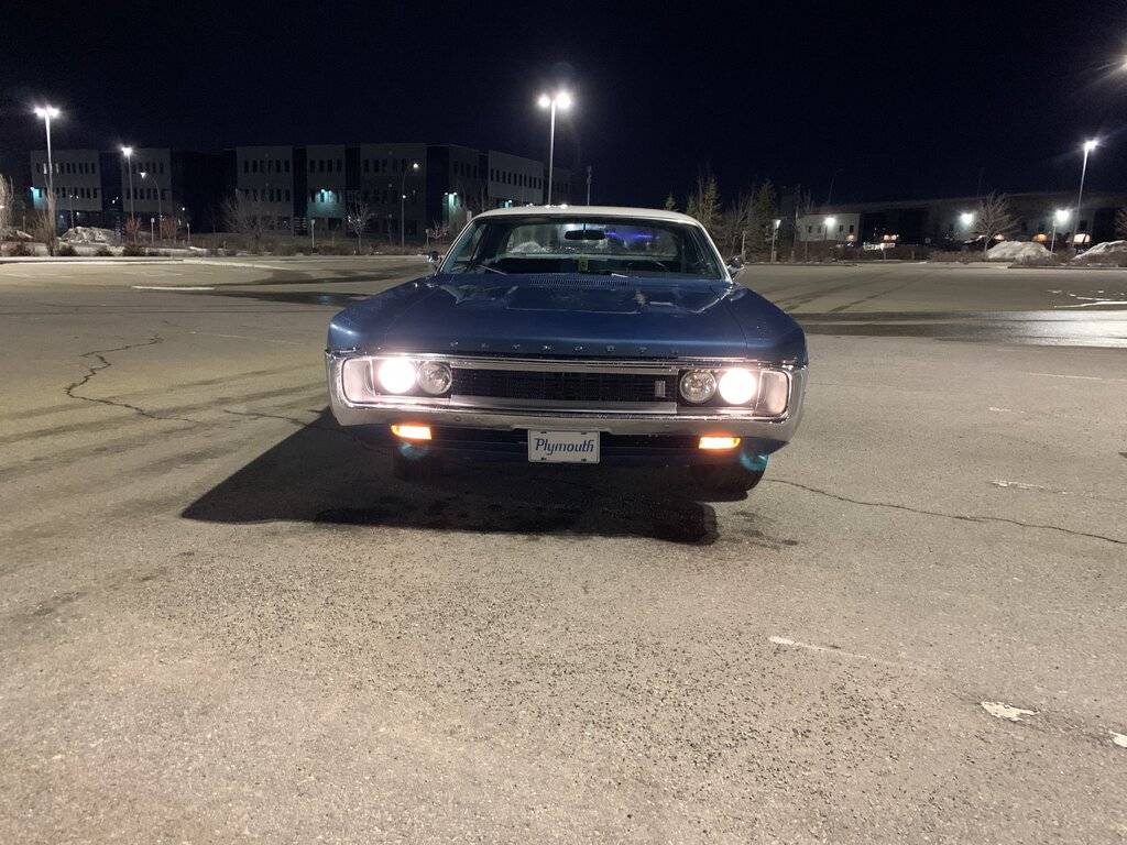

My 70 Fury 2 with a little bit better HP
Nice job, awesome car! I didn't know Holley made tank's, did that require modified brackets or anything? The six speed swap is going to be a game changer, I think that's a great idea. I'm sure you already know there is a tremec distributor in Calgary? I just found that out not too long ago, I have their name somewhere.
Yes Holley makes a tank with in-build fuel pump, is for B Bodys they bolt right in and fit perfectly on a C Body car.
Yes I know there is a company in Cow town that sell tremec’s.
I’m hoping that a trans from a challenger pops up for a few thousand bucks what I can use.
A B body tank, I didn't even think of that. And I hear you on the cost, I want one too, but that is a large amount to hand over. I've been saving my nickel's!

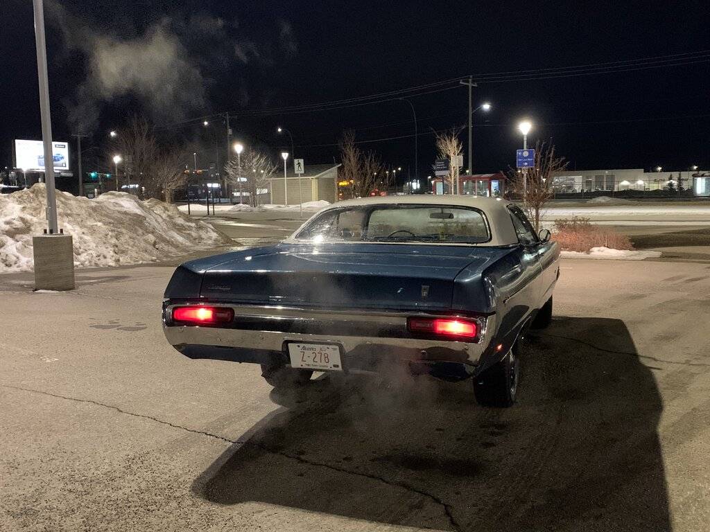

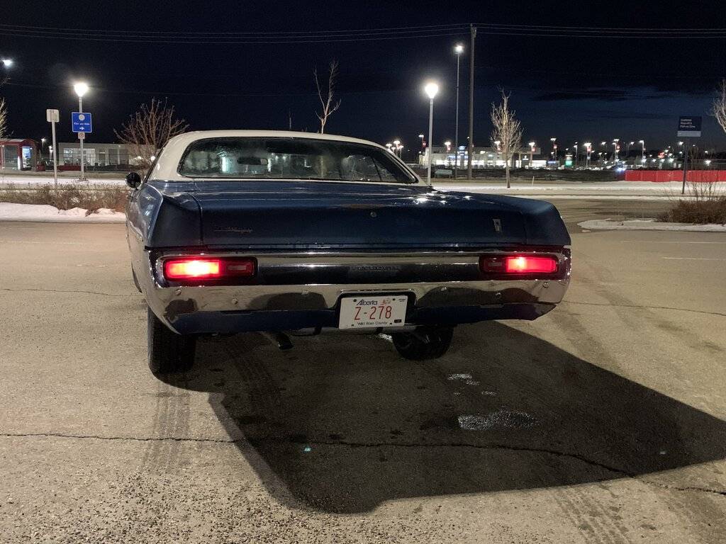

Little bit more test driving and cleaning up the Fury
You put the 392 or 6.4 truck cam in it? While it's idling high it's not as lumpy as I thought it'd be. I've got a 392 cam for the 5.7 for my Coronet.
Is a 6.4 Challenger cam, I have to play a little bit more with my ICA valve to get my idle down it sits at 1050rpm at the moment and I like to get it down to 750rpm

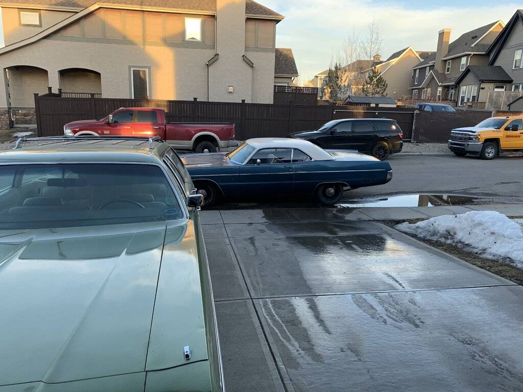

The weather was perfect to drive the Fury all day today after my buddy fixed a little oil leak on the car today.
Yes that’s right, 727 and 2:76 gears
