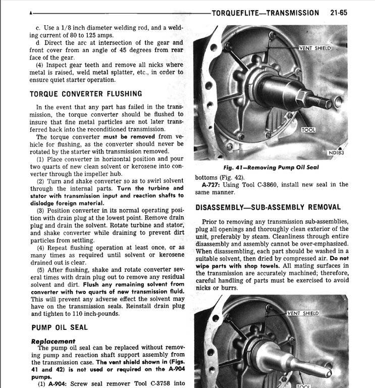

Reading the factory service manual made me wonder whether, having "flushed" any remaining solvent, the 2 quarts of fluid (and solvent remains) should be removed and replaced with fresh fluid?
