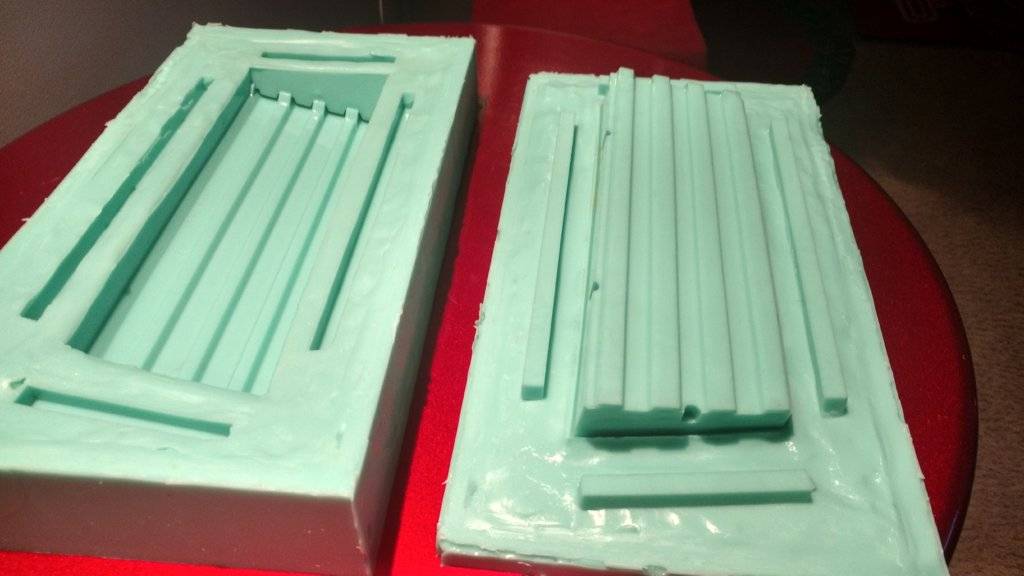

My second mold complete, this stuff is really great to work with. This is a massive mold, it comes in at over 12 lbs. Very happy with the mold making process.
Keep up the great work ! I’ve never seen anything like this before. It’s just amazing. You have a great thing going on here and I will be following you with great interest.

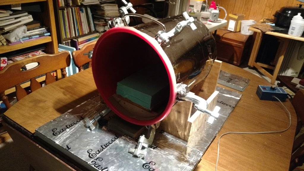

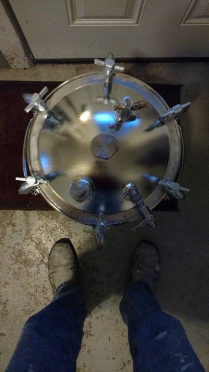

Holy cow this pressure pot is massive and beefy. I couldn't tell from the picture if it was truly 10 gallons I was afraid it was miss marked and it was a 5 gallon which may not be big enough. I definitely got a great deal on this, stainless steel too.
BTW, The restoration garage car show just showed a bit of this process on their show. They were having similar issues and built a tank out of a couple propane cylinders. Keep up the work. It's gonna be rewarding to make these again.

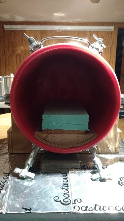

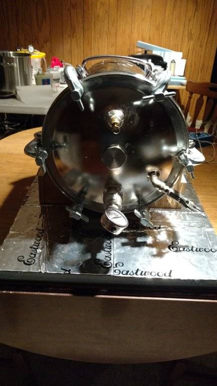

After multiple trips to the hardware store and a trip to my shop, I got my pressure pot set up to function as my last step in creating the lens. Nothing poured this weekend, many other things going on, but I have done a dry run on everything and am very happy with the set up.
This pressure pot is incredible, rated to 110psi so 60 psi is nothing for it, my little pancake air compressor works prefect to get it up to pressure. It is set up on it's side for easy loading.
One step closer, I am feeling very happy. Not a single bubble anywhere with the pressure pot. :thumbsup::thumbsup:

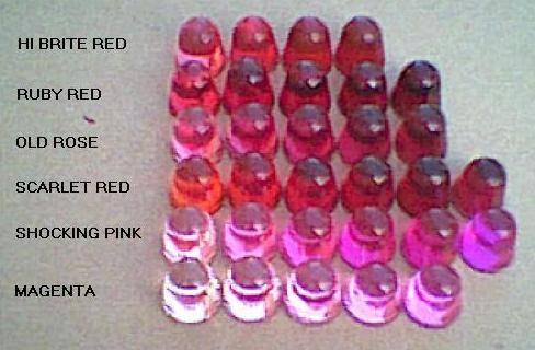

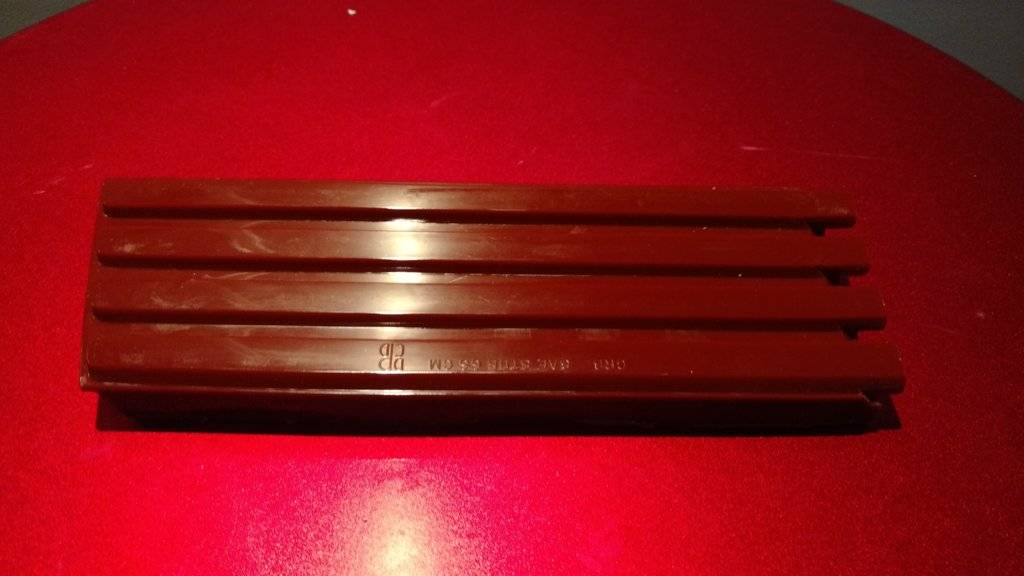

I knew I had a problem with the pigments. Way too strong, I will need to find translucent pigments. I put 3 drops of red and one drop of black, which totally muddied my color. I added 2 more drops of red too get I closer to the actual color.
Opaque lens anyone??? :)
I am feeling great now. I found a source of translucent dyes. They have several variations of red, I will probably get all of them to have the ability to nail the color. They said their examples are 1 to 6 drops of dye in 2 ounces of resin. I used about 6 ounces resin in the mold above, so I will have much better control and am sure I can hit the color.
I knew the Benjamin Moore Magenta wouldn't work...

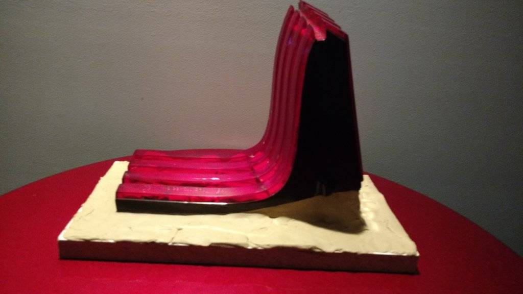

I would have completed the mold box this evening, but made an error in calculating the height of the box, so here is the unobstructed view of the lens mounted to the box base.
