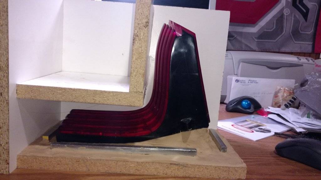

I feel like I could teach one now. My first rule is don't make a mold box for a 8 lb mold out of plexiglass and a glue gun. :)

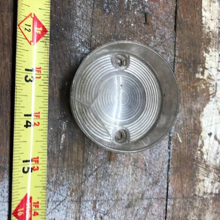

Here is one of the lens, it will also give me an idea what to expect if someone wants me to reproduce a lens that is intact but has a crack in it.

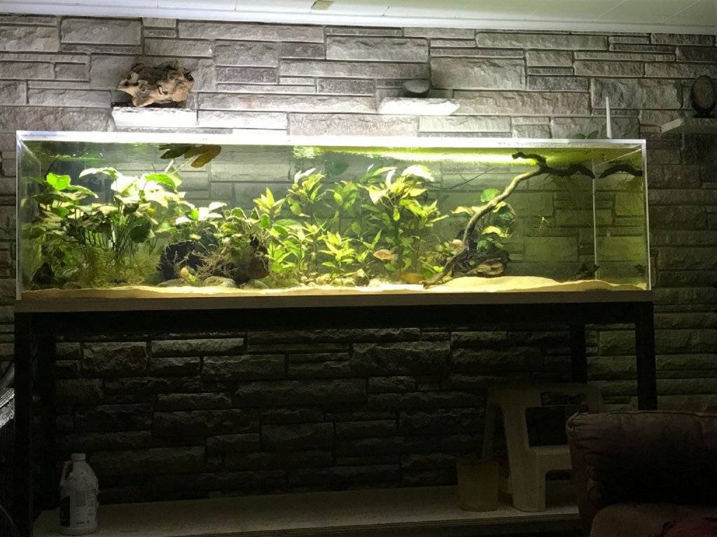

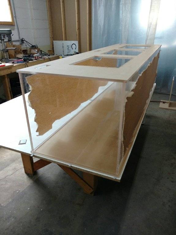

I have some experience making acrylic boxes, the last one is currently holding 200 gallons and no leaks.:)
Very cool Matt.
Thanks Mike, I built that one last year along with the steel stand for my website guy. The next one is going to be over 300 gallons for one of his fishy friends. Btw I thought this thread(as monumental as it is) needed to go off topic at least once so now that’s out of the way.:rolleyes:

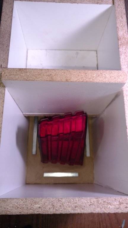

I wanted to pour my first mold half for the wrap around lens, but I needed to buy another sheet of melamine for the box walls.

Holy massive mold. I formed the box for the wrap around lens. I had just opened a new gallon set of the rubber material last week, it is 18 lbs. I just calculated the materials for the larger pour 16.5lbs, and I don't have that much material left. I could box off some more area but only lost around 2 pounds. I will just leave it and order more material.
