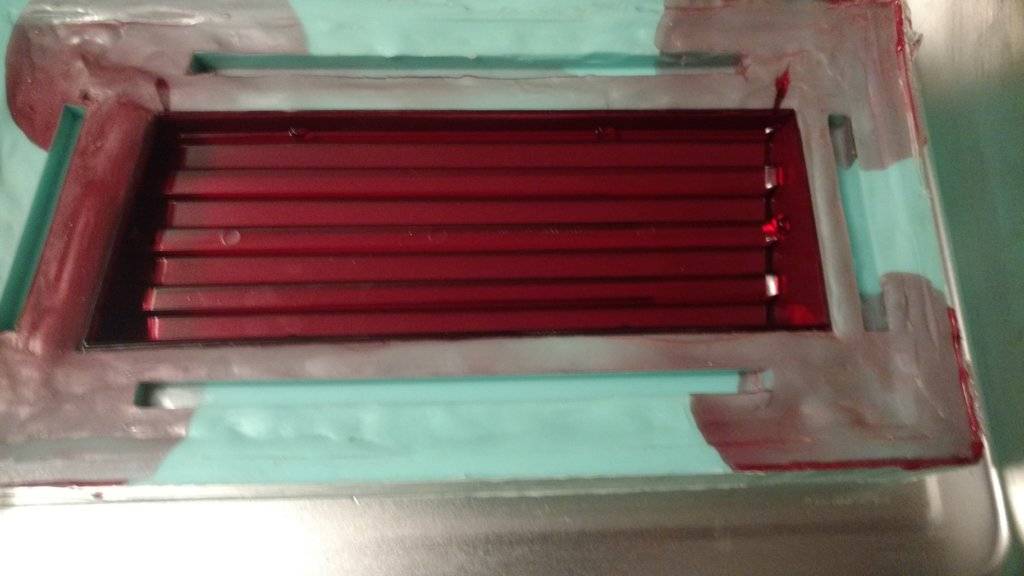

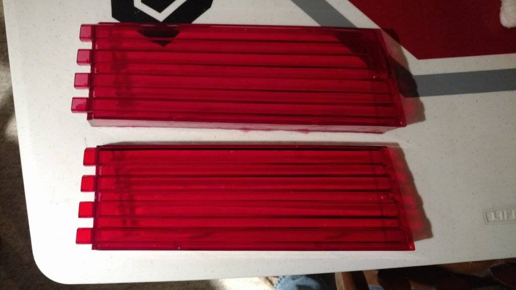

Pretty happy this is a darn close match. I am not pulling it out of the mold yet because it is still warm. The process I use: 3 hours in pressure pot, rest for 6 hours, and then 6 hours in the oven at 155.
This was the first time I took the mold top off. They mention it will take 5-7 days before the resin fully cures.
Pretty happy this is a pretty darn close match. I am not pulling it out of the mold yet because it is still warm. The process I use: 3 hours in pressure pot, rest for 6 hours, and then 6 hours in the oven at 155.
Very nice, Mike. You are my hero!

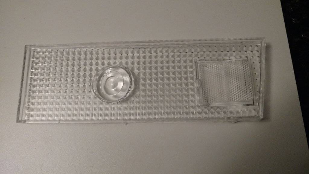

I will either pick up or order another batch of the silicone mold material today, so I can get the mold made for the wrap around lens.
