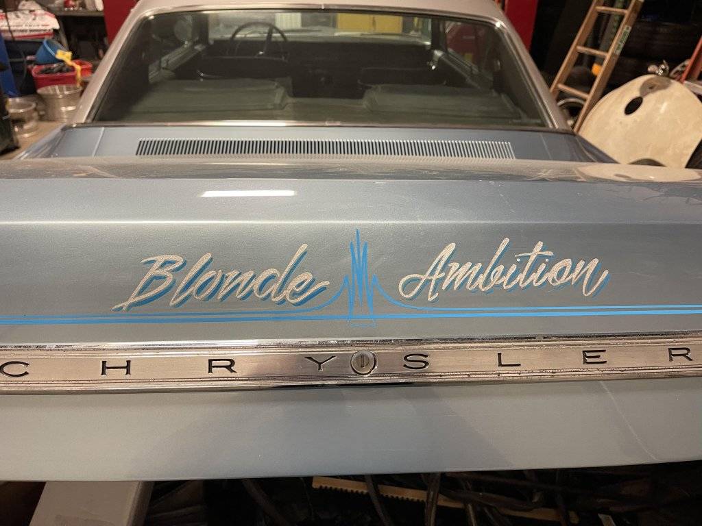

Dr. RU came over to put the final touch on it. My buddy came up with the name since it was my wife who wanted us to restore it when she first saw it back in 2010

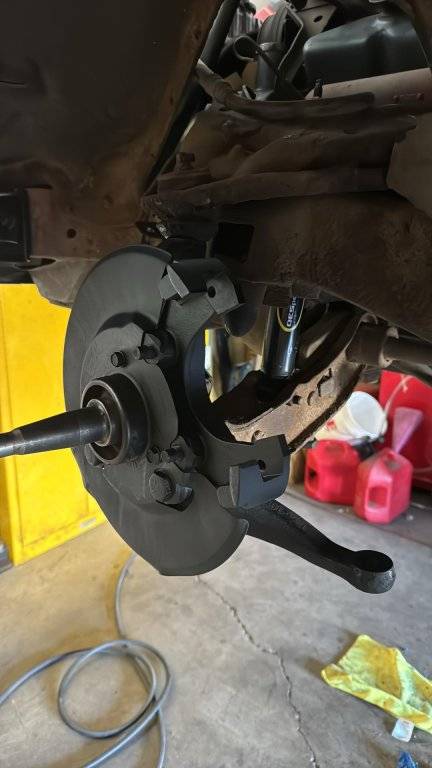

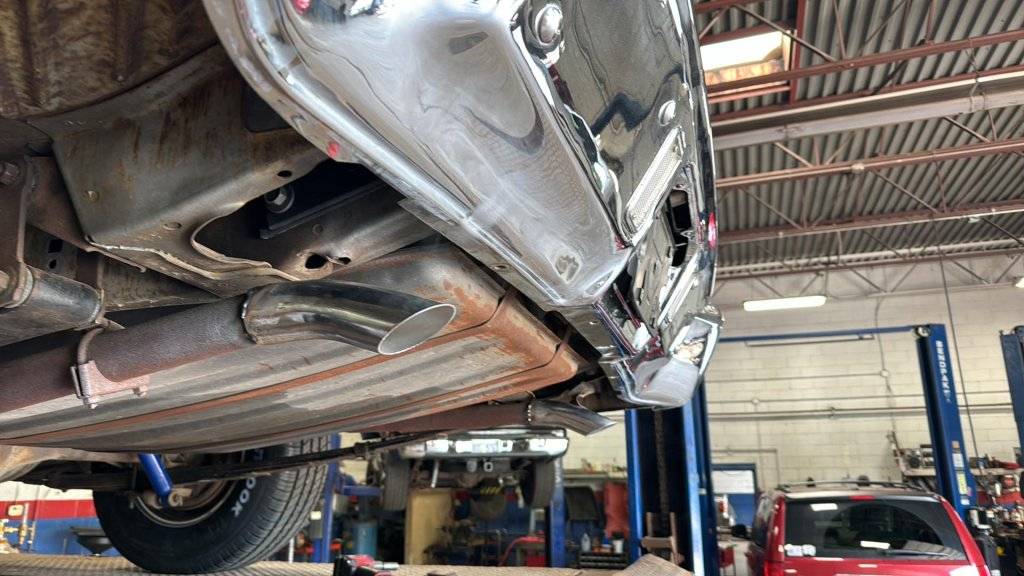

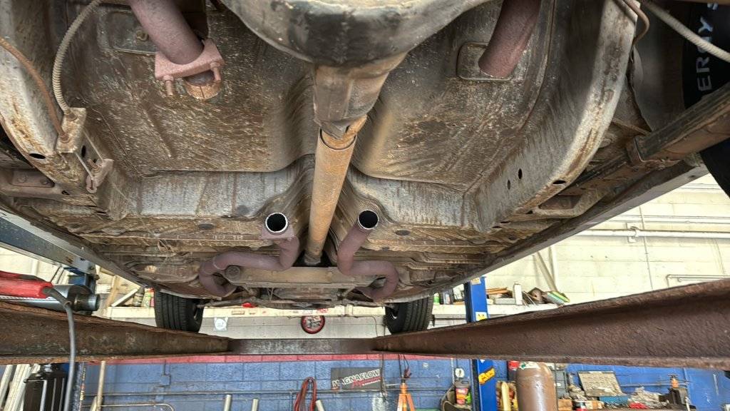

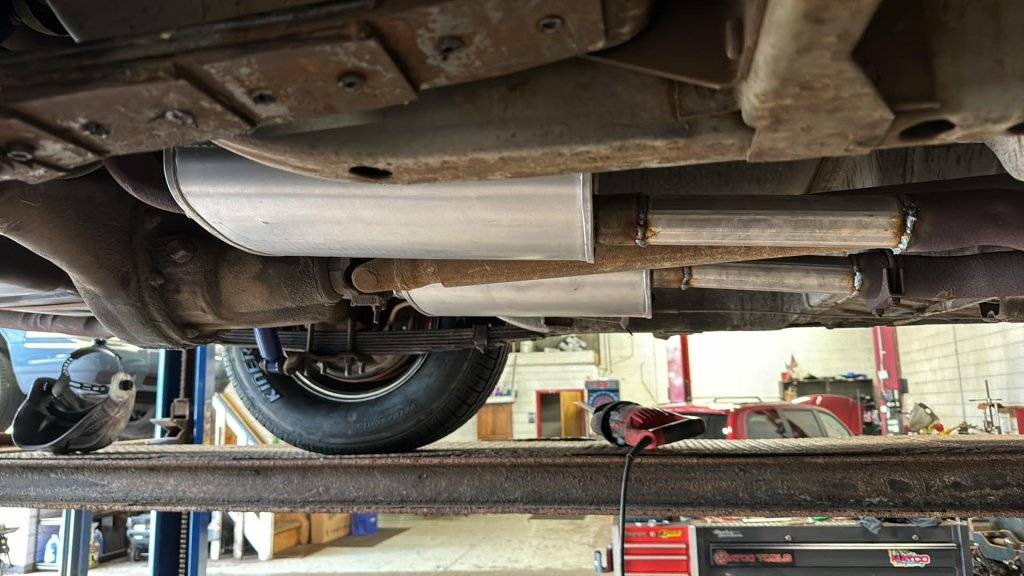

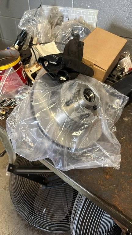

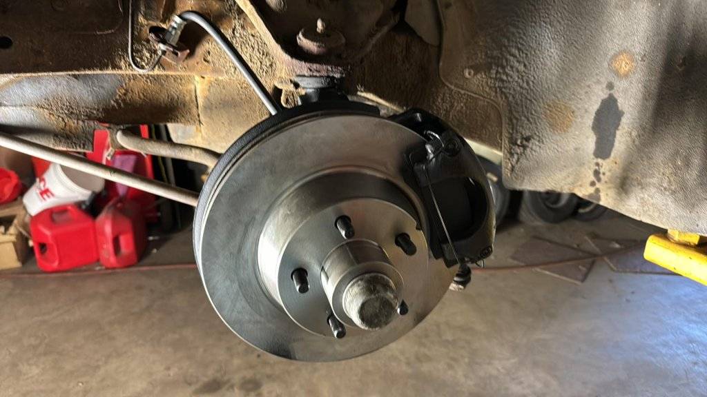

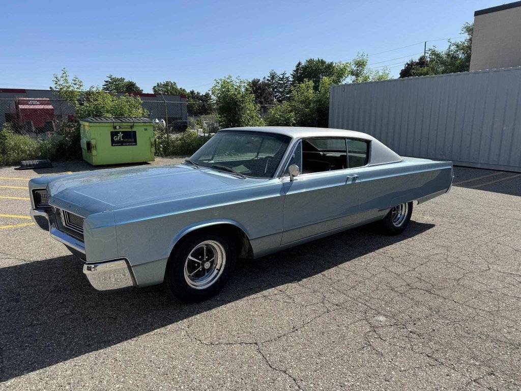

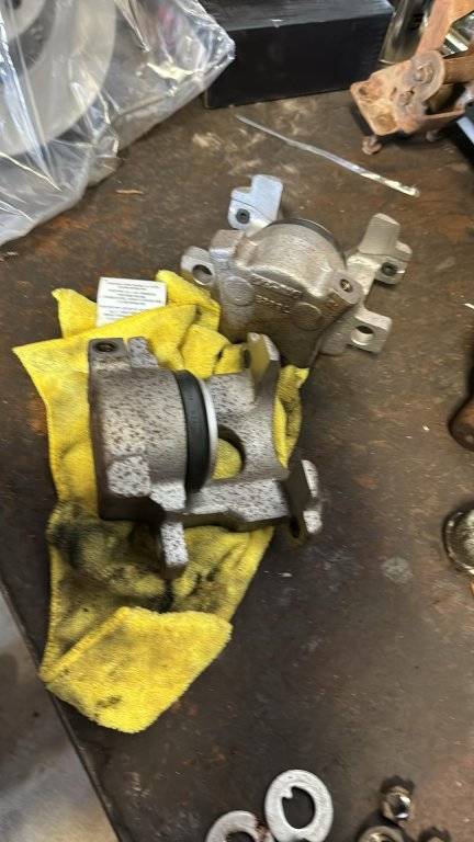

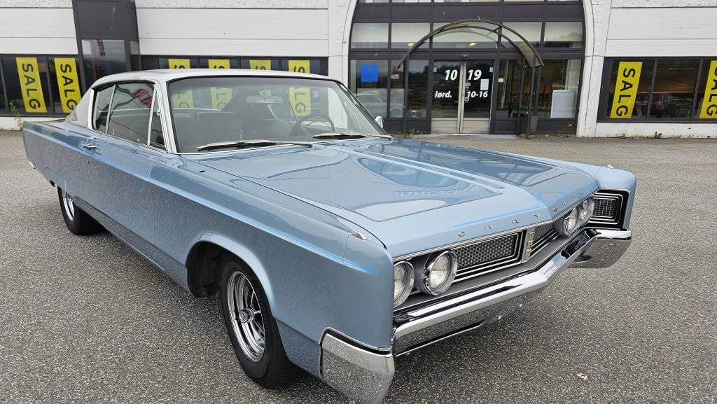

It now has a disc brake conversion using 71 parts, Turbo mufflers from Walker and 15x8 rears with 275/60 tires. Really pleased with the stance and overall look now.

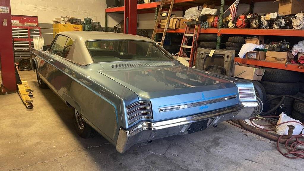

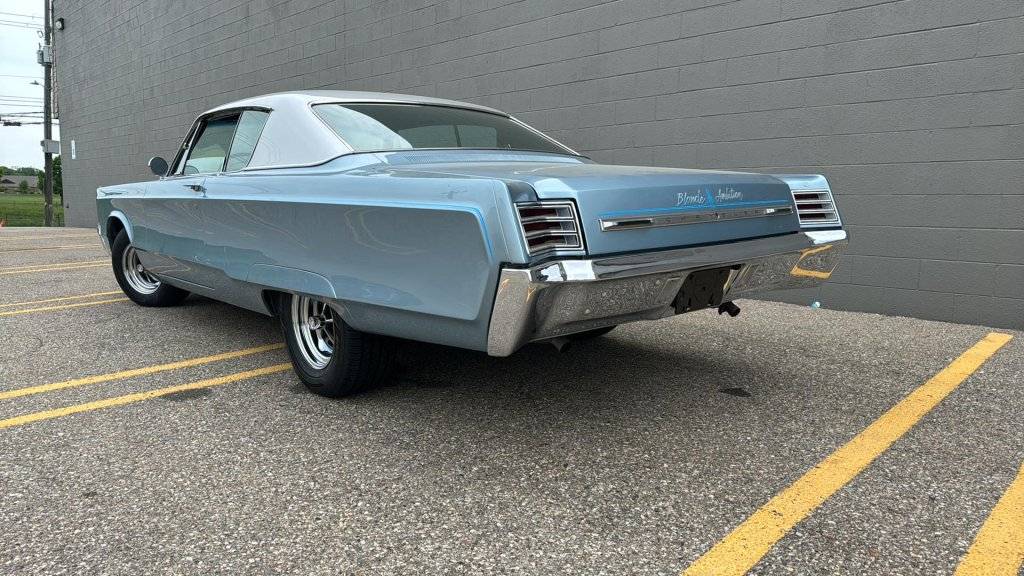

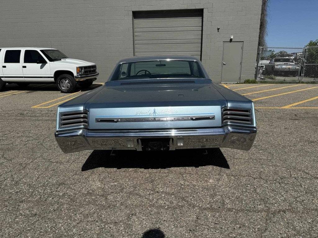

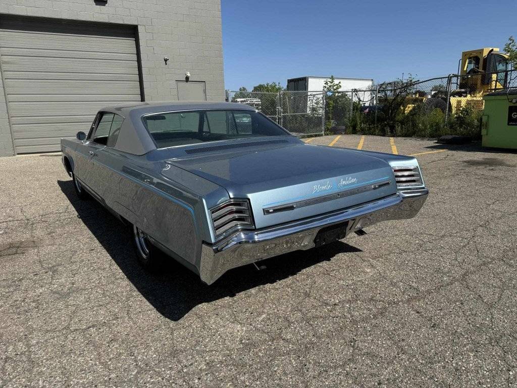

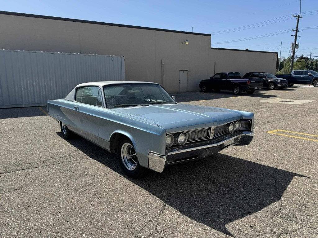

I wonder why there was no "Newport Custom" script on the c-pillar of your wife's car. The photos of the car being prepped show that there weren't any holes in the pillar for the emblem. Interesting.
There were no emblems on it when we got it either as you can see from these pics. In the prep pics they could already have been welded like the side trim holes, but since it had no emblems before that it might never have had any.

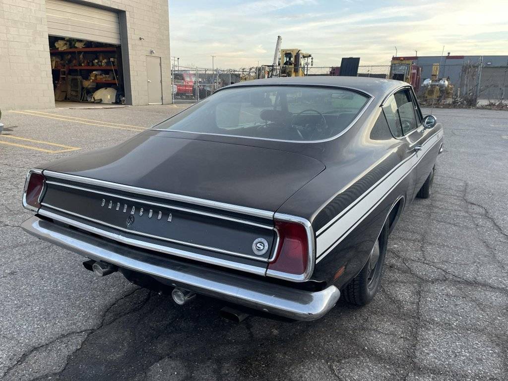

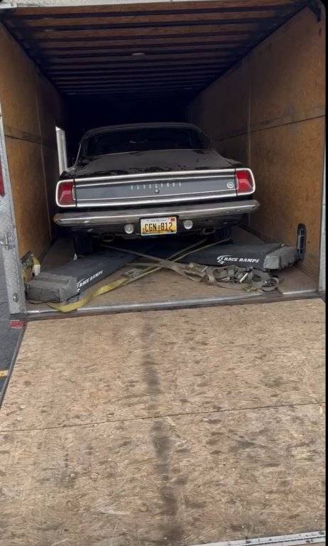

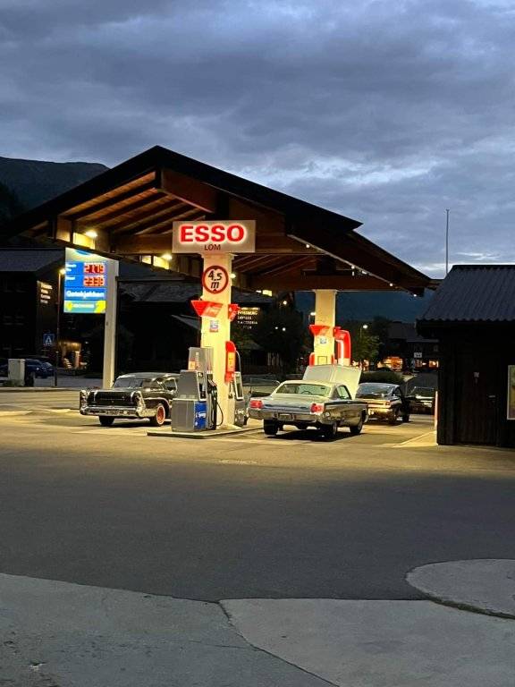

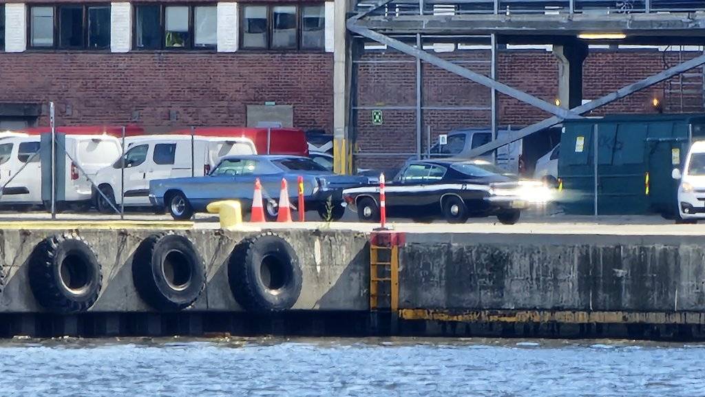

Finally on their way. Not too much clearance in that trailer but at least it's enclosed. One step closer to home.

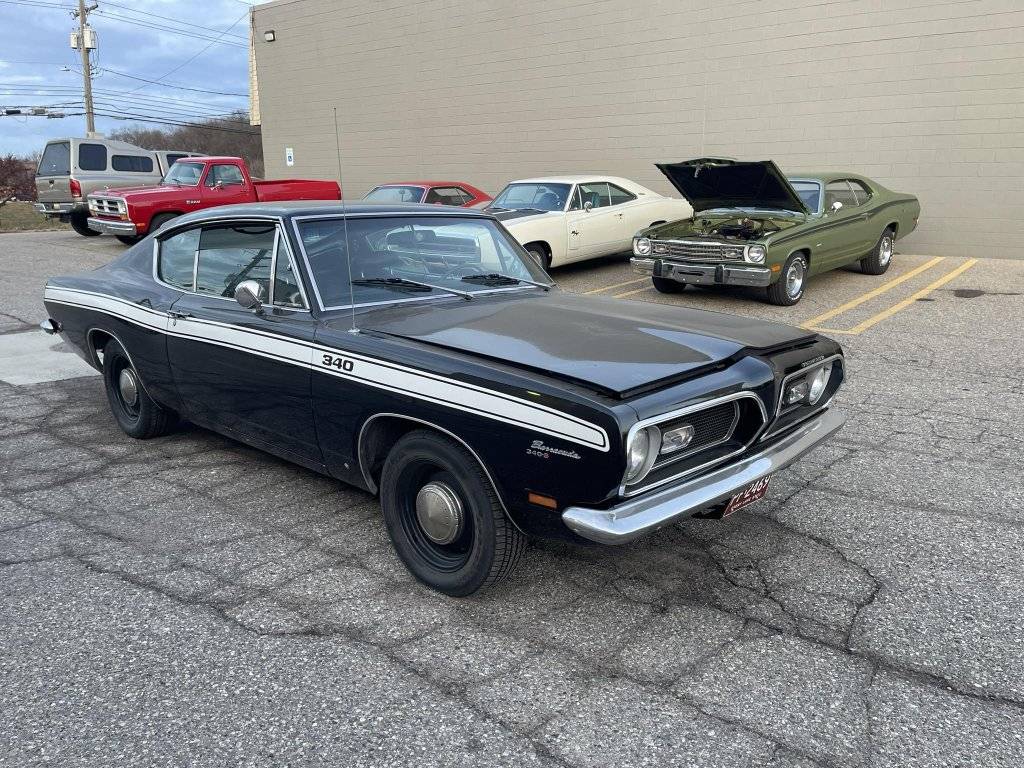

Nice barracuda! Love the black, I think that’s fairly unusual/rare. It looks like all of the 69 specific parts are good. 69 specific grill and tail panel pieces are very hard to find compared to 67-68.
Travis..

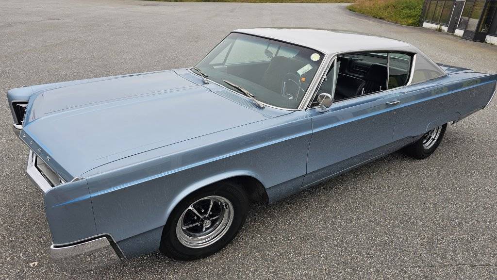

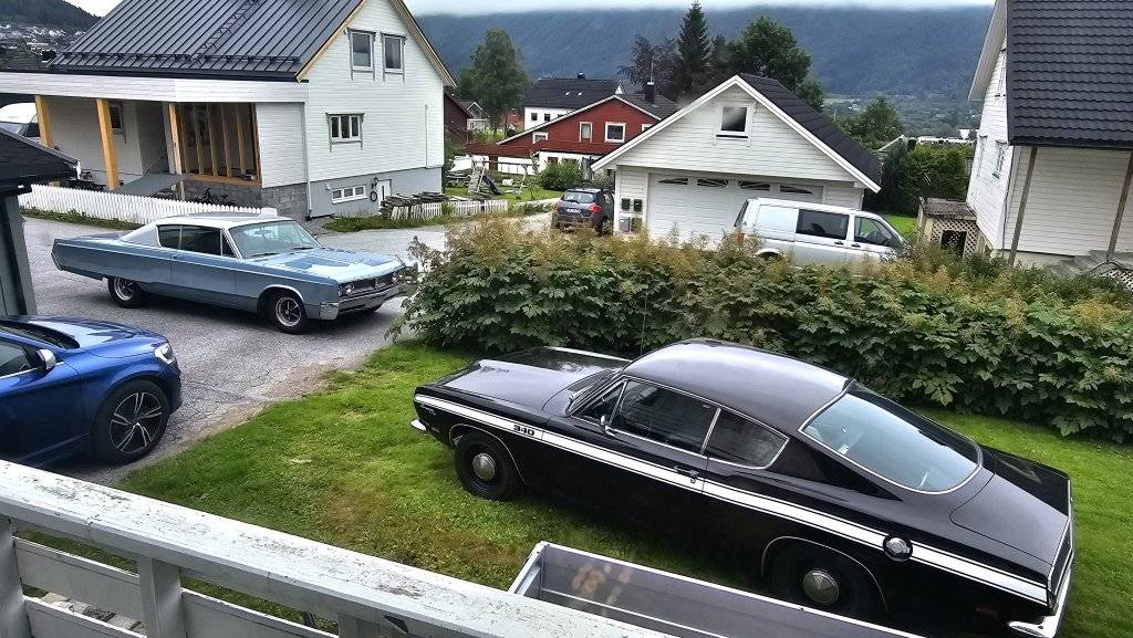

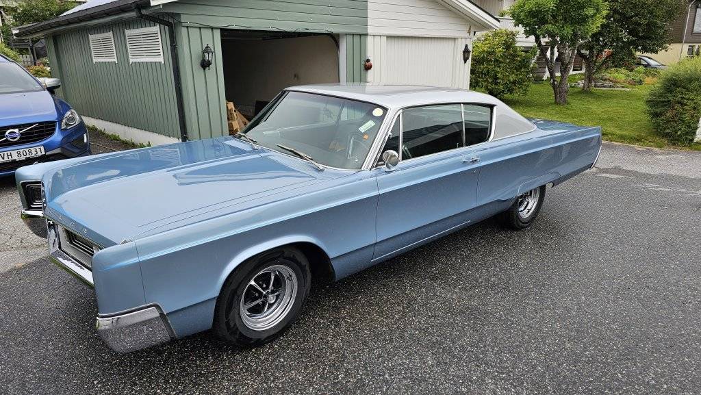

Picked up the cars at the port yesterday and drove them home, around 350 miles without any trouble or problems. Finally they are home
Love the lines and details, looks like a fullsize musclecar with the right stance. Got a lot of attention along the road and people came over at gas stations asking what kinda car this is. Lots of praise on the color combo too.

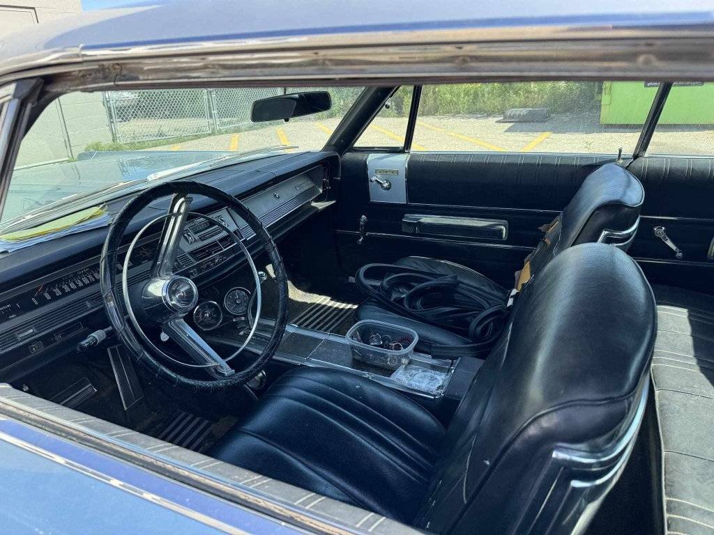

Now we will drive and enjoy it while planning the interior upgrade. Think we want to get a Painless kit too and do all the electricals just to get it top notch. Being a California car it's had it's share of heat which we can see in the seat foams and wiring etc. Good part is it never had any rust ever.
