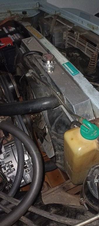

You.made a point. Mine has the hoses on the same side too.
Problem is my inlet and outlet are both on the passenger side
I couldn't figure it out. Like I wrote somebody already installed it in the US prior to shipping it to Europe.
Any idea what year of Explorer? I have a 69 Imperial and the aluminum 26" radiator won't fit right.
I could give you a part number, because I've had one sitting in the corner of my garage for 10 years waiting for the New Yorker to spring a leak. But I didn't know the Imperial rads were that different. I think there's a thread here somewhere from years ago where I got the idea to start with...
