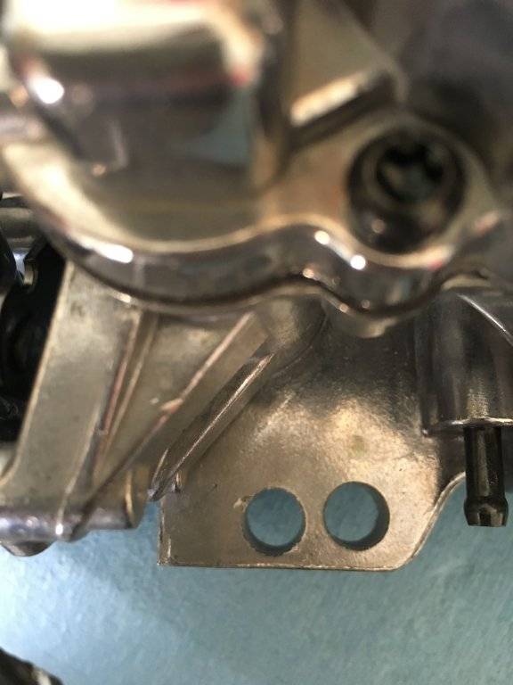

UPDATE: (for those somewhat interested) So...I ended up purchasing the Edelbrock Thunder series 1806. It's the 650CFM model. I thankfully ordered it through Summit Racing. I say thankfully because after prepping the carb and everything else for installation, I go to put it on the manifold studs and...it doesn't fit. It goes down part of the way, but it wasn't really that close to the manifold. So I check the studs. They're new and look fine. Thinking they might be the wrong size, I do some searching and realize they're not. I then look at the carb. Specifically, the holes on the base plate.
On these Edelbrock carbs, there's 2 sets of holes on the base plate, obviously for manifolds with a tighter bolt pattern. The 440 application uses the "outer" holes. Well, upon looking at these holes, I notice that one of the outer holes is literally 1/8" lower than the hold next to it. And hence, why the carb doesn't fit on the studs. There's not a lot of room for error of it being a perfect square, and this is far from perfect.
So I call up Summit on Saturday. They tell me it will go out Monday and I'll have a new carb in hand on Tues. It didn't go out til Tuesday, but whatever. I got it yesterday. Pull it out of the box, don't prep the carb as I want to just see if it fits. Summit sent me some new studs free of charge, so I take the new "old" ones out of the manifold and put the new ones in. I drop the carb down and... ... same problem. I look at the carb base, and AGAIN, one of the outer holes it 1/8" off.
I call Summit again. After them figuring out it's the right carb for a 440 (it obviously was; I did my research before ordering), they pretty much tell me my best bet is to just drill out one of the holes (or a couple if needed) for it to fit. So I have that to look forward to this evening.

RE: Holes.
Edelbrock has made a hundred billion gazillion Performer and Thunder series. Seems strange that they didnt get yours right. Your manifold, maybe?
As mentioned by Doba above, you can tap off the ballast resister on the hot side thst becomes engergized with the ignition on.
RE: Holes.
My manifold looks fine. I looked over the Holley that was on there and the holes don't look elongated or out of sorts. Plus the Holley that was on there wasn't the original carb for this engine, so it's not like it's only had one carb on it its entire life.
If I took a pic of the holes, you'd see how off line the one is.
I just spoke with someone directly at Edelbrock. He's never heard of this issue either. I'm going to take a couple of pics of both carbs (I still have the original one Summitt sent me until tomorrow) to send to him. So the saga continues....
OK, I found a pic of the troubled corner. The holes on the other three corners are parallel with each other (or at least very close).
I have 3 Eddys on BB Mopars right now and 2 on the shelf and I can honestly say I've had any problems installing them on either factory square bore manifolds or Eddy Performers. Are you using a spacer between the intake and carb? Need a picture of your intake to compare.
