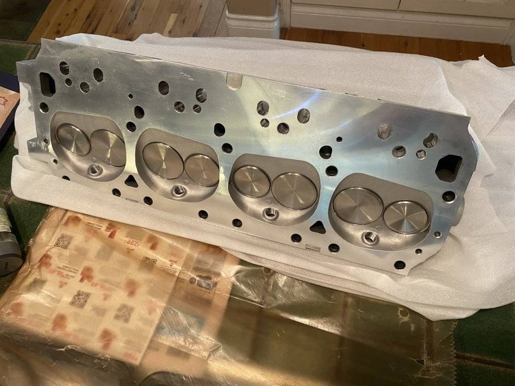

This seems like a good fit, 440 source is great value for money, so I might as well get the entire valvetrain at once from them. It's a bigger cam but not too big. It'll just be a main street bruiser, not a serious race car. Gonna go full roller though, hardened pushrods, the whole nine yards. In for a penny, in for a pound. Or a thousand.

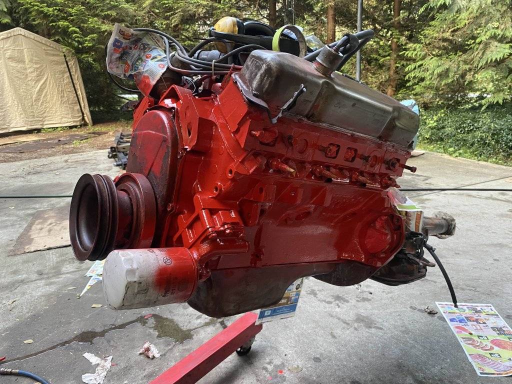

More orangey than I had hoped but not bad. Ill paint the pan, covers etc when I pull it all apart to do the cam.

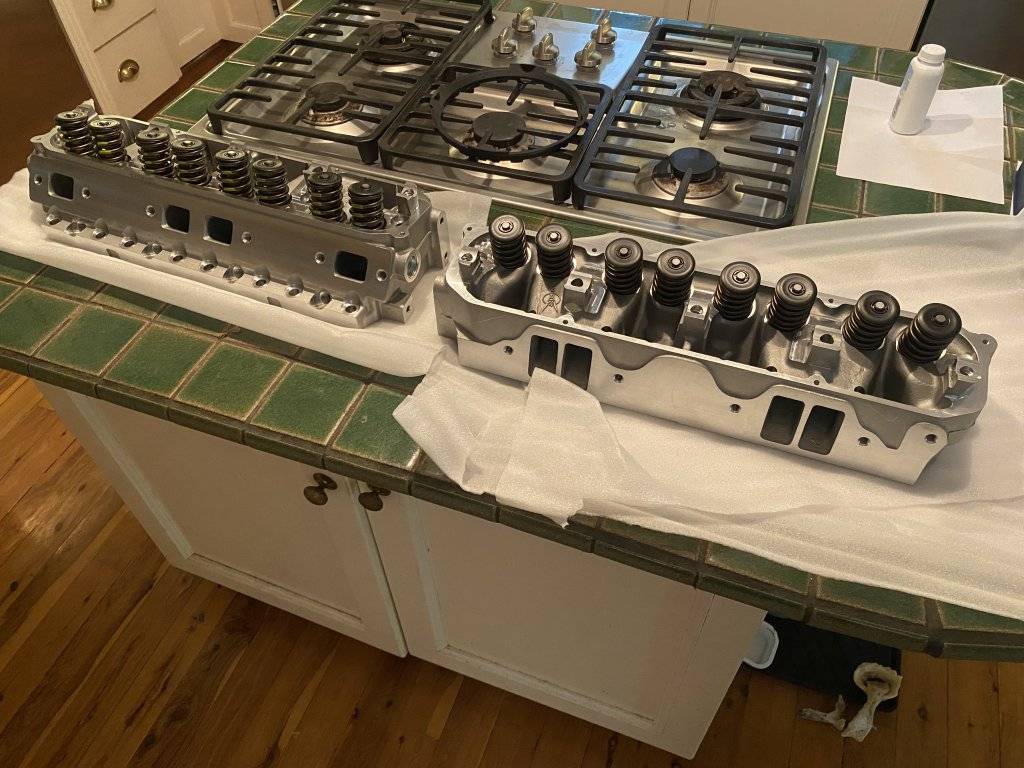

I also decided that since I want a roller cam, the factory springs will not take it. So **** it, time to do the whole top end. I have the money, why not.

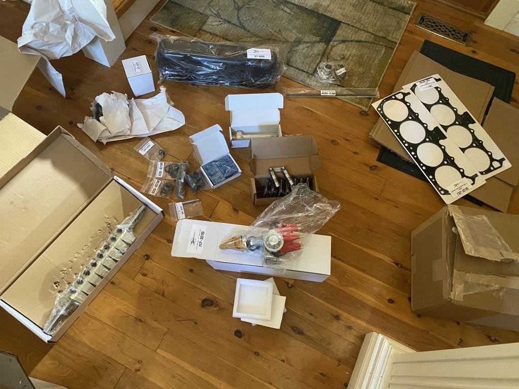

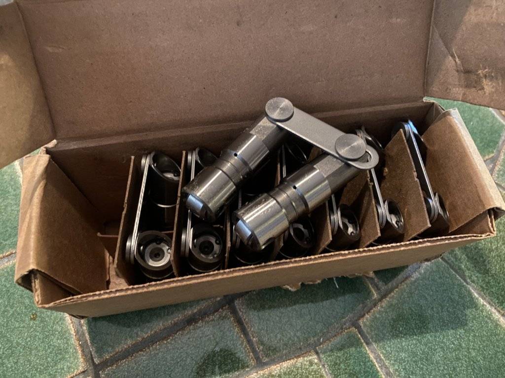

So my new top end, roller lifters, rockers, pushrods, distributor etc is on it's way. can't wait. Went with the Comp Xtreme Energy 230/236 cam. Should work very well with the stock converter and see a massive power gain for only a mild loss of milage. No thumper cam insane overlap for me. Even if it does sound cool. Really hoping the valve relief in the piston will be deep enough so i don't have to drop rods. Guess we'll see.

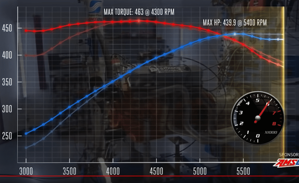

Which remarkably makes my motor very similar to this thing. Even the overbore (if grandpa is to be believed). But my motor is 10-1, not 9.4-1, i'm using a much better 7186 manifold and i'm using 440 source heads, not the factory 906 heads. So Blue's gonna have even more oomph than the motor trend mill. And look what that thing pulls.
This is gonna be a rocket ship.

440 source chamber is advertised as 80cc. Might have them milled down to preserve the compression ratio, not sure. Gotta get the motor back in the frame to take the top end off and see whats in there, my only engine stand is occupied right now. Might I get away with flat tops? Don't know. I'll have to clay it no matter what's in there.

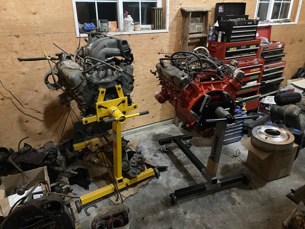

Bought another engine stand so as to not play musical stands with my 351. Tab was way longer so my bolts didn't fit. Cool.
These torque converter numbers mean anything to anyone? I'm really hoping this is the high stall towing package converter, which theoretically the car should have, but it's also turquoise so who the hell knows.
Tomorrow the violence begins. Again.
Not impressed with the quality of this stand but it's the only one i could get today. Welds are not remarkably reassuring. But it's only about 150 pounds load per bolt/tab. Oh well.

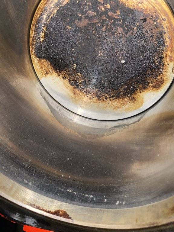

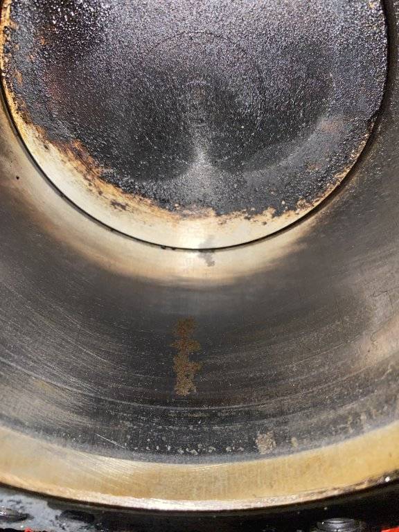

Cracked open the motor. It almost looks immaculate inside. However there's some serious wear on 3/4 of the passenger side bores. Small spots of rust and some piston skirt wear right at the bottom. I thought the rust was from me powerwashing the block, but the one with the open exhaust valve was the only one without rust in it. Go figure. Also, it completely lacked intake gaskets, whoever put this together last figured the valley pan was enough. No wonder it had a vaccum leak.
I also measured the bores at 4.255. It's entirely stock. Was that rebuild in 2002 real? Was it just a dingleball and rings? If it's 60 years old, how does it still have the crosshatch and 130 PSI compression?
Regrettably it has the expected flat tops. It needs new pistons anyway, the bores are almost good but there's enough trouble that I think it's time to visit the machine shop. It's .020 over time, i think.
I'll have to do the math, but hopefully that means I can keep the 10-1 compression ratio without miling the new heads any.

The person decided it only needed the valley pan is MA Mopar. That's how it's supposed to be.
Sounds like maybe it wasn't rebuilt...or maybe a quick rering and bearings if anything.
