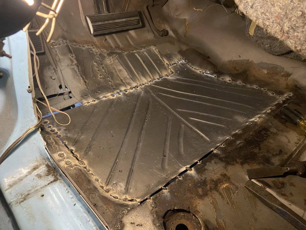

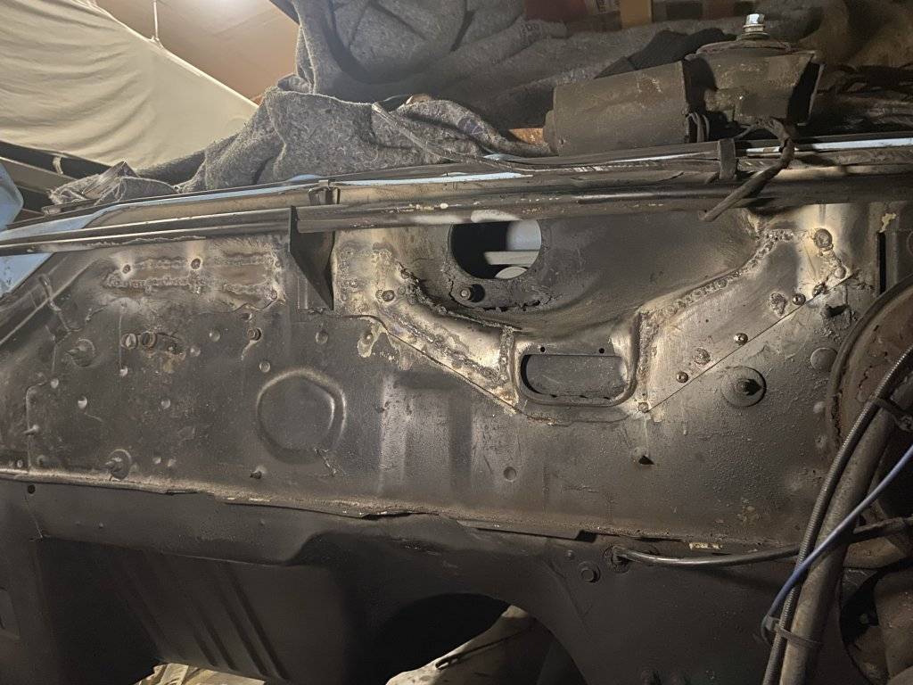

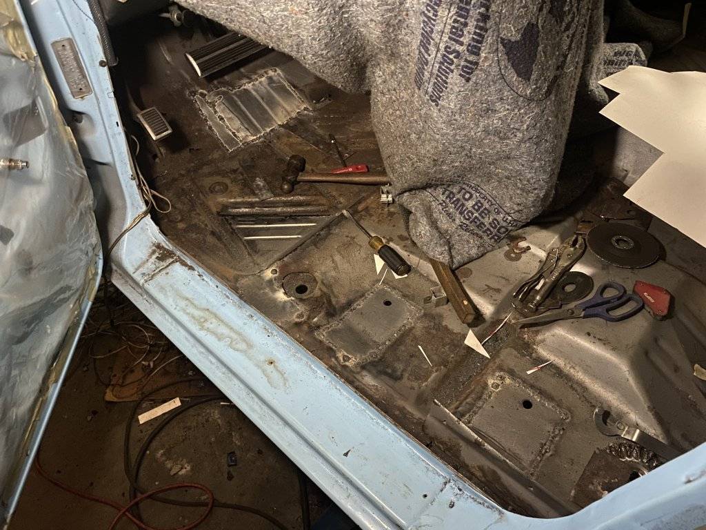

Not dead, just busy with dull things on the car. Lots of patches on the floor, seat crossmember was a disaster, under pedal area was a special kind of hell and it turns out the cowl was a complete mess just for gratuity.

Where did you get your new floor pans?
I’m heading towards replacing one on the driver’s side front and the trunk pan(s) in Elwood, the 68 Fury II 4 door sedan.
Made them. You can tell because the beadrolling is garbage.
If you want factory perfect patch panels, the driver/passenger footwell pan is the single repro i've seen available. They're like 200 bucks plus shipping though so ehh. If you do do them, be real careful not to cut into the structure in the foreward outside corners. i didn't cut into them, but it'd be easy to do if you don't know they're there.
