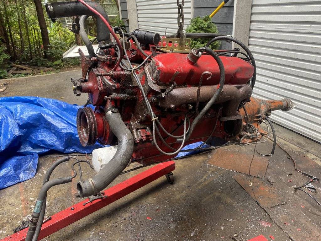

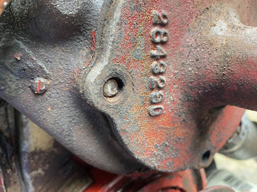

Looks to be the original water pump too. Maybe I should've left well enough alone. Bearing feels perfect, zero play, and it's on there good. Heat, deadblow hammer, even some cautious chiselling, the pump is still stuck on there. Reticent as all get out.
Intended to have the motor painted by now but a massive storm is rolling through, no sign of letting up. If it keeps going I'll just start pulling apart the old stub in the garage while I wait.

Maybe an air chisel would

Maybe an air chisel would knock it loose?

The last one like that came off for me with 4 painters 5 in 1 painter's scrapers around the edges. I tapped around the rim evenly from one to the next until it came off.

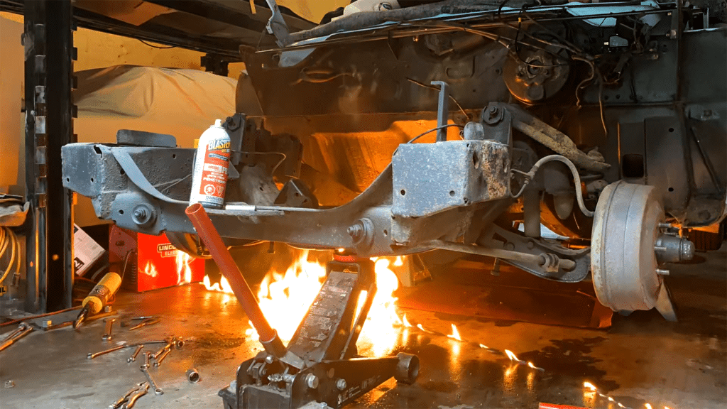

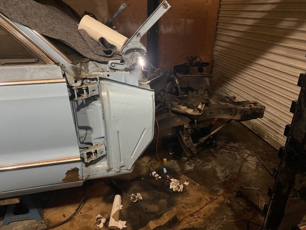

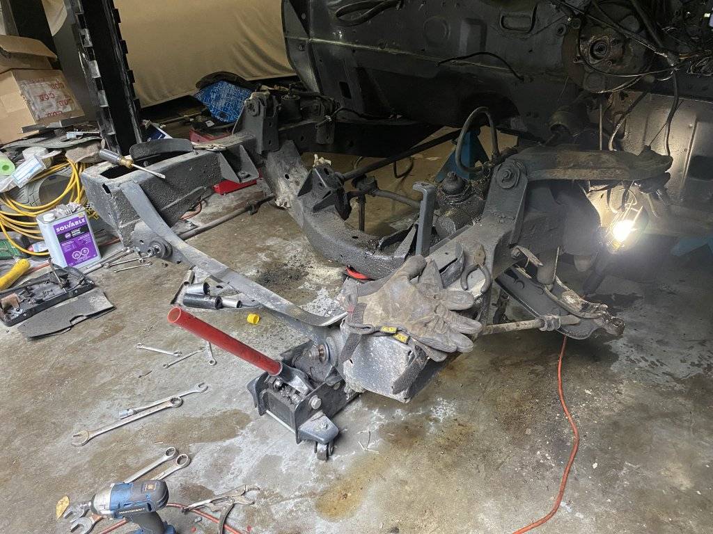

Back in monster truck mode.
Tortion bars were junk. Car was sitting on the bumpstops but the adjusters were maxxed out. Hopefully the mere sedan bars from the donor are ok.

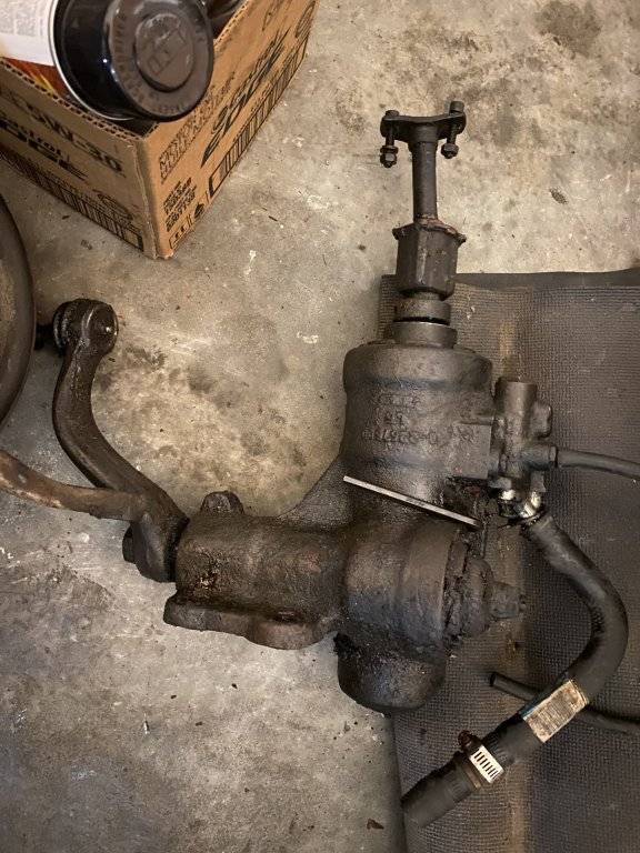

Gonna use the original hubs/brakes, sway bar and steering gear. Everything else is junk.
Mercifully, despite the condition of everything on this car, somehow the cowl drains are perfect. The drains aren't even plugged.
Go figure.

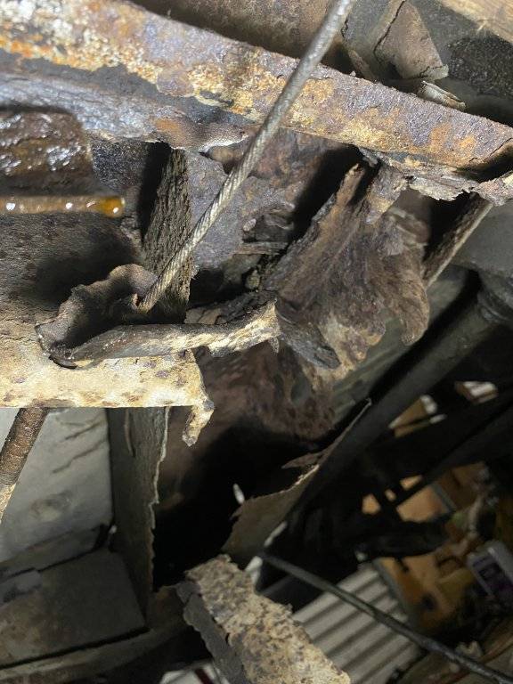

What the hell was holding this car together?
That's the tortion bar box section, the thing that holds the car up. There is nothing here.
Also may have set fire to myself a little. Turns out grease explodes and that factory fuel line i bypassed when i turned the car around a month ago still had 4 year old gas in it. Oops.

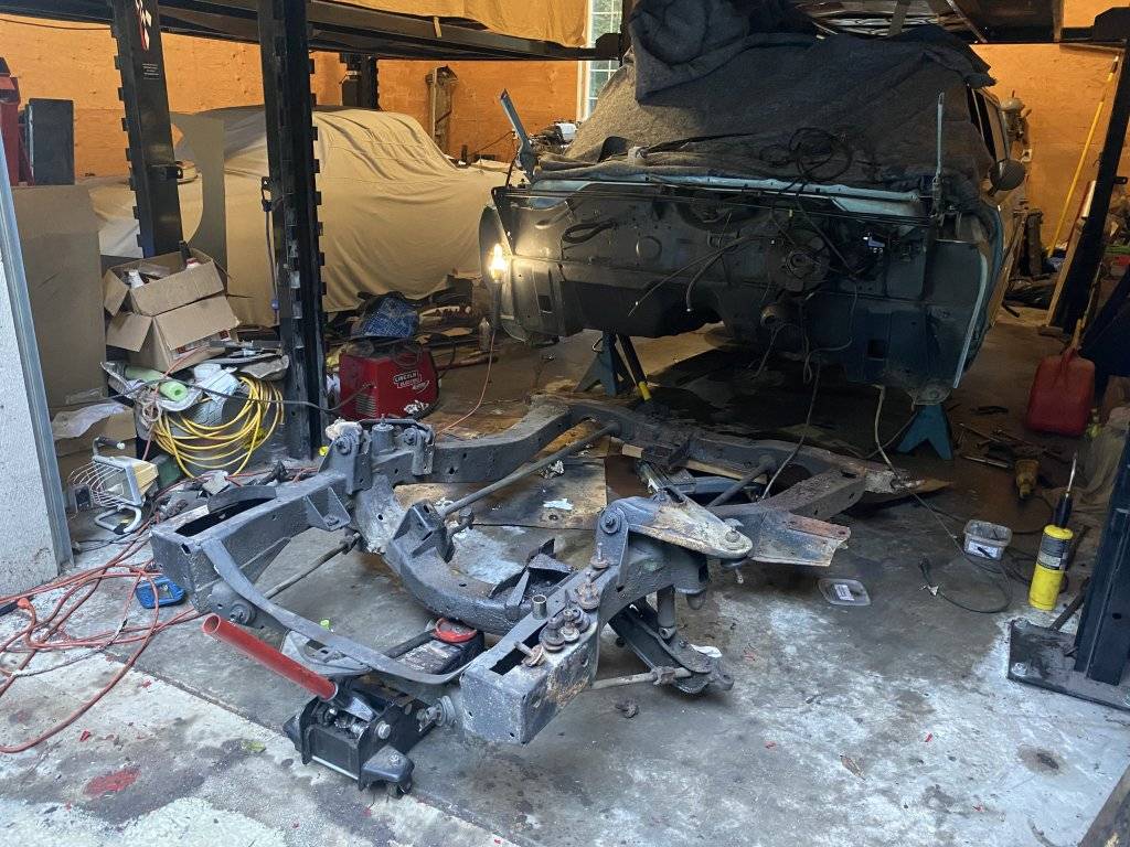

Stub out tomorrow. Got some floor patches to make, that's for sure.

I'm just blown away by the amount of rust and the lack of connecting metal on this ride.
Amazing you drove it like you did in the beginning, and it made it.

I have spent all day fighting the stub frame bolts. Everyone has been a disaster, one even ate my nut buster.

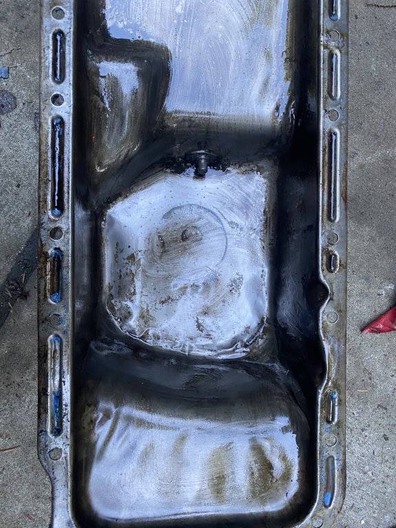

So the oil pan doesn't have the baffle in it, and is so dinged up there's a witness mark where the sump was touching it. Not great.
Bottom end looks terrific though. Bit of slop in the chain but that's going away when i do the top end so who cares. Otherwise spotless, i was expecting a lot of sludge and it was immaculate inside. Thanks for the oil changes, grandpa.

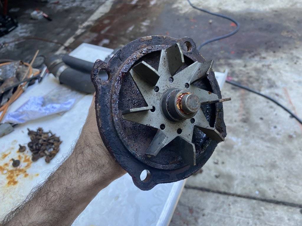

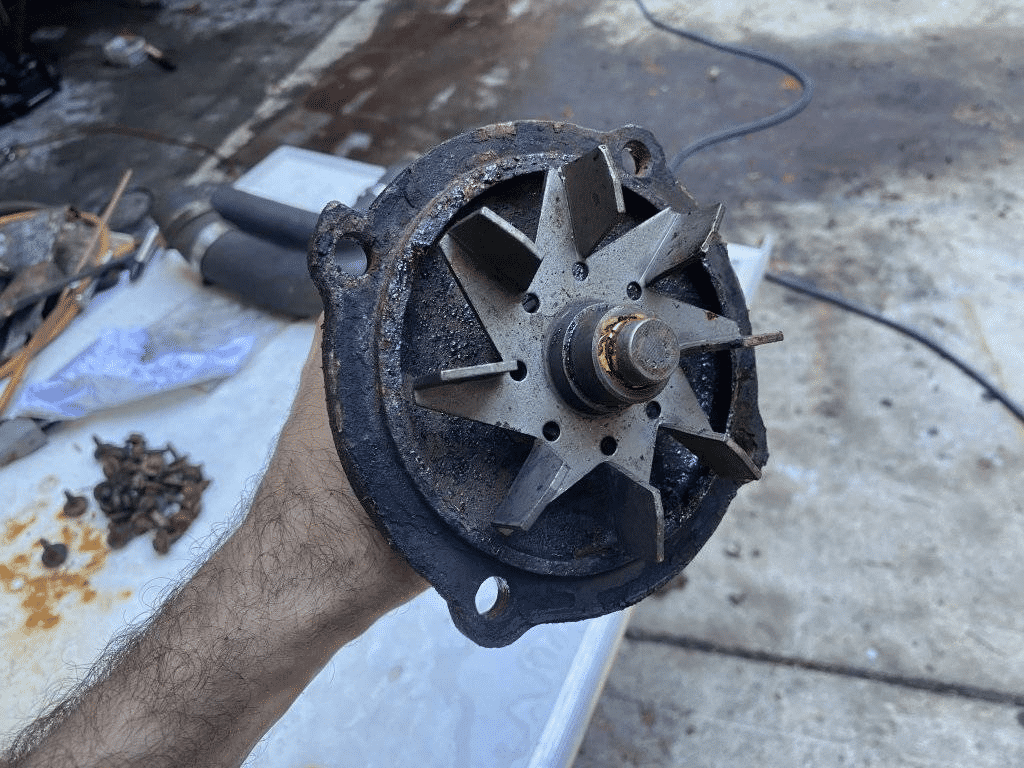

Water pump was also in really good shape. Shouldn't have messed with it. Oops.
Onto the spare pile that goes.

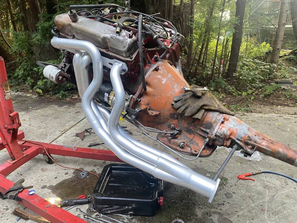

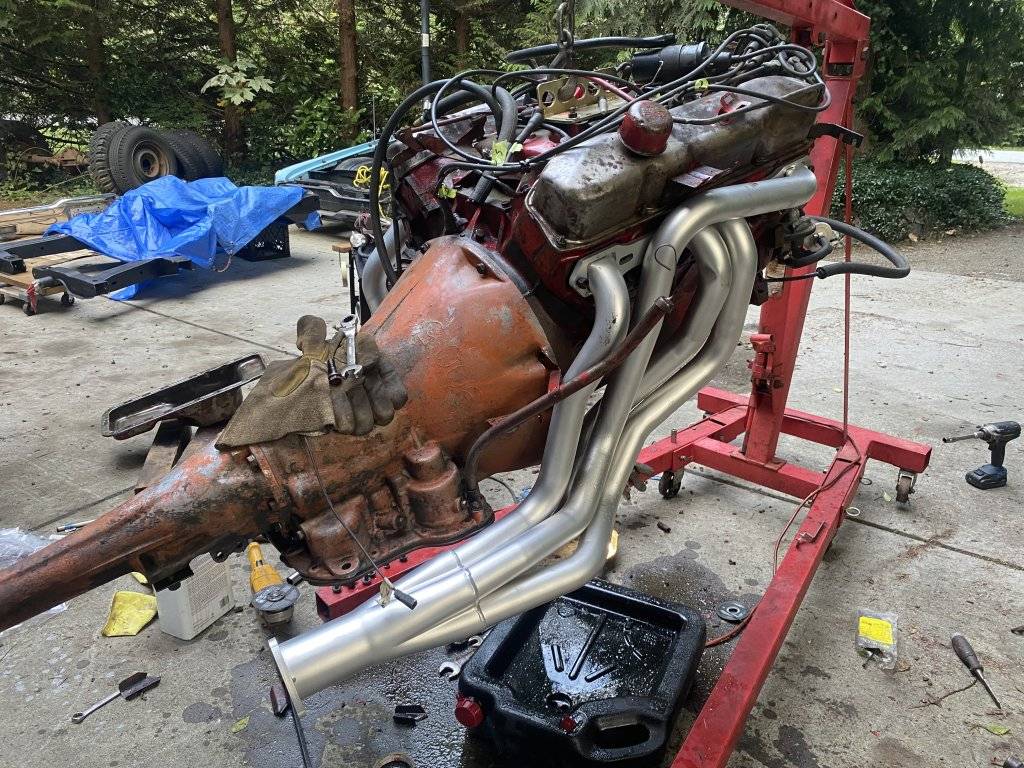

Test fit the pipes though. Hot damn.
Had to tweak the dipstick tube a bunch, brok the welds and made it clear. Likewise, it does clear the stock starter, hell yes. Have to replumb the tranny cooler lines though, drats.
TTI instructions say I can use the exhaust studs on the driver's side but not on passenger. There's only one stud left on the right side though so hopfully i can just get away with that. Someone had fun with studs at some point, most of the studs were drilled out in coarse thread and half of the holes are helicoiled. One or two drilled into the coolant jacket.
Can't wait to get those 440 source heads on there.

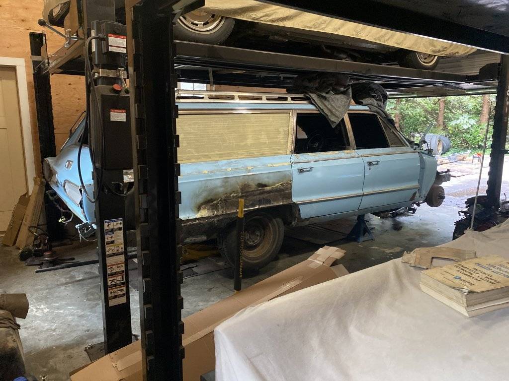

Also you'll note that's not dirt on top, it's sand. From the popular location, the ocean.

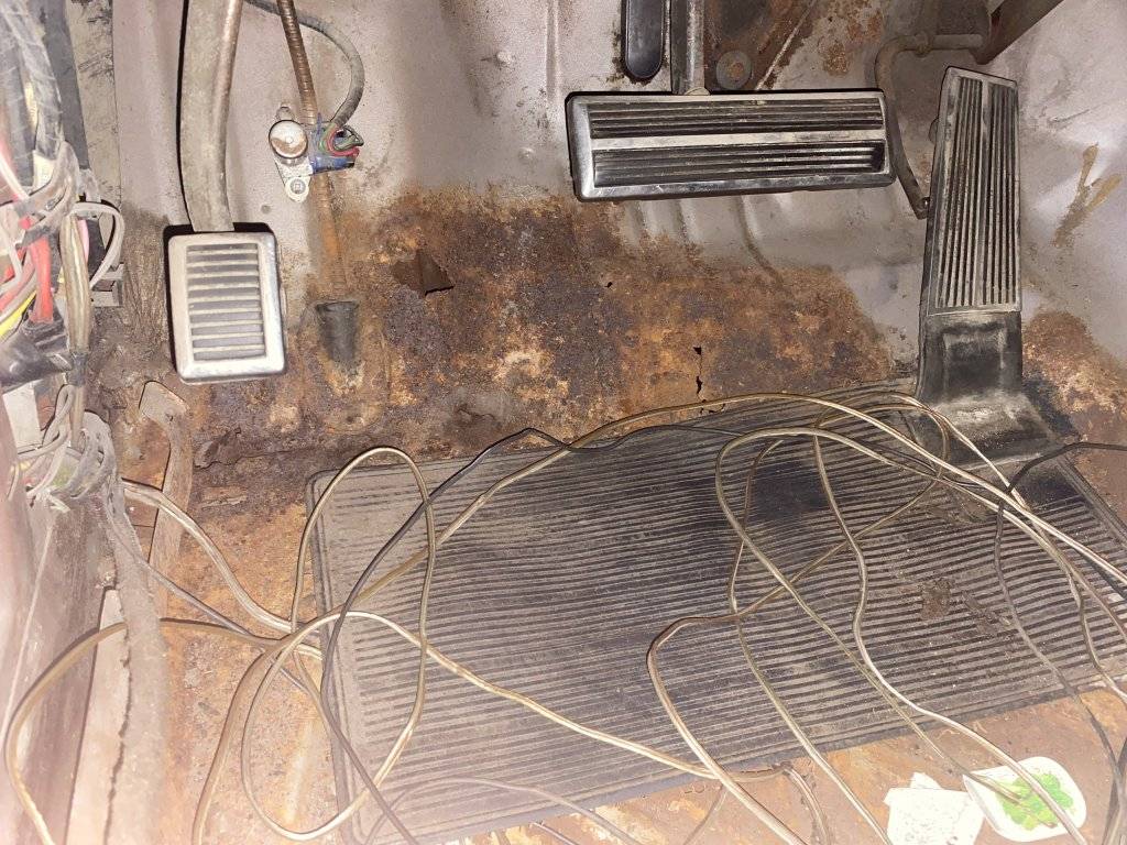

I also found some rust holes in the foot well on the inside of the stub frame mounting box sections, which are entirely sealed on all sides. Meaning this had to have rotten through from this side.
I know grandpa got flooded in about 2009, when a storm kicked up the ocean over the levee. I think this is irrefutable proof that the car was flooded up to the rockers, and the salt water was retained by the carpet. Explains a lot of weirdness and peculiar rust spots i've seen
I'd bet anything the car was absolutely fine before then, too.
Happily the actual stub mounting faces are ok. Not good, but not bad either. Got some floor patches to make and I'll paint the underside while all this is off. Then the new stub is going on within the week.
