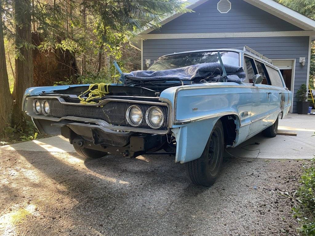

New Member, New Polara
Still waiting on the bodyshop to get around to me. But events are transpiring.

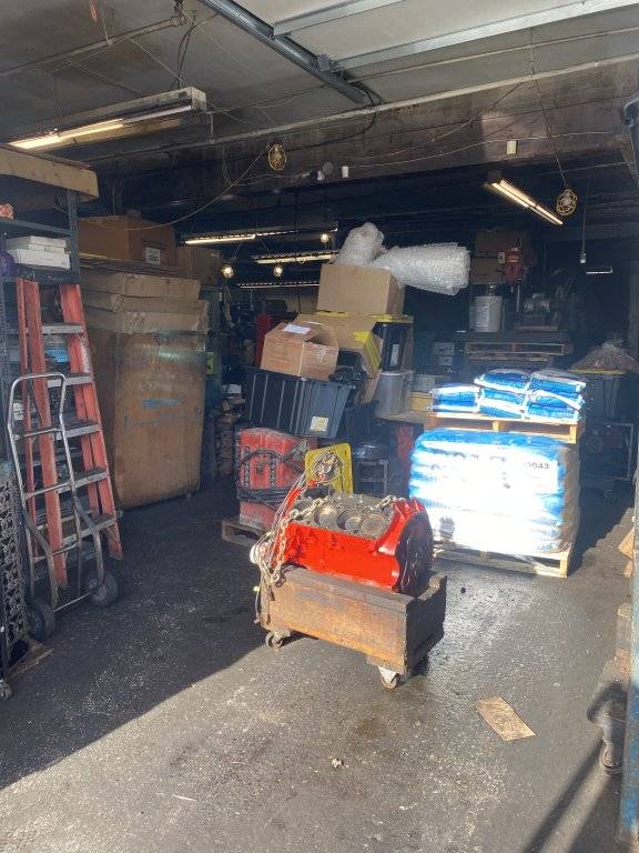

Motor is off for machining. After talking the build over with the guys at the shop they basically said "Yup, good build. No notes", which was reassuring. Gonna enlarge the oil galley to main holes, have the crank balanced, stronger spring in the oil pump bypass, full groove bearings, ARP hardware on the bottom end, etc etc etc. Throwing the entire book of tricks at it.
The deck measured out of level, as mopars are want to do, so it'll get milled flat. Since it already needs premium gas, I figure we'll bump the compression up to 11.5-1 or so. Jaguar v12's ran at 12-1 back in the 70's so i think that's pretty safe. Should be as hype as a stock looking 383 can be. Also picked up the tranny while i was down there.

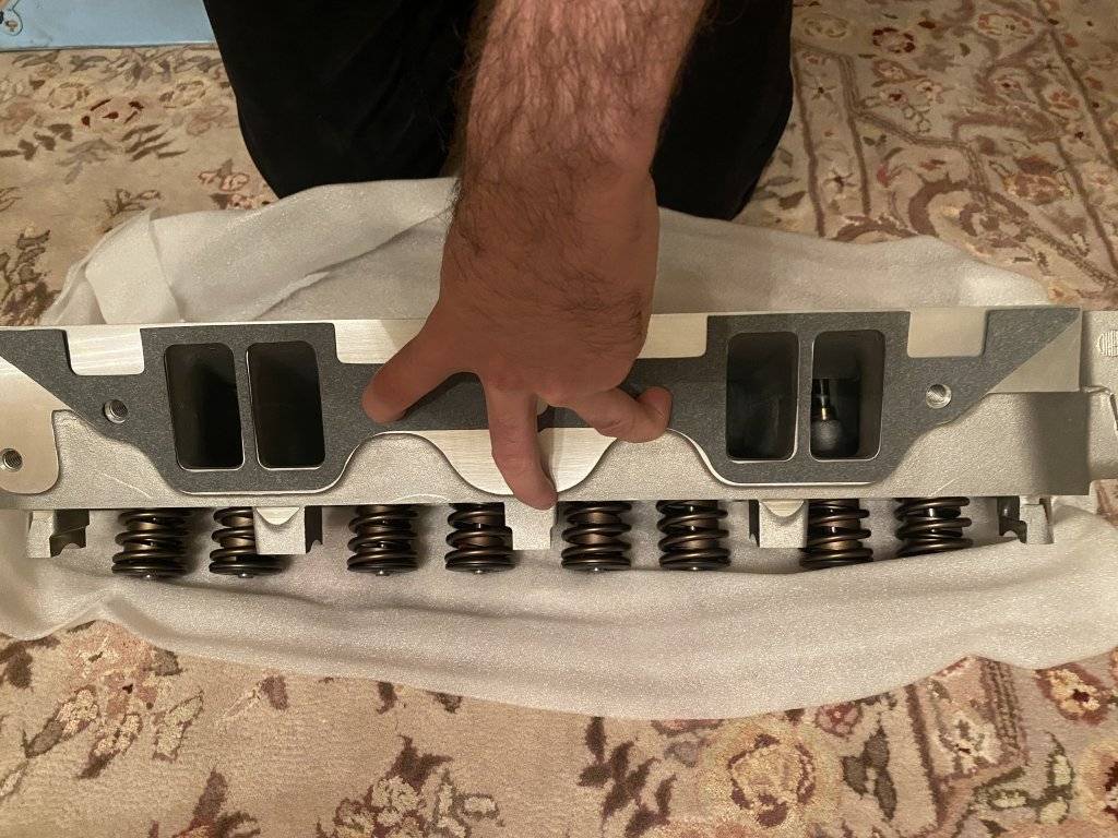

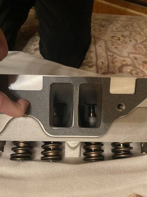

Really impressed with the casting tolerances on the 440 source head. Very close to the ideal, won't need much touching up to gasket match. Might need to open up the pushrod clearances though.

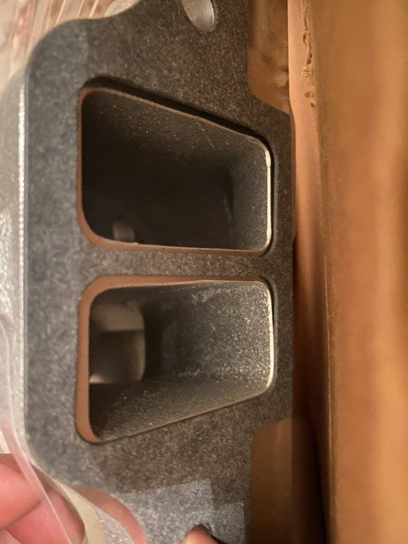

Less impressed with the Edelbrock manifold.

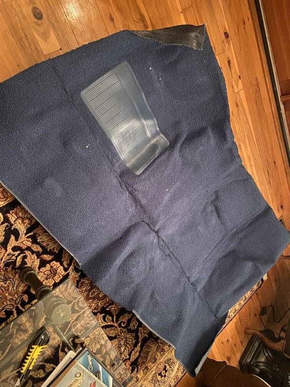

Also bought the carpet and radio from Retro Manufacturing, because who knows what's going to go on with the tarriffs.

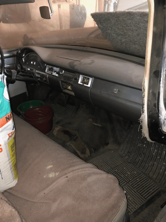

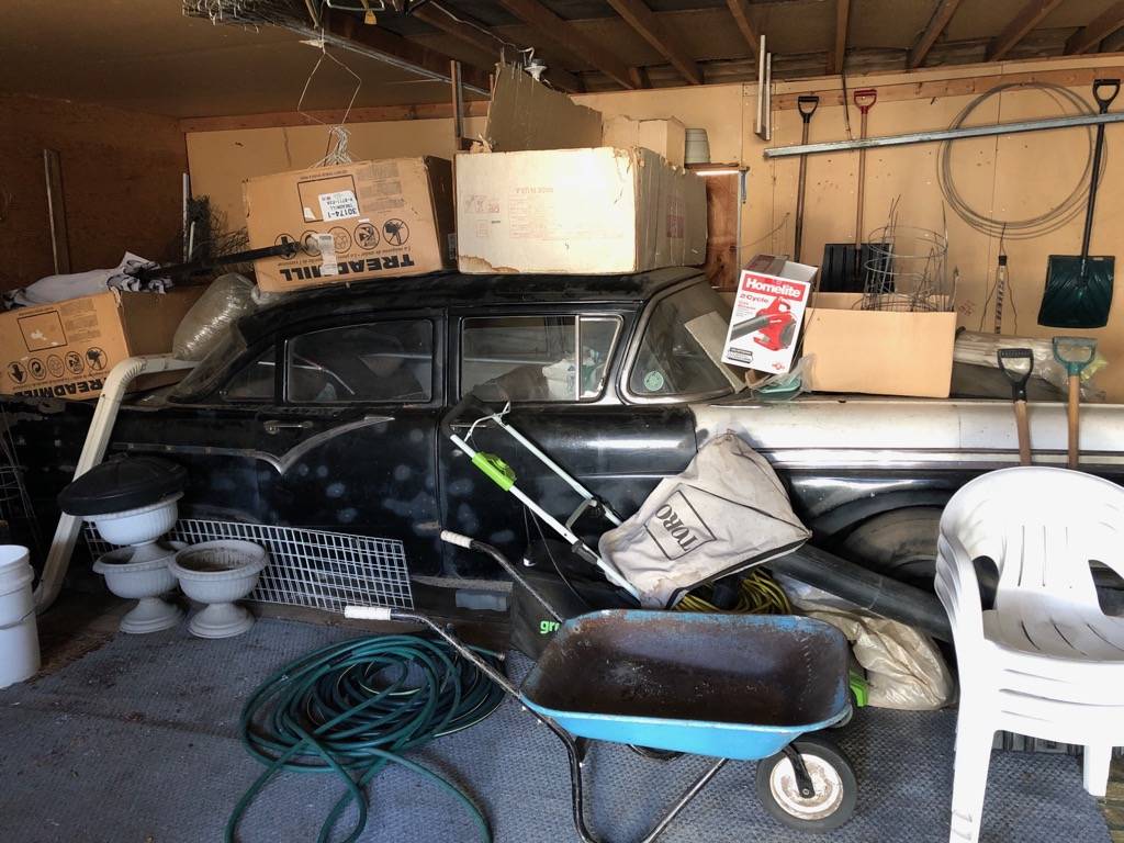

I inherited my dad's uncle's 1957 Mercury/Ford Meteor. A werido canadian basemodel ford sedan that was gussied up to sell at mercury dealers.
The car is a total disaster, but I've always wanted a Kustom, and to learn to chop a car. If I don't take this thing it's going to scrap, so what the hell. Perfect car to learn on.

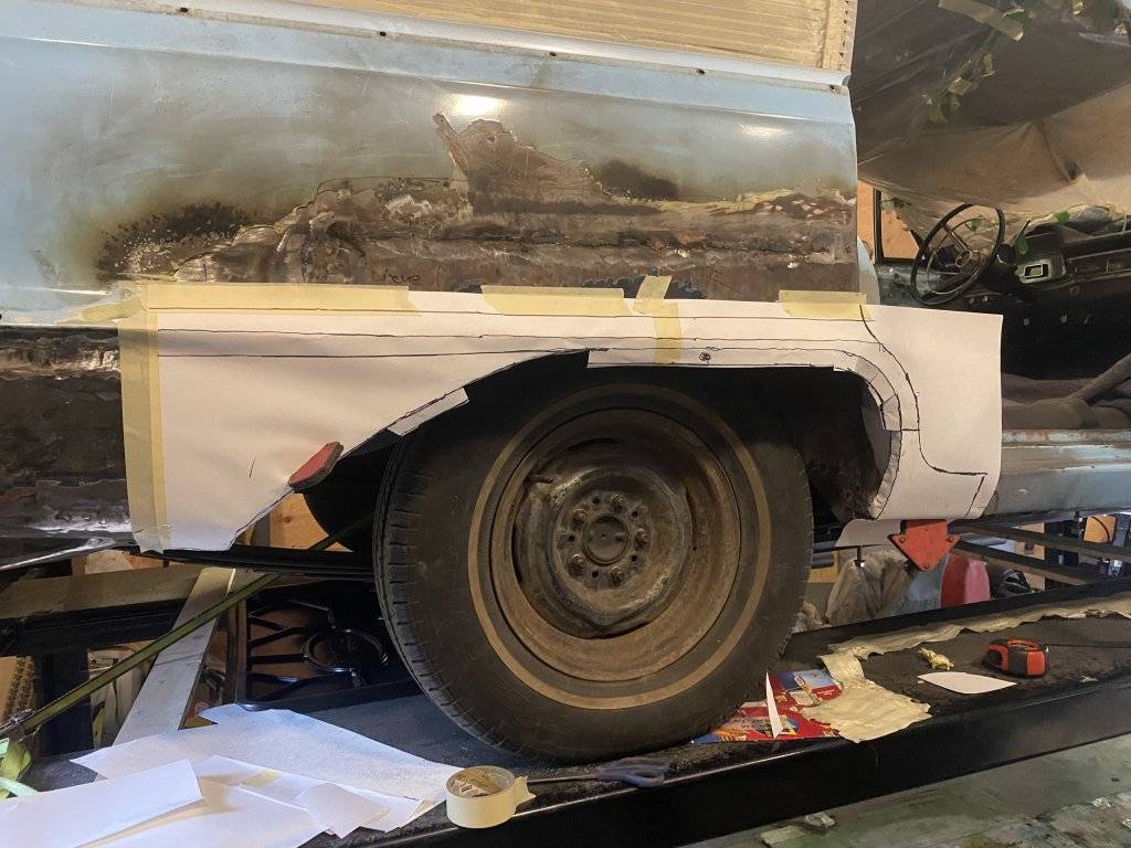

Drew up a concept drawing for it. 1958 Hood, two tone black and gold. Airbags, channel it slightly to get the rockers lower than the frame etc. I also want larger fins, tempted to buy some 58 DeSoto tail lights and fab some long low and straight fins off of them, get some of Harley Earl's design language in there. But DeSoto lights are like 1000 bucks for a bad pair so iunno. 57 Fords also have a problem where the front bumper is miles taller than the rocker, so I was hunting around for a taller bumper with horozontal lines and a negative space in the middle to frame the V in the grille. 1959 DeSoto bumper is the best candidate but is also pretty busy. Not sure on that either.
I want to do about a 4" chop. I'll have to quarter the roof around the B pillar and move the rear rearward, front forewards and widen it in the middle. I figure i'll weld some angle iron in there with slots cut into it, and bolt it up square before cutting it. That way I can just open it up along those tangents and it'll stay square. Glass is all ****** and needs replacing anyway. JR Imports carries all laminiated glass that can be cut down for a chop.
For power I have a Jaguar v12 with race cams lying around. Found some squarebore intake manifolds for it. Dual quad v12 Meteor, why not?

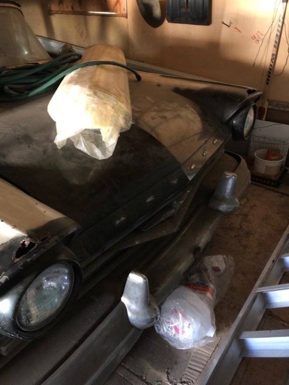

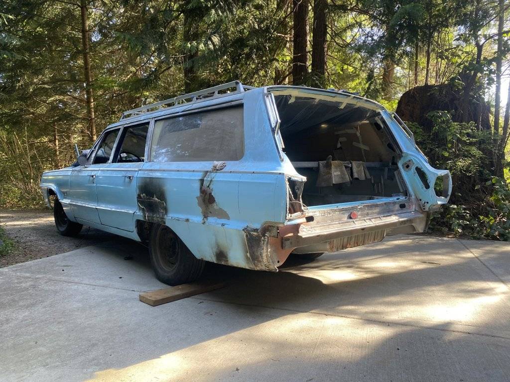

Welcome for Georgia! First get a ballast resistor for the car if it has the points still in it. If it has electronic you should be ok. We here are working on a 65 Chrysler wagon. Some parts are the same from 65 to 68. Tail lights are hard to find. Wagon only part. 66 and up is a good range. 65 has many older parts/systems in it.

Yeah that's basically what I have in mind to do.
Was tempted to chop my 48 ford but the entire roof is nothing but compound curves. Notoriously difficult.
After doing some photochopping of the DeSoto and Lincoln bumpers, I like both but I think the shape language of the Lincoln is the better pick.
What do y'all think?
