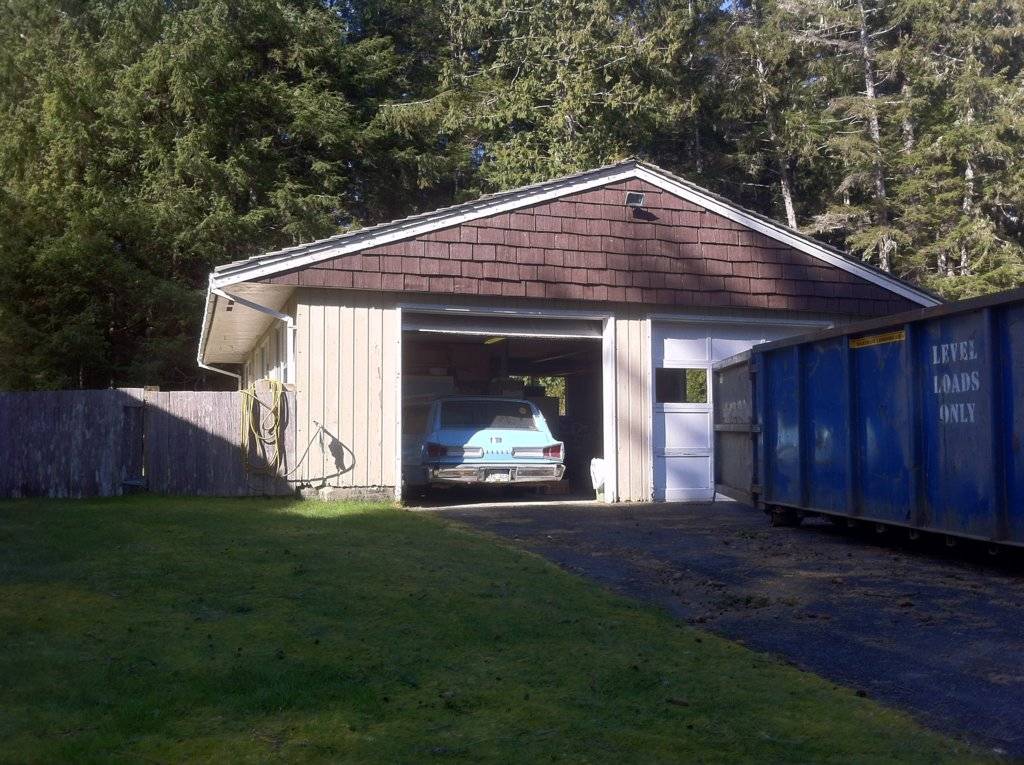

Alright, heading out tomorrow to pick her up. Property's been sold so it's now or never. Napa guy was real nice and had all the parts i might need shipped up, even though i won't buy all of it. U joints were 40 bucks each. Blimey.
There's also lots of furniture to take home so the whole wagon thing is gonna be handy.

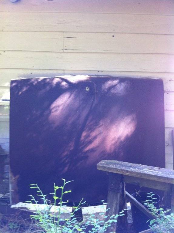

Also, I know there's a spare set of doors from one side, and a hood sitting around the property. Would anyone be interested in these? Anyone's guess as to their condition.
If nobody's interested, if i can't strap them to the roof rack they're probably going to go to the scrappers or continue languishing behind the shed.

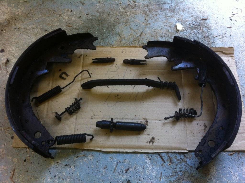

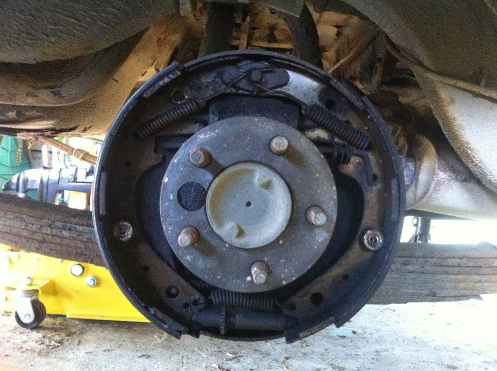

Firstly, i feel like there should be a cable link to the self adjuster on the rear drum. Nothing on either side.
Did the full pull. Lube, oil, plugs, rebuilt the drums, new fuel filter (inline with the fuel pump in the bay) etc.

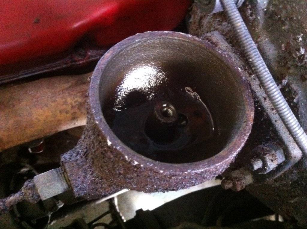

I think the belts are done, i don't think the water pump is turning and it sounds like a burnout every time i rev it in neutral. Also has a weird misfire occasionally but that's it. Is the power steering belt supposed to rub the water pump pulley? I feel like that's wrong.

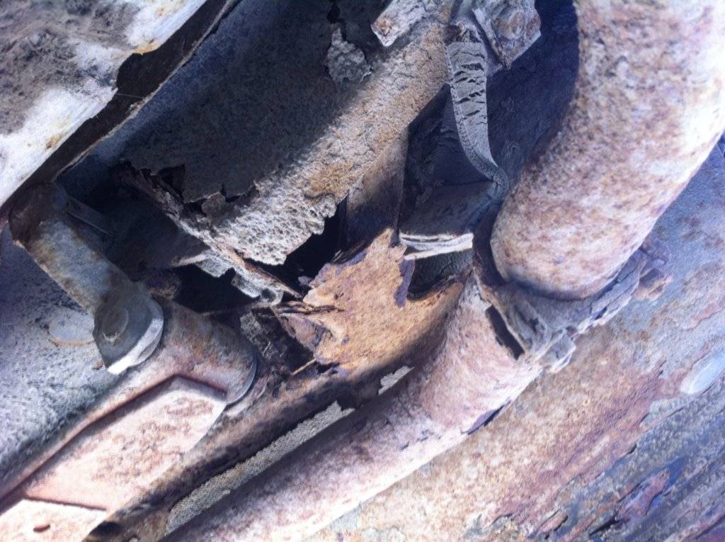

However it's got some serious *** cancer. Front end is solid, rear is not. It's safe to drive home but i'm not at liberty to go do doughnuts in a parking lot or something. Going to baby it home and figure out what to do.
Speak now about that hood and doors, it's actually pretty ok. Little wire brush and she's fine.
You don’t think the water pump is turning? Have you been able to watch it while it is running? Very crusty out back!:(

The pump turns but the belts are slipping terribly. I took it around the block up to about 50mph in 2 degree weather. When it got back the radiator felt very warm. Too warm to touch and too warm for such a mild outing i think.
My suspicion is that the belts are slipping so much the pump isnt effectively turning, and not pumping water sufficiently. My Jaguar has that problem at low rpm in bumper to bumper traffic, where it simply isn't getting the water through the motor. Not due to belt slip but low idle and a big pump.
Rad looks fine, no build up or crap in there at all, so i don't think it's that.

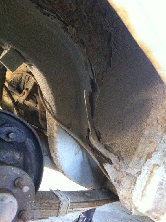

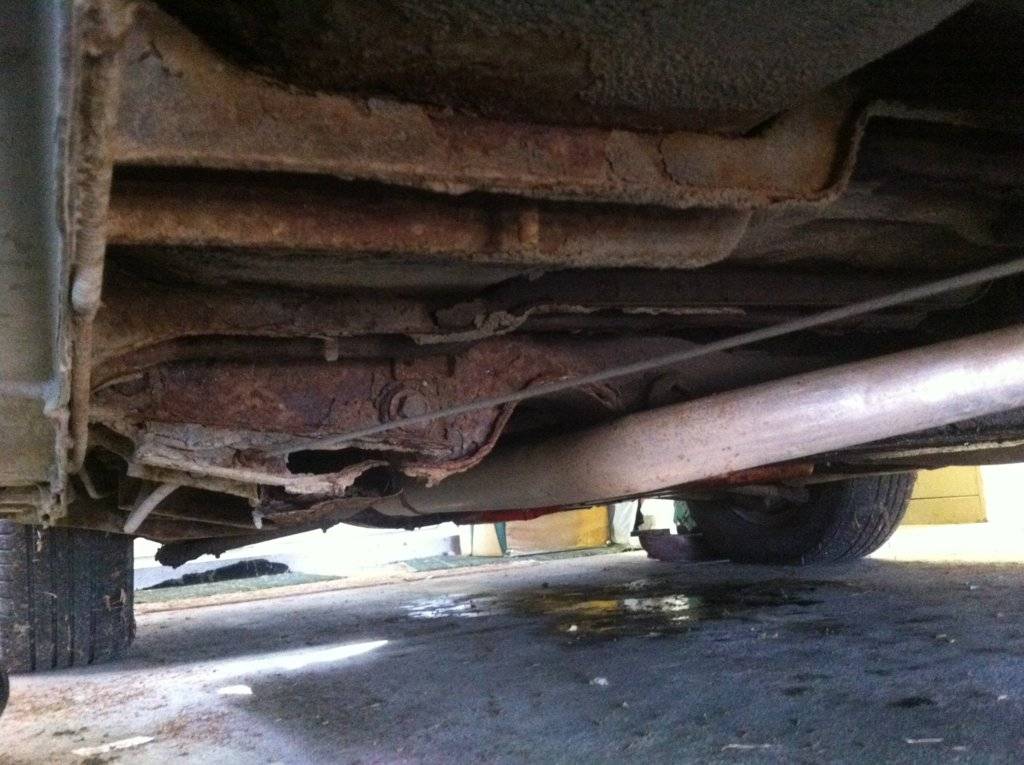

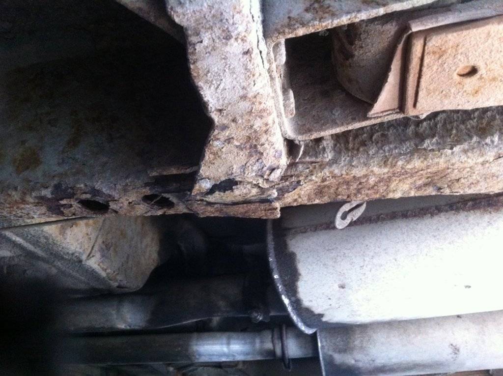

My only fear now is the structure in the rear. Bringing home a bunch of junk from the estate, which is quite a load and I dread bottoming out on a big dip on the highway and ripping the rear end out of the car. It's not likely but it's not impossible.
The the frame rust at the rear spring shackle,I personally would not put any load in the car. In fact,I would not drive it until it gets repaired.
There is a potential for the spring to go through the floor.
I would float the car just as a precaution.
But that is just my personal opinion.
Unless it is not as bad as it looks in the pictures.
Good luck with the move.
Cheers
I know but i'm 500km from home with no trailer and zero access to one. The property's sold and it's gotta be cleared by the end of the week. I really have no other option.
Gonna put the light stuff in it, heavy stuff in the support vehicle andbaby it like hell on the way back.

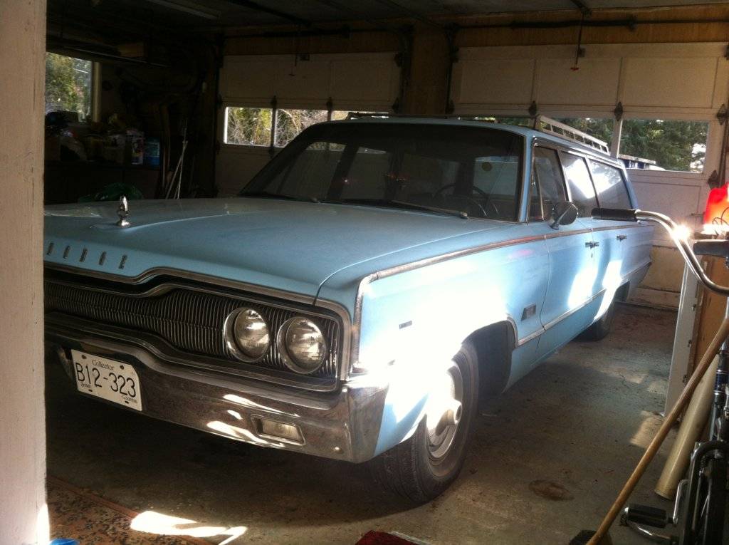

It is a Polara 880 wagon, and the woodgrain has been removed. Very nice car. Congratulations!
The Canadian Polara 880 did not come with the woodgrain overlay (23-23-13), or the overlay in the section of the tailgate that gave the impression of a red lens (23-54-2).
If you check the Canadian parts catalogue all the overlay pieces (pg 23-116 and 23-117) are labeled "OVERLAY, [area piece is meant for] (U.S. BUILT). The parts are listed on page 23-117 in the section labelled "Parts Not Specified In Picture".
For 1967 the Polara 880 became the Monaco, and it did have the woodgrain, same as the U.S. Monaco.

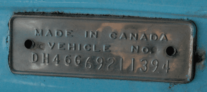

Found a serial number. Is there anything to decode here or is that all on the info sticker in the door
The serial number is what you need to register the car -
DH46G69 211394
D - Dodge
H - Polara 880
4 - 4 door
6 - 2 seat wagon
G - Engine - 383 V8
6 - Model Year - 1966
9 - Assembly plant - Windsor, ON
211394 - Sequential Production Number - 11,394th 1966 model car built at the Windsor plant. Other car lines built as Windsor were Plymouth Fury, Chrysler, Valiant (all for Canadian market) and Dodge Dart (US market). Windsor plant started at 200001 in 1966.

Jam some wood between the rear spring shackle and floor pan just in case.
I nickname the wagon "wedgewood" LOL!!!
Even if does not have fake woodgrain but has real wood wedged in the rear frame,LOL!! :D

X2 regarding reinforcing the rusted out rear spring mounts before driving it. Don't tempt fate.
Those are manual adjusters. No cable.
Most likely the squealing is coming from the belt slipping on the alternator pulley. Not surprising... especially if the battery is down a little. It will be worse with the lights on.
Tighten belts, use some beeswax or commercially available belt dressing. However, I suggest that you loosen them off first enough to spin the components by hand to check for resistance. You'll know if the alternater or water pimp or power steering pump is bad and you can replace them before you hit the road.
Likely the water pump should be replaced as a matter of course anyhow once you get home.
