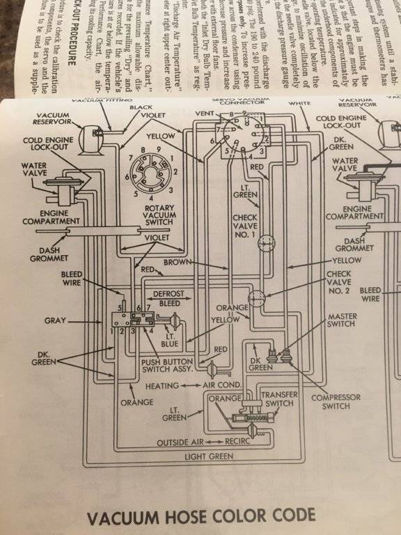

today I’m going to just puzzle work on the ATC a bit.
Here’s what is happening:
I push off and blower goes off. I don’t hear any of the vacuum motors reset.
I push in vent and I get air out of the heating vents on the floor.
I push low or high auto heat and the fan does change speeds.
Same with low or high auto cool.
I push Defrost and the damper works and I get defrost.
What works and first checks:
As the car warms up the air gets warmer. There is no vacuum to water valve. Need to put it on heat to see if vacuum reaches the valve.
Vacuum seems to be getting to the dash switch.
Vacuum may not be getting to the servo.
Also need to check that main power to the servo and amplifier are present.
Power is reaching the blower
Power is getting to the compressor.
The only white line is coming off the servo to the transfer switch. Nowhere near where I found the line by the accelerator pedal.

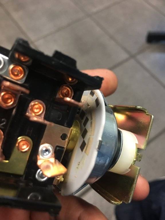

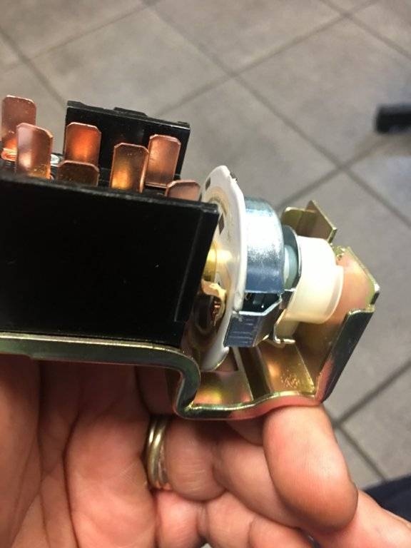

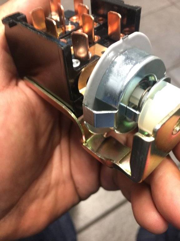

Got the headlights switch today and see that the dimmer portion design is now electronic rather than the more familiar wound resister wire coil.

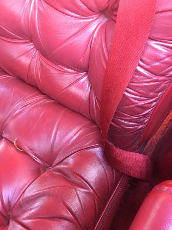

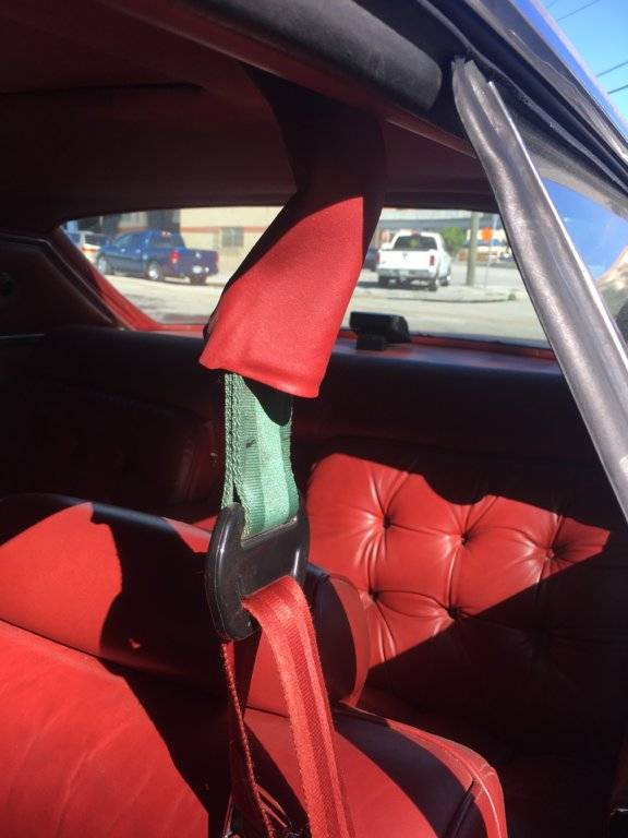

Previous owner extended the drivers side front seatbelt upper strap.

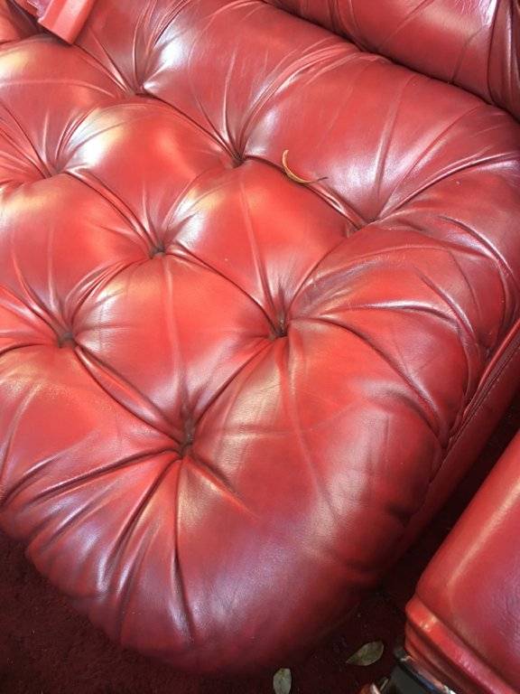

Interior leather is very dirty but otherwise pristine and still very supple throughout

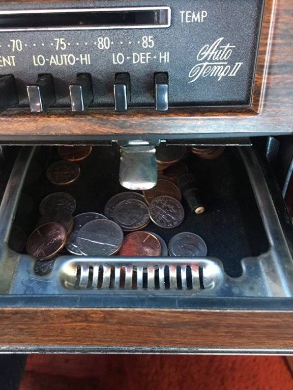

Ashtray is full of coins but otherwise never used as is the driver’s lighter.
