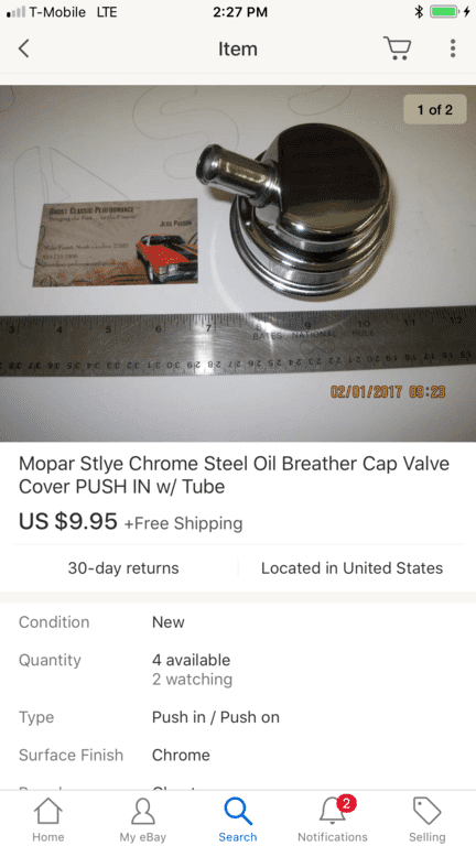

With the cost of “correct” Breather caps as much as $59 bucks.... went with this:

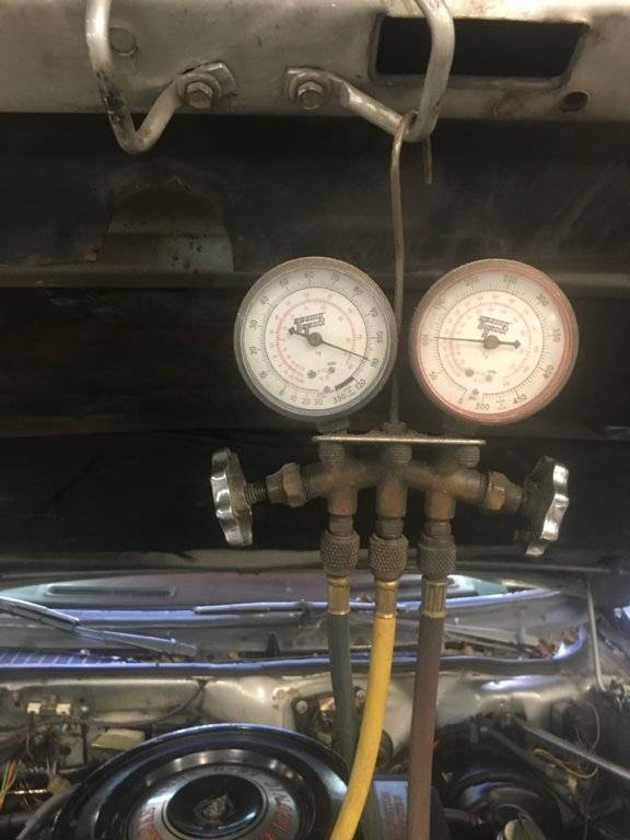

Vacuum tested the A/C system and it held so I dumped two cans of Freon into it.
Bad: Compressor sucked it down kind of slow but got it to 19 lbs before is started acting funny. I’m thinking it has one of those funny intake regulatory valves in the head that may be bad or the compressor just gave up the ghost. Either way it sucks (or in this case doesn’t suck enough). Went to put in the next 12 oz. of freon and the needle on the suction (low) side popped up which is normal. The abnormal part is it stopped sucking the can. When I closed off the line to the can it just stayed at 100. High side stayed at 130 which is fine since it is so low on gas. Then, after about a minute, the low side gauge started dropping in bounced steps down to 22 lbs holding the high now at 150.
Also, this car has the worlds smallest dryer which looks to be partially plugged. Temp accross it drops 40 degrees at least. So I’m going to need to evacuate the system, flush it, and replace the dryer and probably change the compressor.
My diagnosis is that starting it up has kicked up what ever minor debris into that teeny tiny dryer and the EPR valve in the compressor is closing off the intake because it is failing.
I’m going to leave it charged over night to see if EPR valve goes back to working. I’ve seen it happen before on systems that have been low for a long time where the valve just needs time to recharge. If not, it’s clogged.

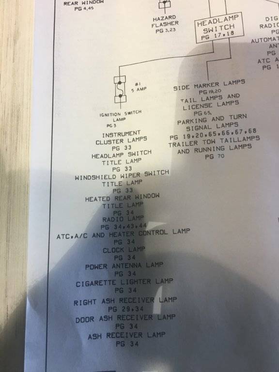

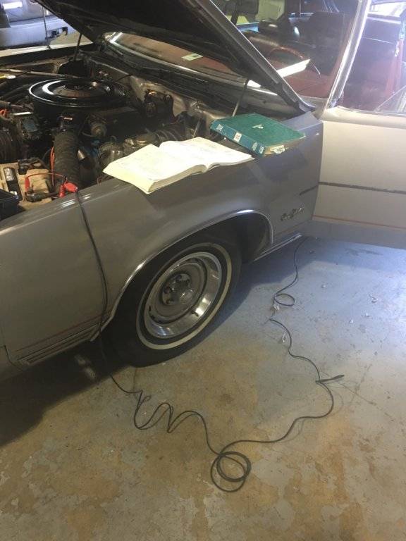

Started the Investigation of the dash lights.
Started by looking into the FSM. It calls out the circuit as #1 on the fuse panel and fed from the switch. Fuse was good but no power. Head lights and running lights all work.
If I put power to the circuit the dash and clock lights come on so it’s got to be the switch. Next parts order.... got tired and went home after late lunch
Started by getting the FSM Manual and looking for the circuit that tigress the dash lights. Hooked up my tester and it was off to the races.
Dash lights power comes through the switch before getting to the fuse panel. Fuse was good but no power to the panel. Either switch is bad or the contact/plugs are loose. Either way, I’m digging into the dash for this one.

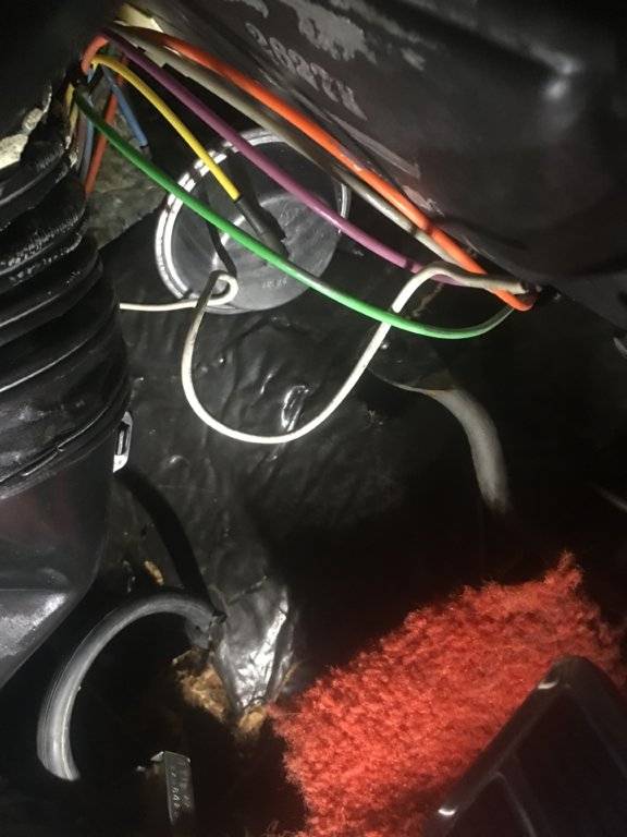

Man is it tight down there!!!!! Found the fuse box but to my surprise, also found one of the ATC lines tied up around the rest of them. Hmmmm more research tonight.

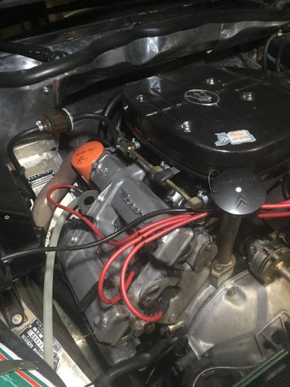

Since I went home early, I took a short nap as no one was home and it was quiet. Had been meaning to change the fuel rail on the Citroën and you can see why. I found a good used one and just got it back from cad plating.
Ok..... so it’s not my NYB but don’t she look purtty with the new bling? You think working on the NYB is hard. This little bit of work took me two hours.
