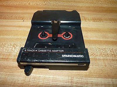

No, just a good old fashioned adapter you plug in to phone, iPod, mp3 player.Does it come with Bluetooth?

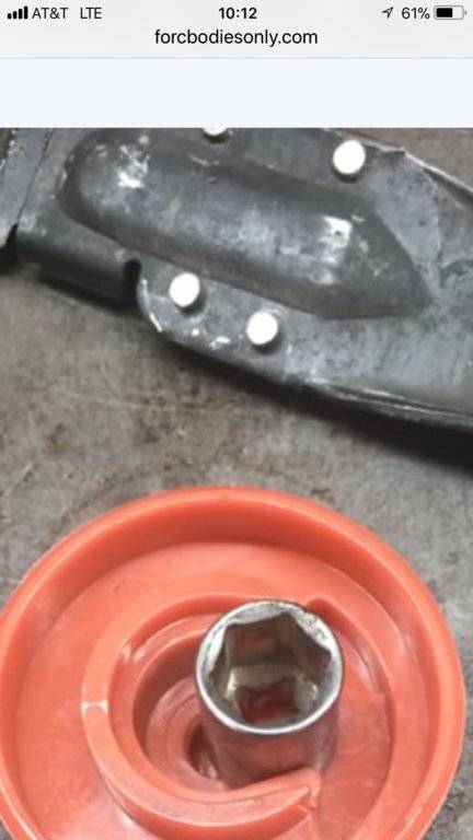

John, this only applies to the 1978 Formals. So unless you've bought something I don't know about, you're safe. The cam for the 78 wiper set up is one big reason why we pick on even the nice ones.When you say “modified” are you speaking of the rivets? View attachment 173822 If so what was modified? I ask only because I have my wiper arms out as well to replace all the Teflon bushings that have dry rotted.. should I look for anything in particular? Thx

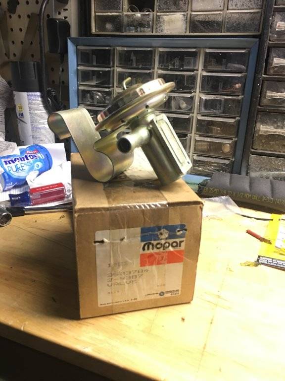

I've not seen one that was missing the cover with the vacuum nipples... seems weird to not have that included.Came in last night but missed it until early this morning. First thing when I get back.
Excellent eye, Jeff!!I've not seen one that was missing the cover with the vacuum nipples... seems weird to not have that included.

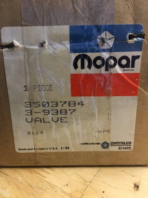

They are actually separate parts.
FSM describes the need to transfer thermal switch vacuum valve in replacement of the valve.

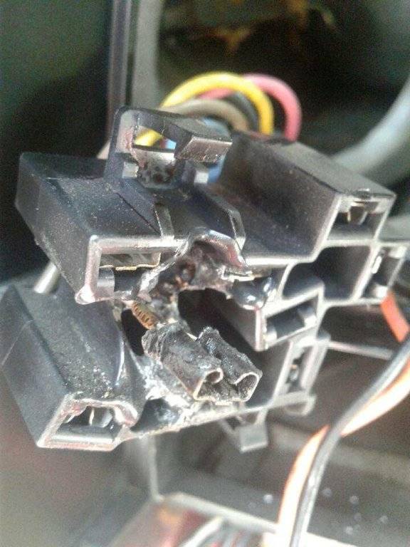

We have a short somewhere in the light circuit for the headlights.
