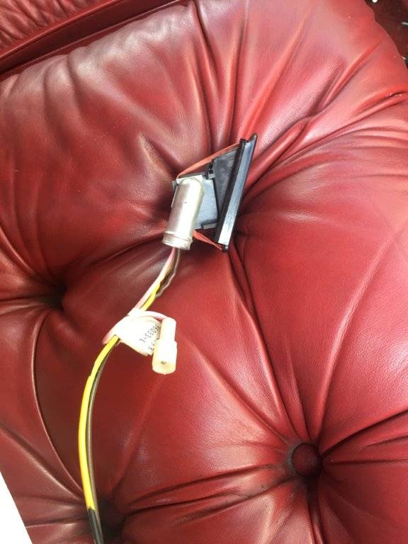

I took the switch for the antenna home as the back was loose.

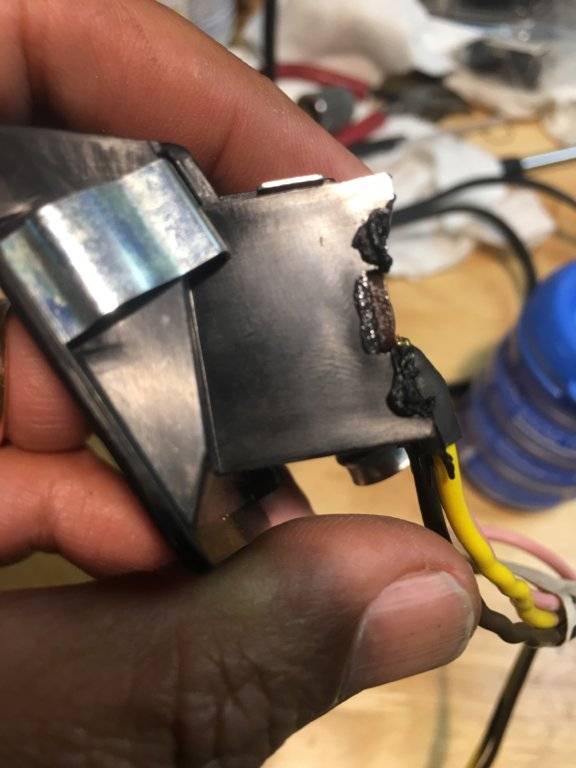

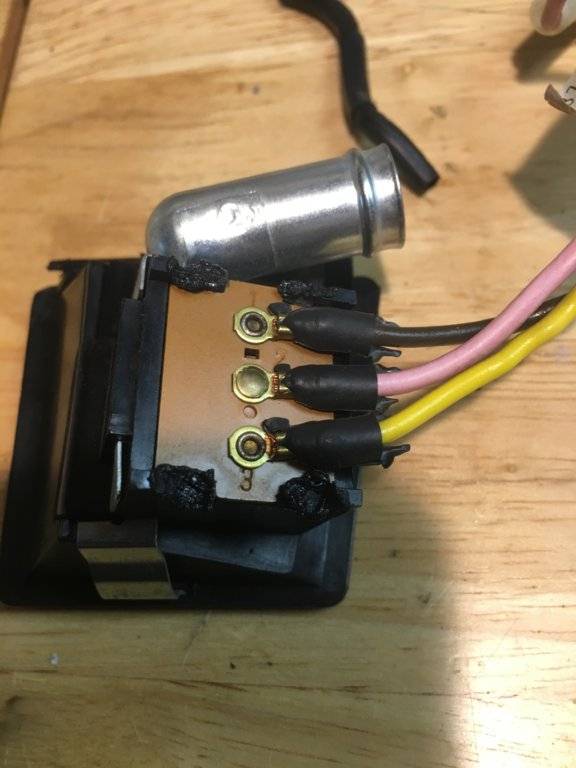

The back of the switch was loose so I took the opportunity and opened it up to clean the contacts. I also replaced the spring with one I took from a clicker pen. Much stronger.
I set the back of the switch with a little super glue. Then I melted over the plastic tabs with my soldering gun.
Good to go and very snappy!
Calling Murray Park tomorrow for the light switch plug.
I was wondering if that was available... sorry to hear the bad news. More importantly, did you find the short? You don't want to burn two of them (or the car).

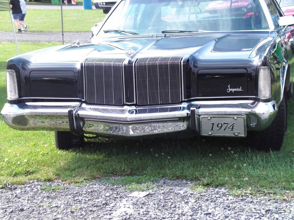

You could try something like this... but I still fielded the question "what year is it?" every time I was near the car... Plus one fine young lady complaining to her companion about a caddy at a Mopar show :realcrazy:
I took my bracket right of when I got mine years ago. They look so much nicer and symmetrical without them, as most cars do.
No offense Jeff. It's just me...
With the mounting hole and insert present, I wanted to finish the look... if it wasn't there, I'd have left it.
