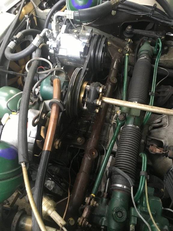

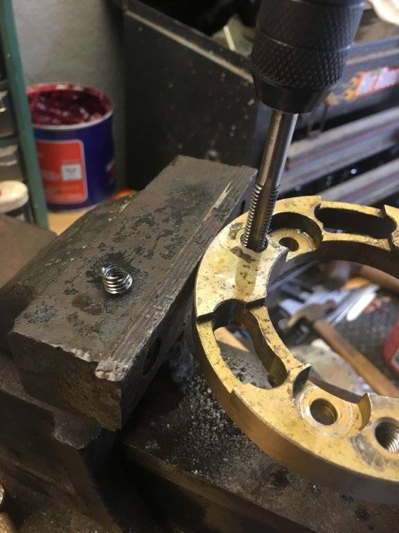

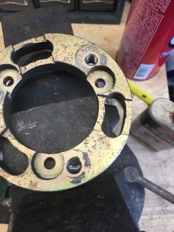

Had to repair a broken bolt on the power takeoff coupling on the Citroën SM. Sucker sheared off leaving part of the bolt in the accessory drive wheel adapter which I would have to extract. So....I just got down to business and got to it. I knew it would be a pain in the *** to do and I was right.
My friend Dave Hume in Kentucky sent over a replacement set of bolts for me to use. We trade parts and stories.... great guy. He’s the Regional expert on Citroën’s and Maseratis in the SE.

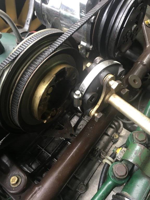

Power coupling detached. Similar to BMW and Mercedes drive shaft couplings. Bolts to the adapter neck down to form shoulders to sit flat on the plate. I use two hose clamps to pre-load the rubber coupling in order to remove and insert the bolts in their proper alignment.

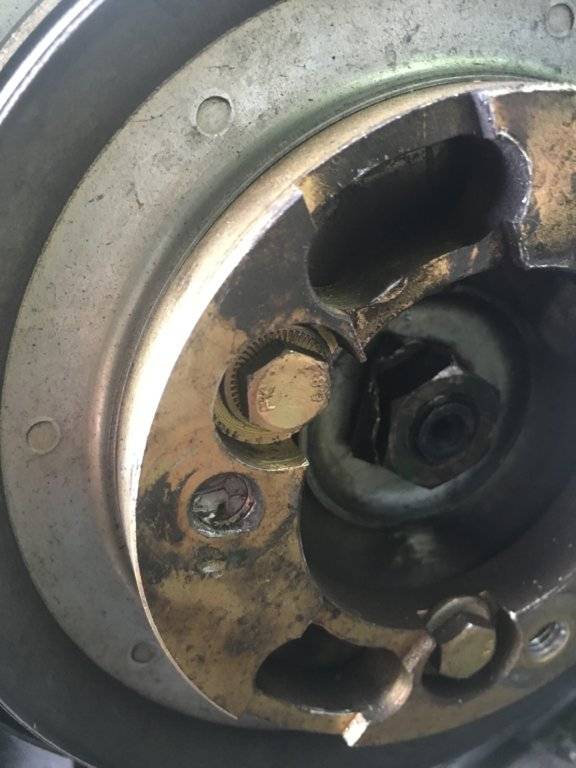

Close up of what happens if the bolt comes lose... it starts to wobble off the plate and fatigue shears it right off.
Tried a bolt extractor kit I had... no go
Ended up carefully drilling the bolt out and then.....
Using a tap to catch it and thread it through. That’s not a helicoil on the vice... that’s the threads of the sheared bolt.
3 hours later.., all done.
