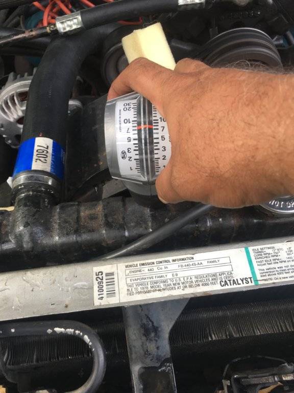

Air flow.

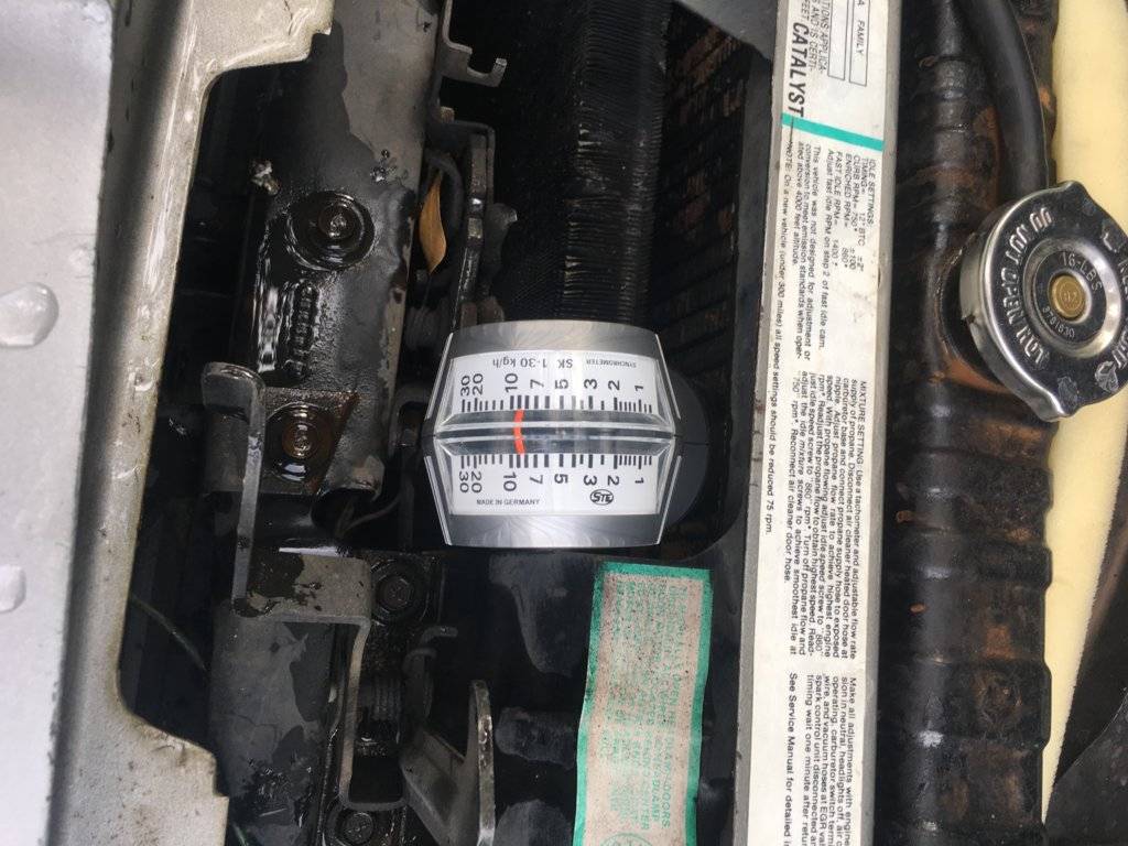

Guage measurement:
at gap 10 kg/hr, or 22lbs/hr.
Guage opening at gap:
3/4” x1.5”= 1,125 sq.in.
Gap area measures
3/4”x 27” = 20.25 sq.in.
Total mass is of air going through gap =
Mass of measured air flow at gap area x gap area divided by area of adgested measurement.
22lbs x 20.25 sq.in./1.125sq.in. = 396lbs/hr
Radiator opening measured 26” x 18” = 468 sq.in.
Measurement at guage at radiator was a little less at 9kg/hr or 19.8lbs/hr.
Guage opening was 1.5 diameter circle. Area of circle is pi r squared or 3.14x .75” x.75” = 1.77 sq.in.
Doing the same as above to calculate the mass/hr going through the radiator and we get 5235.25 lbs/hr
Comparatively, the gap accounts for approximately 7% of the total air volume. I would call that significant but not critical.

You're correct. I did mention that to Jav and he assured me all the shields were in place.
When he mentioned the gap, I said fix the gap. So what does he do?
Drags out his sliderule...

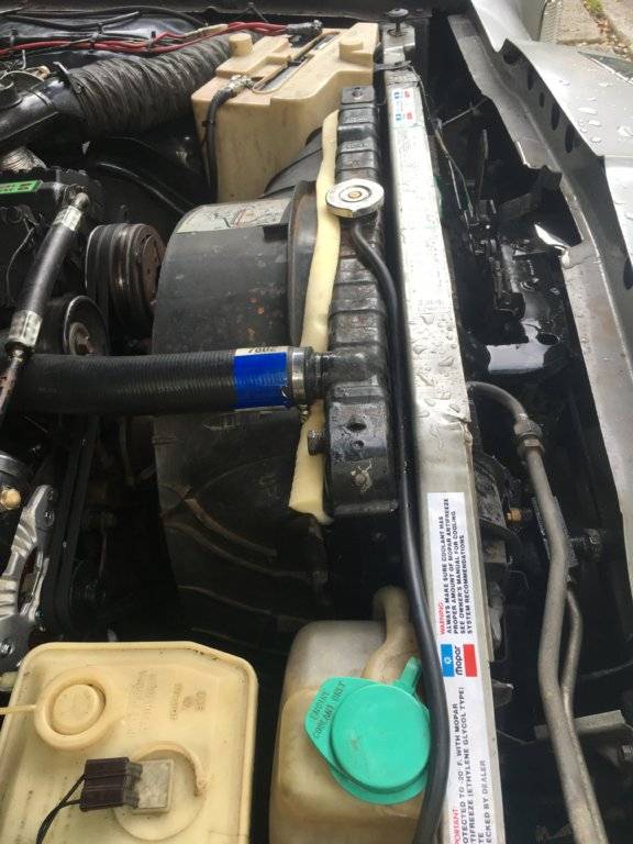

temporary foam fill looks like *** but it’s a test. Air coming off fan felt a little warmer. Volume may be the question now. Last nights test run was marginally better. Noticeably slow warming after thermostat opened. But still too high in my opinion.

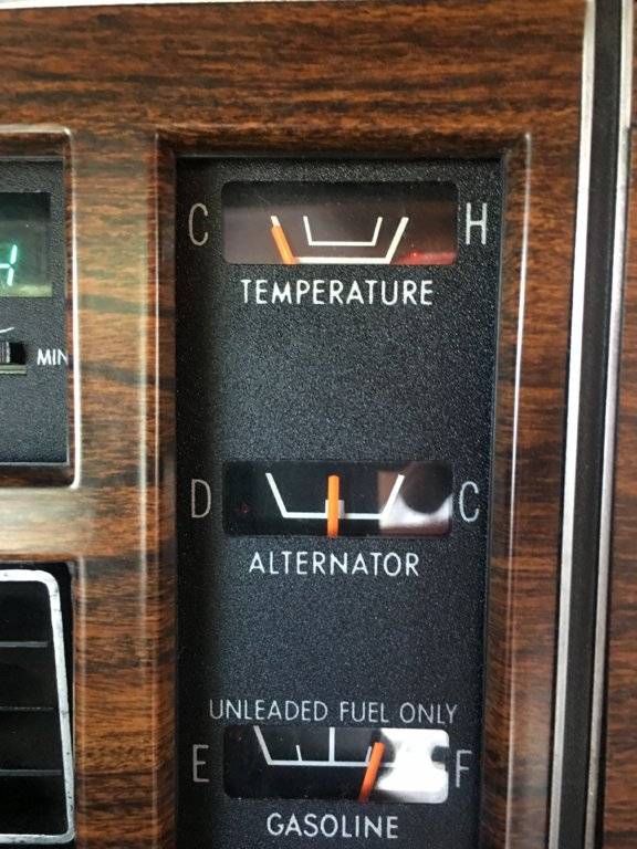

Gauge started at exactly “C”

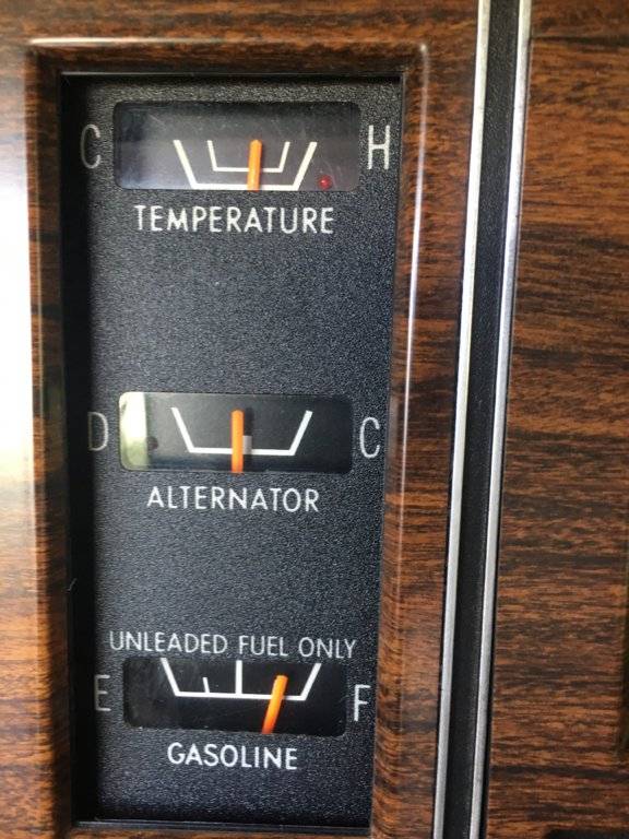

Warm up and apparent thermostat opening.

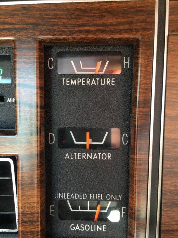

Slow climb to this at arrival.....

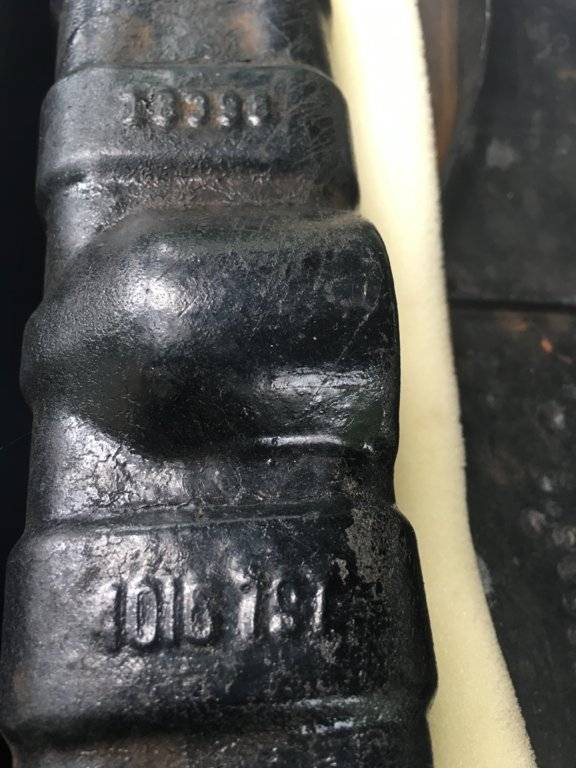

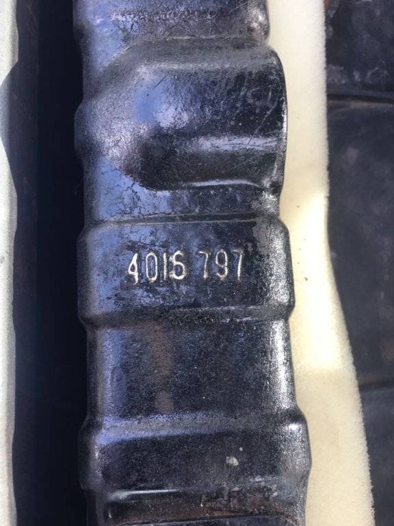

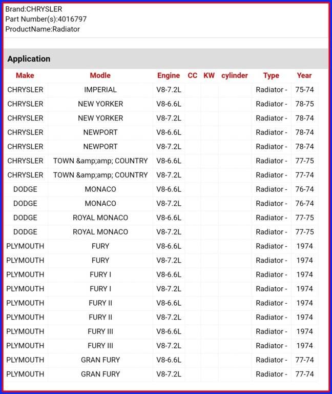

4016797,CHRYSLER 4016797; Radiator
Now give me something difficult....
Thanks Stan... at least I know it’s the correct radiator I’m thinking of tossing out...
