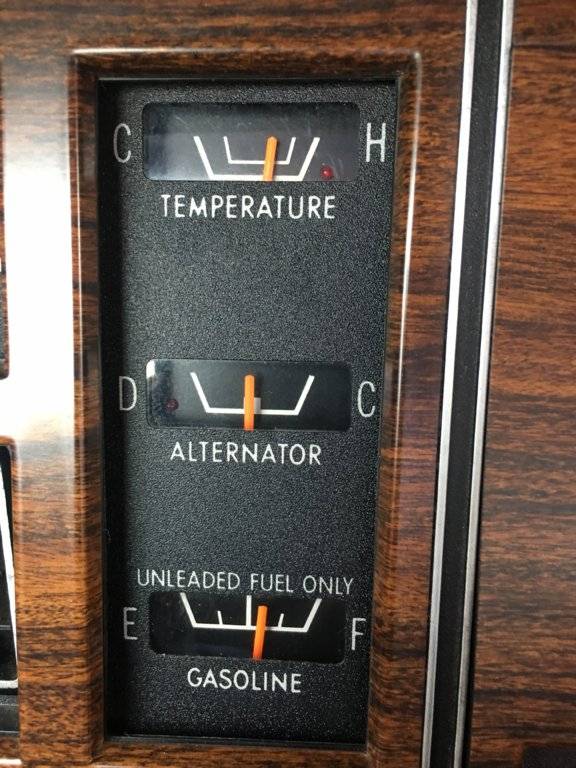

Just a thought, Javier, how do you know that there isn't something wrong with the gauge or sender? Maybe your deliverability issues with the lean burn may also be affected by a bad temp sensor. Does the car vomit/spitup coolant after a hard drive? Do you hear it boiling over like an old fashioned coffee pot? Have you checked it against a real thermometer?

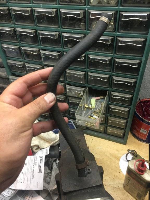

Started smelling gas today .... a lot. Had been sniffing it for the last few days and kept checking the carb for leaks.... not finding anything. Today it came on strong.
Found it...
Hose feeding the pump is absolute mush. Came apart in my hands on the pump end.

If that one's bad, make sure the one back at the tank and the vent hose aren't in the same condition.

Got from the top... the minute I felt the clamps, to knew I was dealing with a 40 year old original.
Used some reflective tape to protect the new line from the radiant heat of the manifold.

Yes it was boiling over a bit. Not crazy but definitely boiling over. Temp with IR thermometer at the top of the tank was 230. Latest after timing change 210.

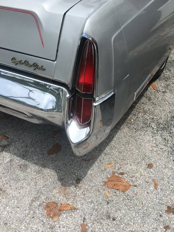

Hit a low stump parallel parking the Nimitz
Hoping it’s just that the shock is stuck. No dent or scratches from the stump.
