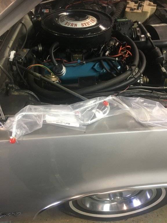

New to me 78 NYB on its way but please Don't tell my wife

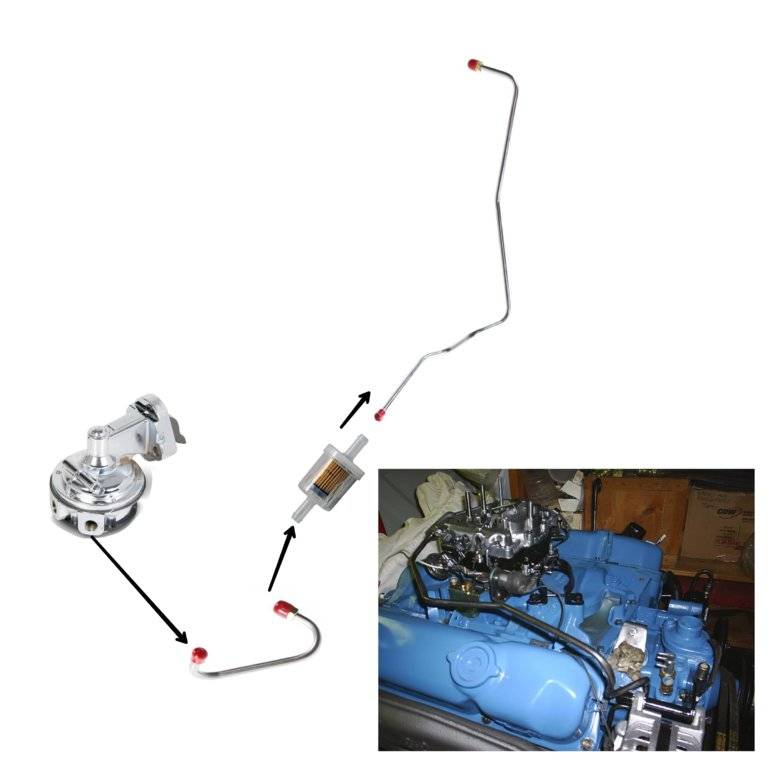

That part of it looks right. It’s the rubber hose in between that looks wrong.
The carburetor feeds from underneath at the center rear. It’s a rubber hose connection. Then the hose goes to a steel line to make a 90 degree turn to the front. From there it goes back to rubber before meeting the steel line coming up between the alternator and the block from the fuel pump.
My other mopars have it all steel.
On my '66 440, there is a break in the line from the fuel pump to the carburetor where an in-line fuel filter is installed. A short piece of rubber line connects the lower steel line from the pump to the filter, and another short piece of rubber line connects the filter to the steel line that goes the rest of the way to the carburetor. Maybe that is the extra setup you found with your car. . .
Rip is correct

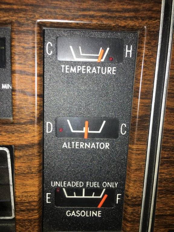

New sender brought new bad news. She’s running warm to hot. This is with only 82 degrees outside. She also warms up very quickly. Not that a quick warm up is a bad thing. Observed the needle climb and stall as the thermostat opened up about the 1/3 mark of normal range where it should have stayed. Needle then continued up to where you see it here.

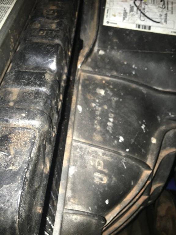

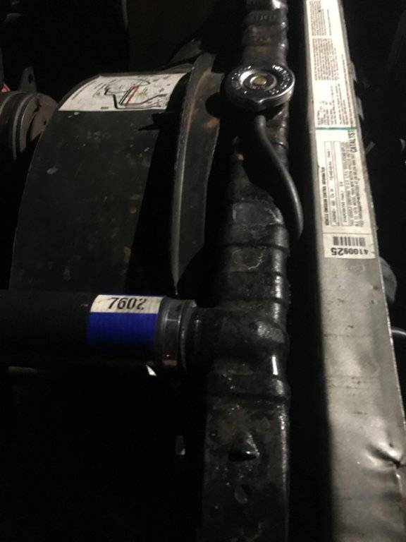

The fan shroud also has quite the gap 3/4” at the top as if it was meant for a larger top tank. The sides are nice and tight. Will check the bottom to see if it has the same gap.
Need to check the part number on the radiator and also see if there was a towing package/optional radiator with 3 row core.
I’ve already installed a new thermostat, a new fan clutch, all new hoses and re-cored the 2 row radiator.
Trying to keep it stock but I’m running out of options. Last option remaining is to fill the gap at the top of the shroud (and possibly the bottom) to see if it makes any difference.
