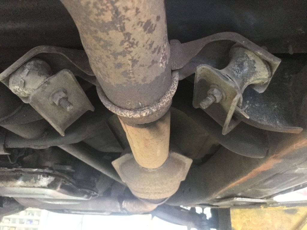

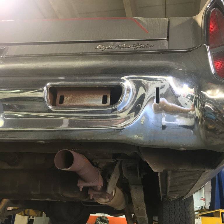

Award for most unique exhaust hanger goes to......

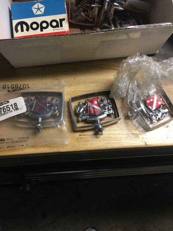

82-89 Chrysler 5th Ave use the same decal. My buddy Kip had new ones made for his at an auto wrap place.BTW, the body color decals on the mirrors and the door handles are a 1978 only option and there isn't any replacements available on the planet. The taillght lens have silver paint piping or pin stripping that was also a 1978 only option.
