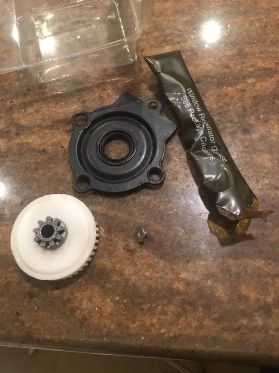

Got a replacement drive gear for the passemger front window motor to get installed tomorrow.

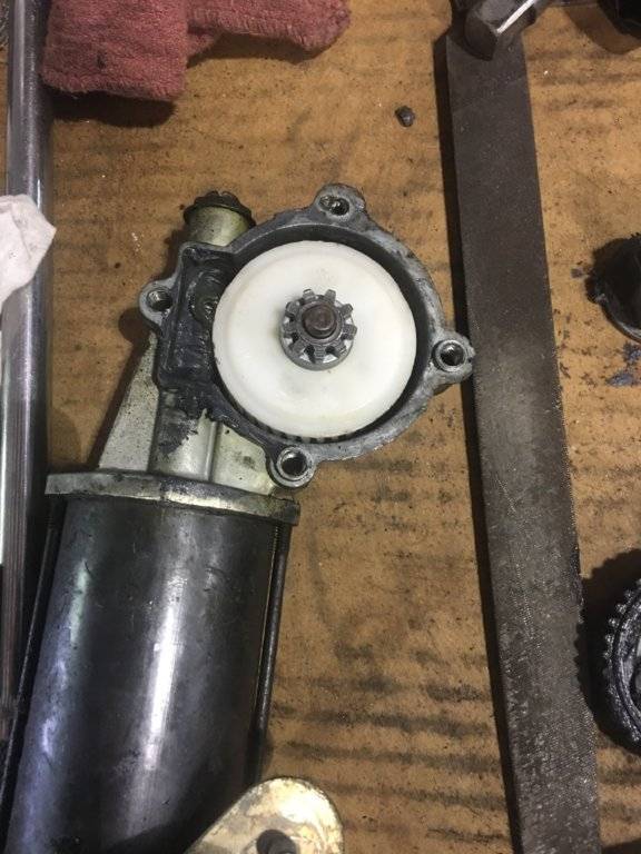

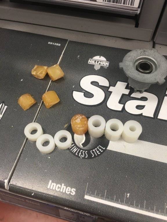

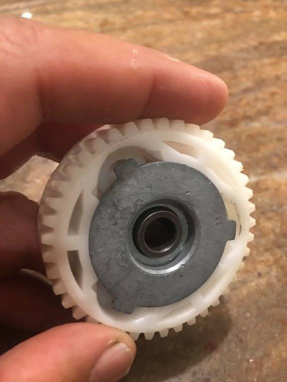

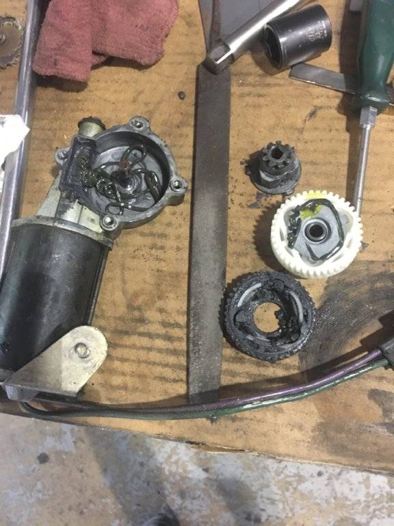

Did a check on the pucks in the replacement power window gear before digging into the door tomorrow and.... in a word.... they were f**ked.

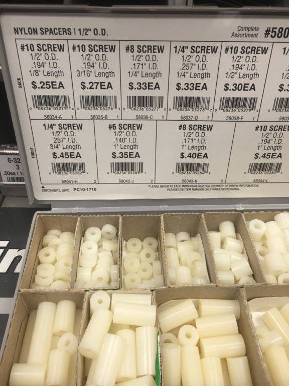

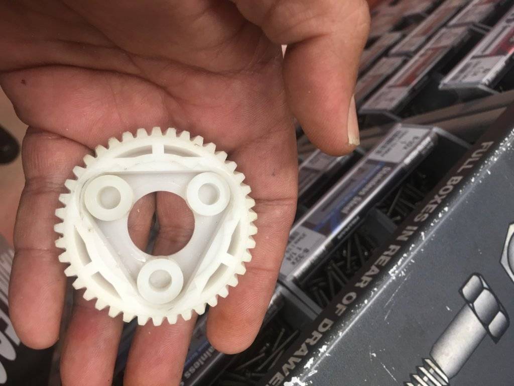

Ran to ACE before they closed to see what I could figure out to McGiver a solution.
Came up with the following solution.
The pucks seam to have been made of the same material as wiper bushings and literally started coming apart all by themselves.
Ended up using the shorter nylon spacers rather than cutting the bigger ones down... call me lazy.
Ended up using the 1/4” screw size interior diameter with 1/2” O.D. 1/4” high.
Nice and snug.
Maybe nylon spacers may last a lifetime....but my luck with anything plastic hasn't worked out.
Mr. C has a thread on FCBO that uses 1/4 x 20 nuts with knocking off the pointy edges on the nuts that will never ever fail again. The only issue with using the steel nuts is that the "metal fabricated pucks" won't fail if some kid gets his head caught in the window. I believe the reason the "OEM pucks" are made out of plastic is that they were engineered to fail if a kid got his head caught in the window.
I guess we can call this the Mr. J window motor gear repair.

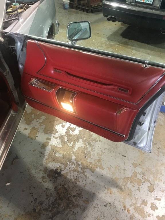

Some 4 hours and one Supreme Court Justice later.... all done and working fine again.

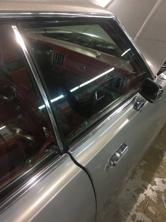

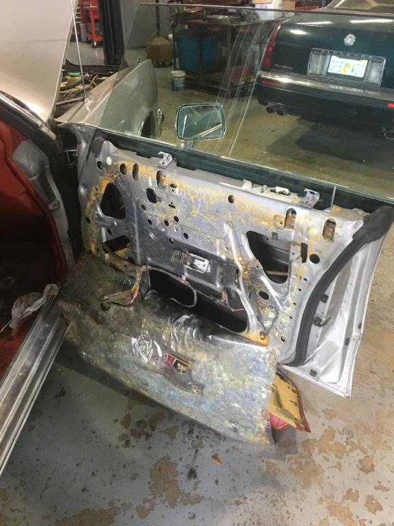

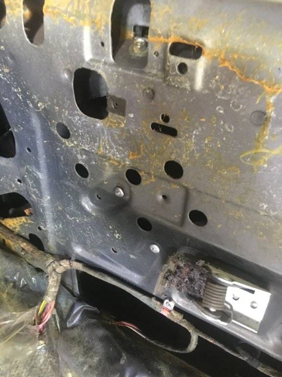

Looky here... they used the damned rivets instead of bolts. As I carefully removed the panels and the water shield underneath, it was obvious to me that I was the first person into this door since it left the factory. One interesting thing I noticed was that the upper nylon push clips for the water shield were installed without going through the water shield.
All clear and ready to go in.

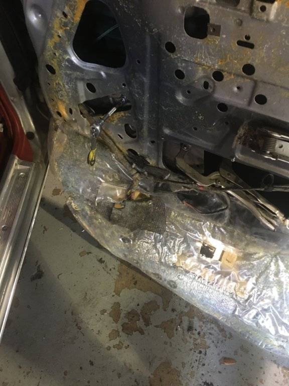

After grinding the stems off the rivets and then drilling them out, I was able to rotate the operating mechanism up to access the motor bolts and set a vice grip I use for body work to hold the gear in place for safety. Window was in full up position when I started and I held it with one hand while rotating the mechanism.

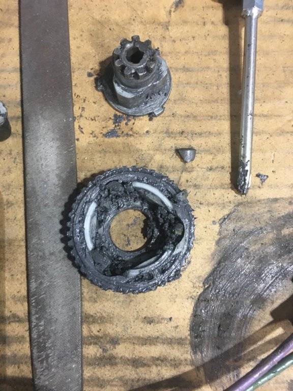

As suspected, the pucks in the drive gear were dust. I get a feeling I’ll be f’ing with similar repairs like this three more times.
Greased up the new gear and installed it into the housing.
Slipped easily in and greased this side before putting cover back on.

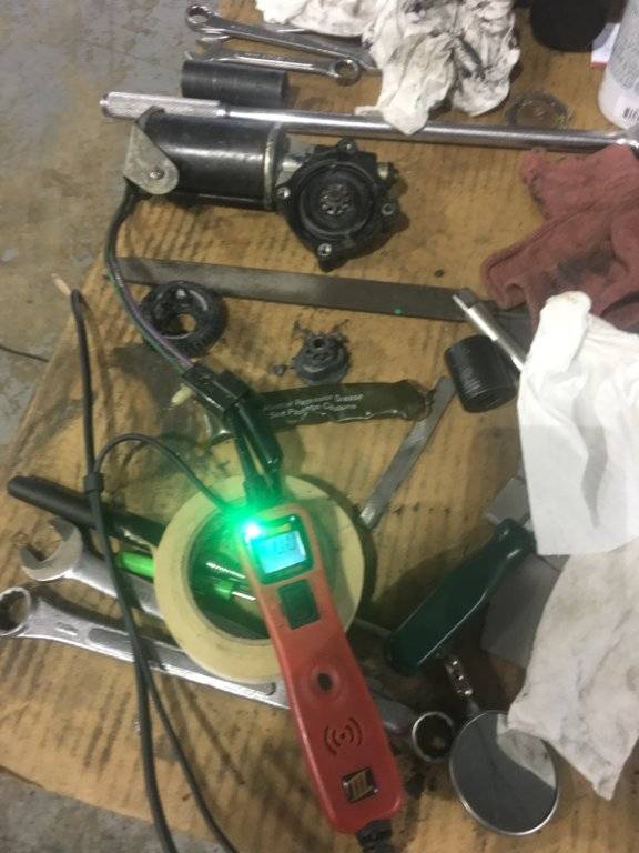

Something I learned from my youngest... test the motor before installing it. She is a robotics champ from high school. Clever kid.
I didn’t mark the adjustment points for the track. So I got the pleasure of re-figuring it out. Should have asked my daughter to help
Took an extra 30 minutes but I got it back to where it was.
All together and all the accessories now working on this door!

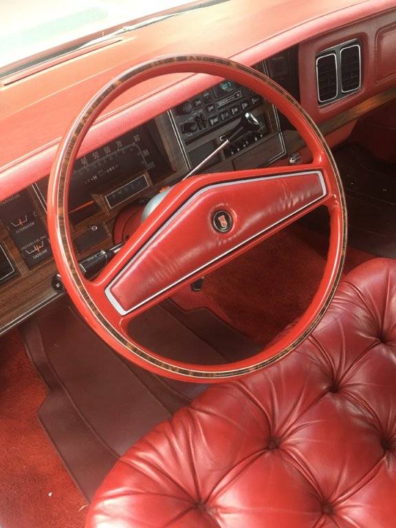

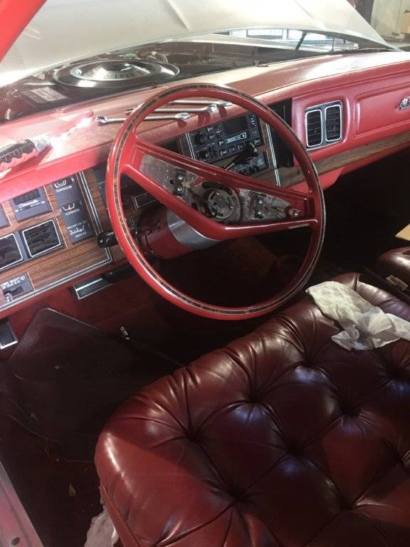

I also finally got a chance to make the swap of the old steering wheel with an NOS wheel I got from Stan..... it really completes and makes the interior.
Pulling the wheel was a a bit of a puzzle. The telescoping mechanism is a bit unfriendly but finally yielded its Chinese metal puzzle secret.
All I can say is.... Wow! And thanks Stan for selling it to me.
It couldn't have been passed on to a more deserving NYB. :thumbsup:
I gotta admit... Wow, that does look great. :wideyed:
Wear cotton gloves, please.
That went to the best home possible... :thumbsup::thumbsup:
Sure glad I didn't try to make it work for one of mine...:steering:

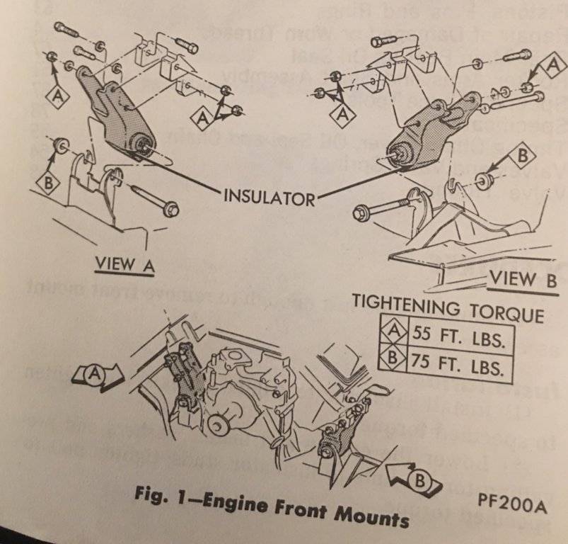

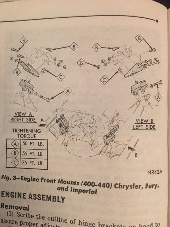

Checked my records and found I had the motor mounts changed in February. But unlike me ‘73 wagon, this ‘78 has spool type mounts similar to my small block.
Getting a minor vibration telegraphing through the frame from the engine. Most of it is from the RV-2 A/C compressor (much more than from my ‘73) The balance seems as if it is from the engine. Need to source to reason.
Here’s a view of the earlier engine mounts.
Yup, Spool vs Biscuit(those Spool mounts debuted in 74 I think). The Biscuit mounts will fail ...especially with a torquey engine. Spool mounts have never failed me.
I put a plastic wrapped chain on the drivers side to limit the acceleration torque movement. Working well for the last 8 years or so on my ‘73.
The spools on the ‘78 were pretty well shot when I got the car.
Oh, the rubber can wear out on the Spool type, but it will never fail and allow the engine to jump out of the mounts. At least I've never seen it.
