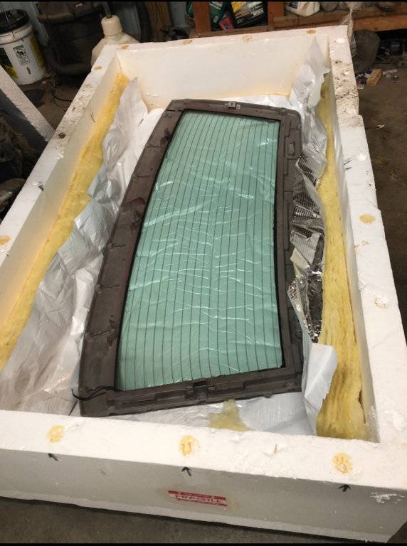

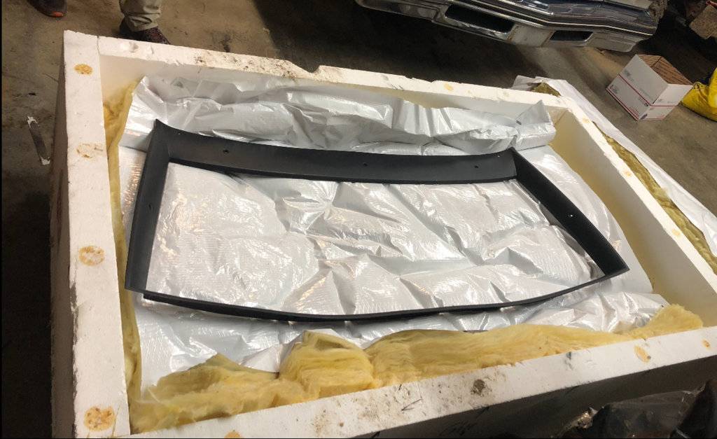

Rear window plug and glass for an Imperial/Salon upgrade I’m planning for the spring.... on its way!

Interior trim for window.
Also snagged the big plastic rear trunk cover that goes over the latch.

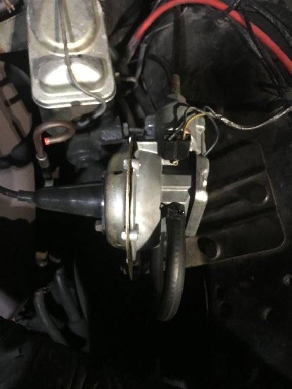

No change in operation. Still needs help from my right foot to engage and accelerate. But at least it looks better and does not have the frayed cover of the original.
Thinking the dump valve or control valve leaking/not sealing properly. New unit on the way but still curious as to why it’s not working correctly. May take a dead unit apart to figure it out.

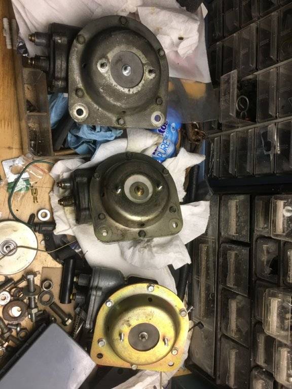

Cruise control “fixed”....

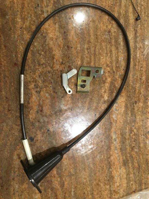

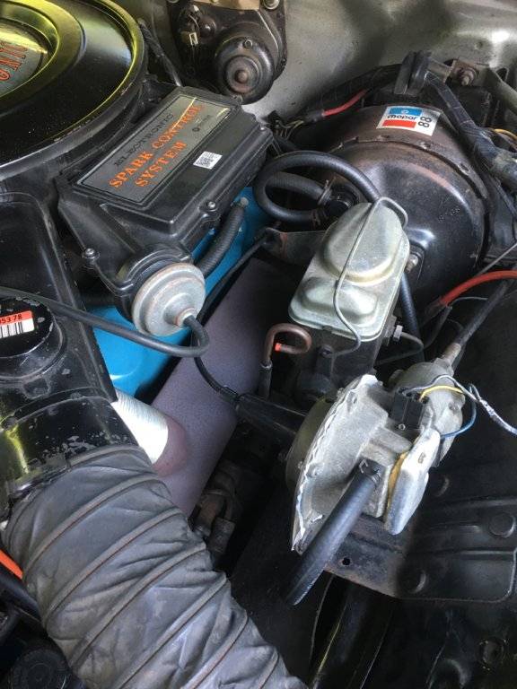

Having been working on getting the last remaining inoperative accessory back on line, I installed an NOS unit I ordered last week.
Now working perfectly.
Here they are... the three stooges. The top one was my old pull off “spare” that only engages at high speed. The second was the one that came with the car. I put a new diaphragm in it and it engaged from as low as 30mph but needed help getting to and holding the set speed.... no bueno. The third one is the NOS unit that works perfectly.

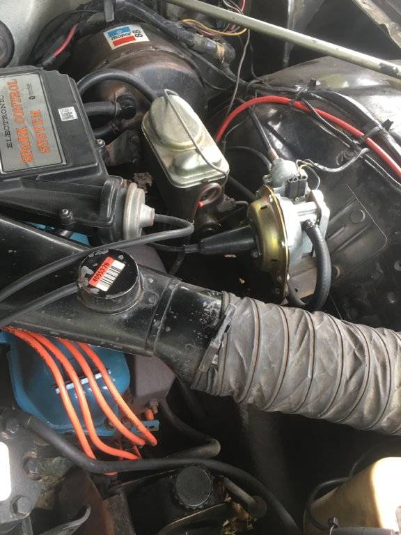

Here is the NOS unit in.
Happy today.
