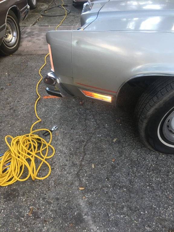

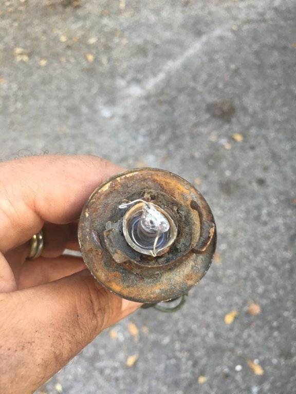

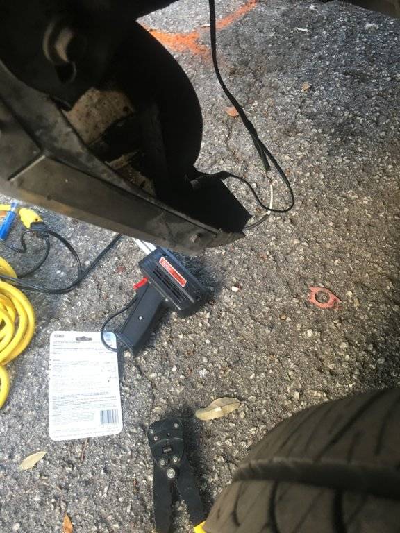

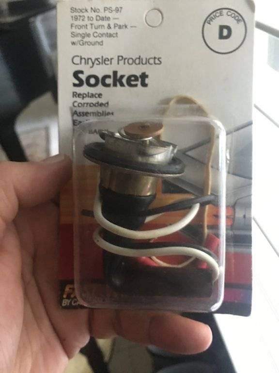

Just came in today’s mail.....thanks Jeff!
Perfect match..... three offset prongs.
Used shrink tube over the end of the socket and over the soldered connections. PIA to do it at home but the shop was set up to do a bit of painting for tomorrow.
Success.
Rotten socket retired to trash.

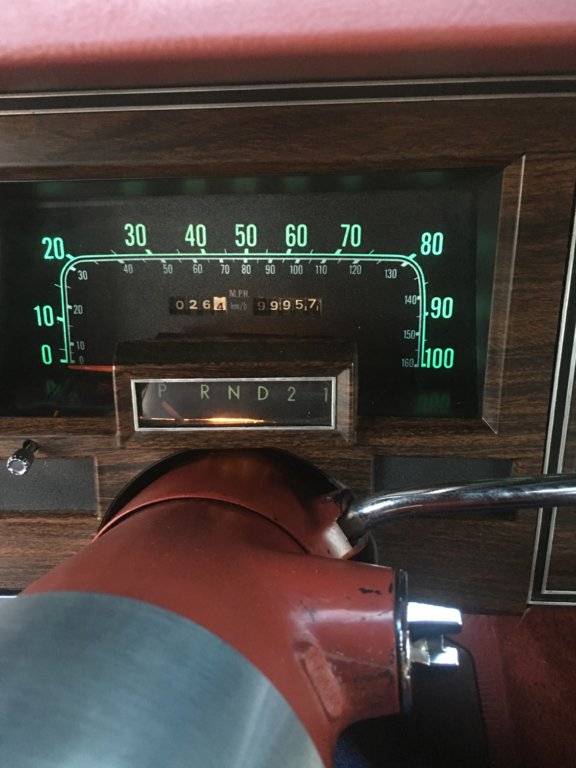

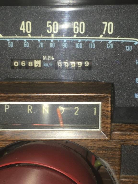

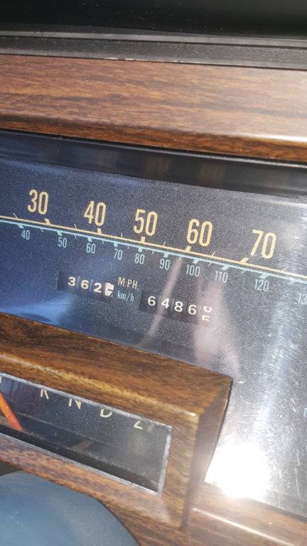

Zeroing/roll over celebration today with trip out for ice cream at local historic shop called Walls in South Miami just off US1 and 67th Ave. This place was a favorite of the girls when they were little because the show cartoons screened on the wall outside.
Had not driven the car for a few days waiting to celebrate all together.
Almost There!!!!
Daughters and wife who humor my silly little celebrations.
My girls
Rolled over just as we turned in.
Fun night after a long week.

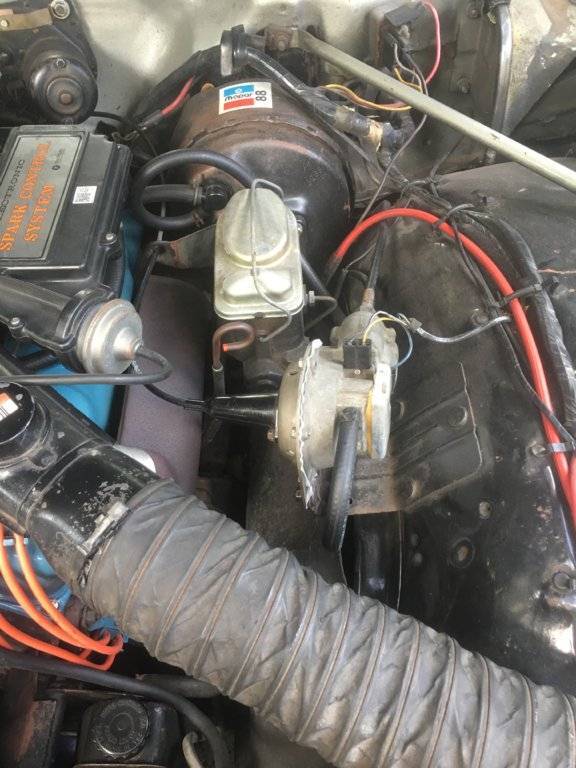

Still had the cruise control to get working right.
Decided to take a break from the Engine vibration for a bit. It’s really fairly minor but enough to drive me crazy. It was also something I could work on at home.
When I last wrote about it, the cruise control was engaging but only at higher speeds and with help from my right foot.

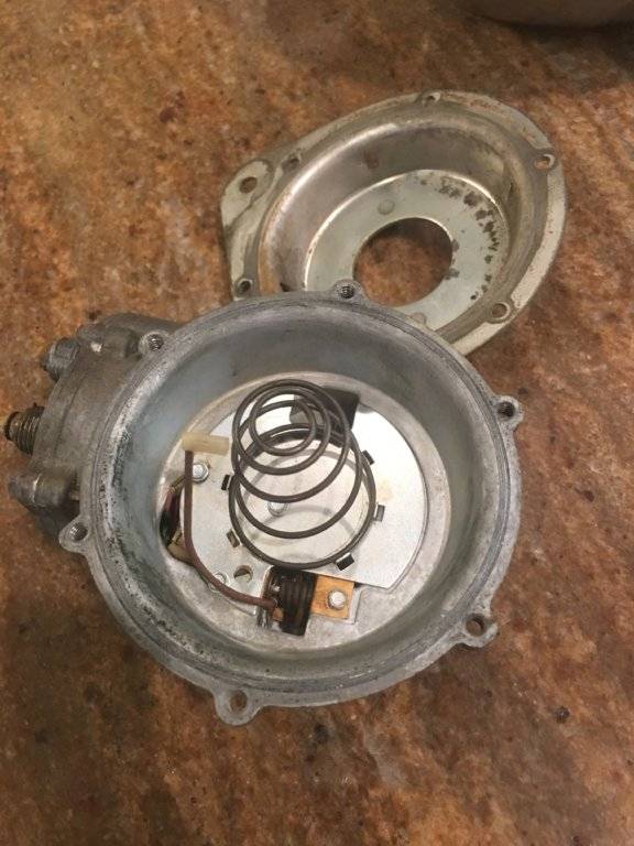

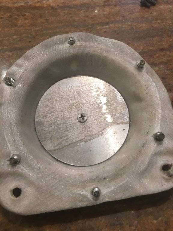

This is the cleaned up cover from the unit that came with the car... it wasn’t engaging at all.

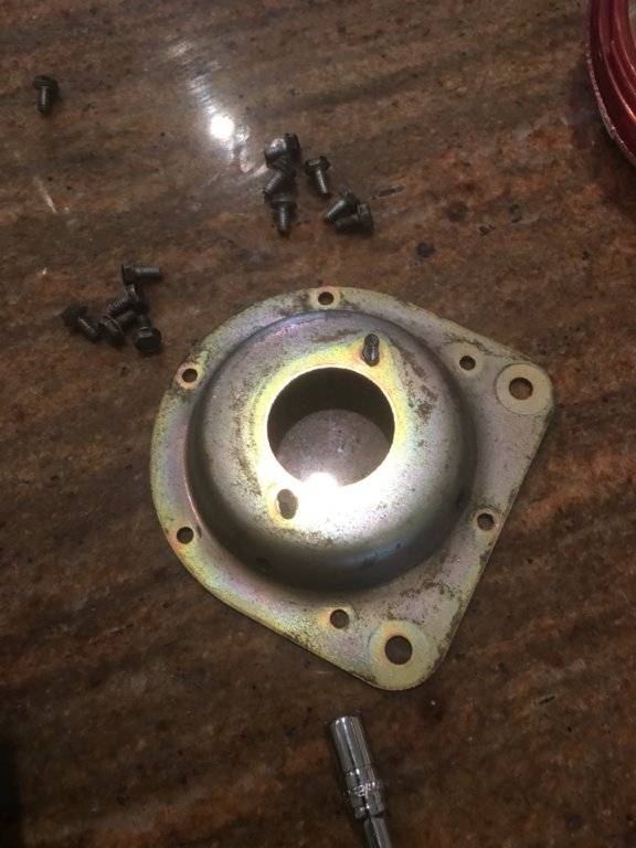

Some careful checking revealed that the reed valve was stuck between the internal block and vacuum pipe. A little wiggling with a vice grip brought it out enough to allow movement again.

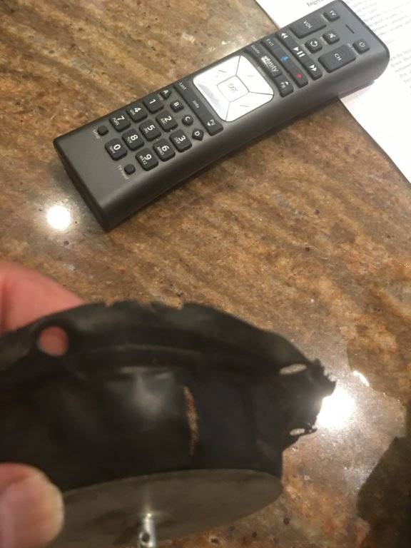

I saved the original bellow to use as a model.
You can see here it’s completely ventilated with holes.

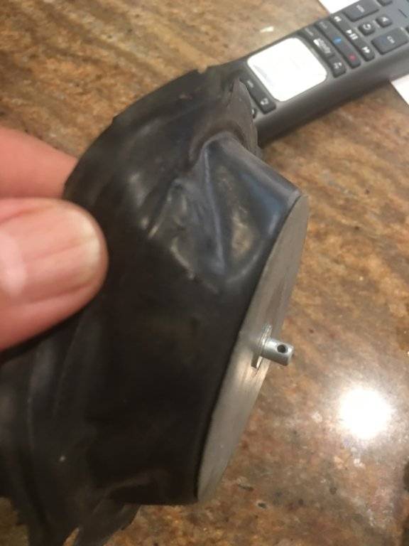

I took the replacement bellows out of the spare unit i was running. Cleaned it and noted that it leaked slightly along the edge. You can see the lack of a “bite” mark at the lower left of this view. Good quality replacement made of silicone with cloth reinforcement.
And..... in
Back in and working... sort of. It now is engaging at 30 mph. But it needs my right foot to help it along.

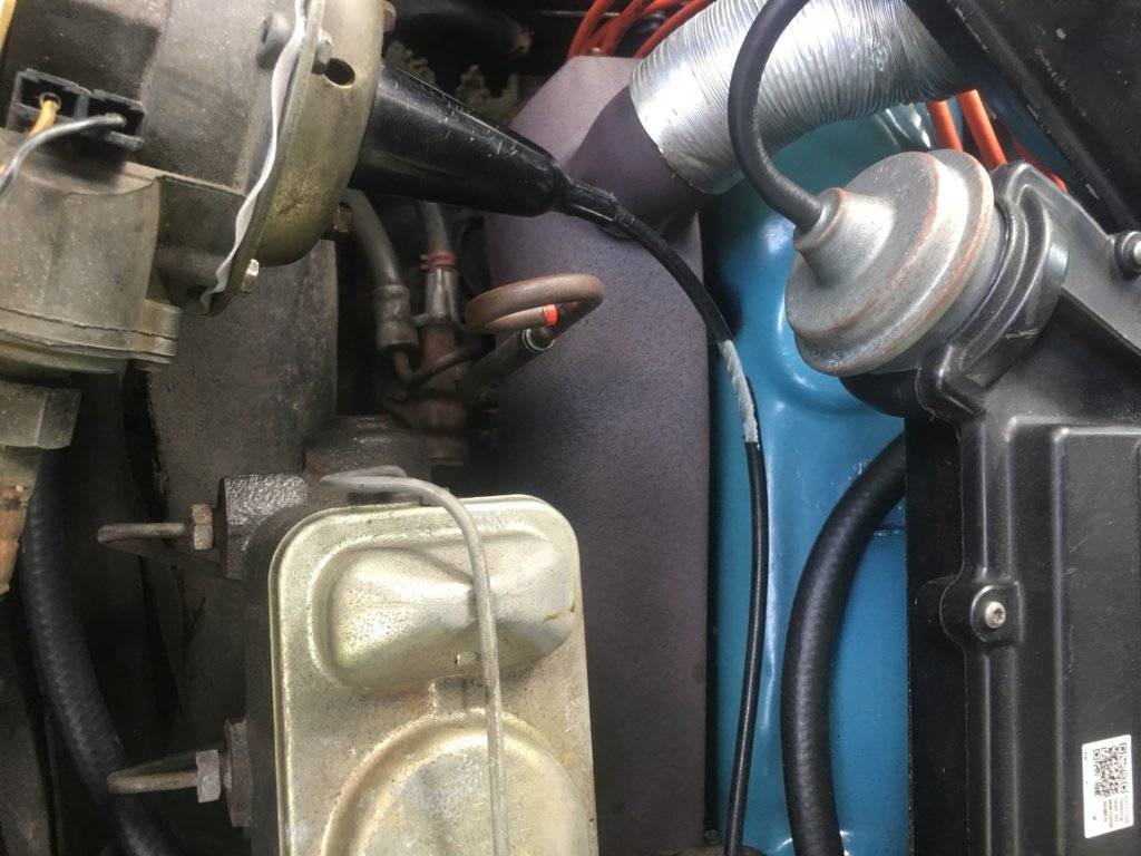

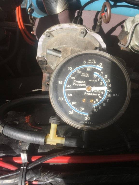

Cable cover is coming off and I’m thinking the cable may be binding enough to inhibit the bellows from pulling it. Same problem as before but working a little better. Checking vacuum to the unit first and is good.
Checked in series to see if any internal leaks. Vacuum is good at 17” to and inside the transducer unit.

Here’s the video “****” of the vacuum test on the transducer. Increase in vacuum to 19” came when A/C clutch cycled which you can hear at the very beginning and end. Otherwise vacuum pretty stable.

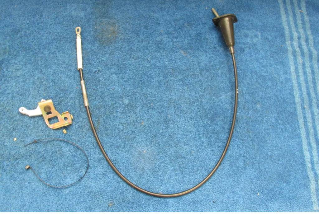

I just ordered an NOS actuator cable to rule it out as the problem as I noticed a slight kink at the cone cover/cable interphase which may be binding. The other issue is internal vent control in the transducer that may not be fully actuating. Judging by my hand fish scale guage it is taking about 12 lbs to start the cable moving which is quite a bit of pull.
