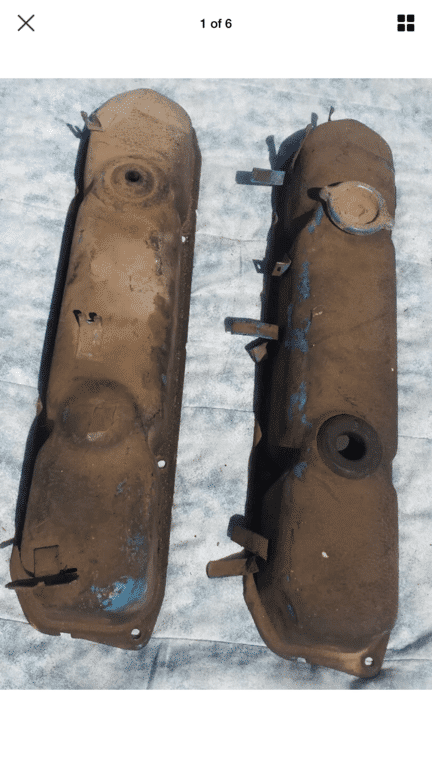

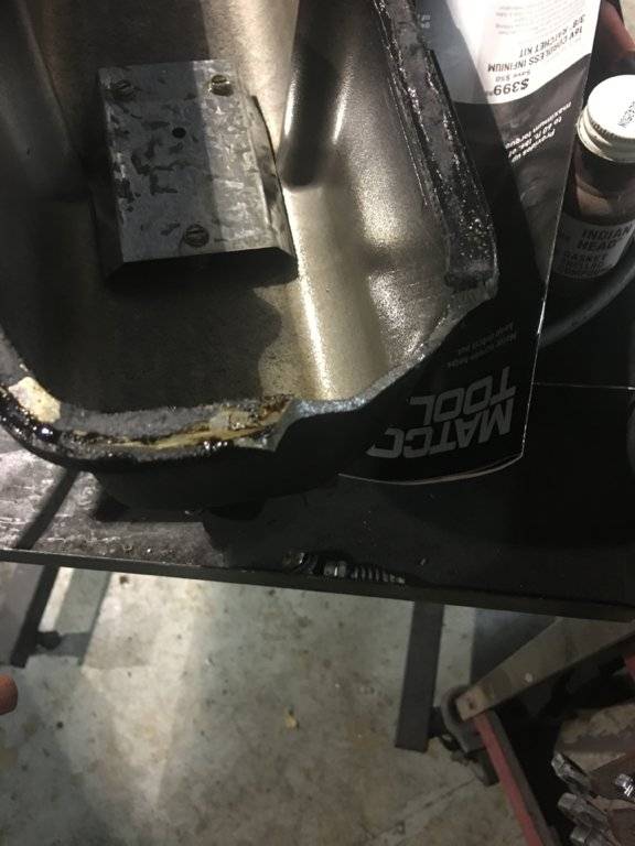

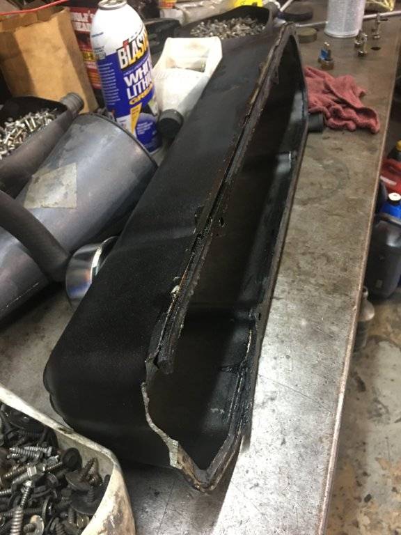

Weeping valve covers weren’t weeping....
I swear I didn’t torque them past 15 pounds! I have another car with aluminum heads and that’s the max I do. Best I figure is they were cracked from before.

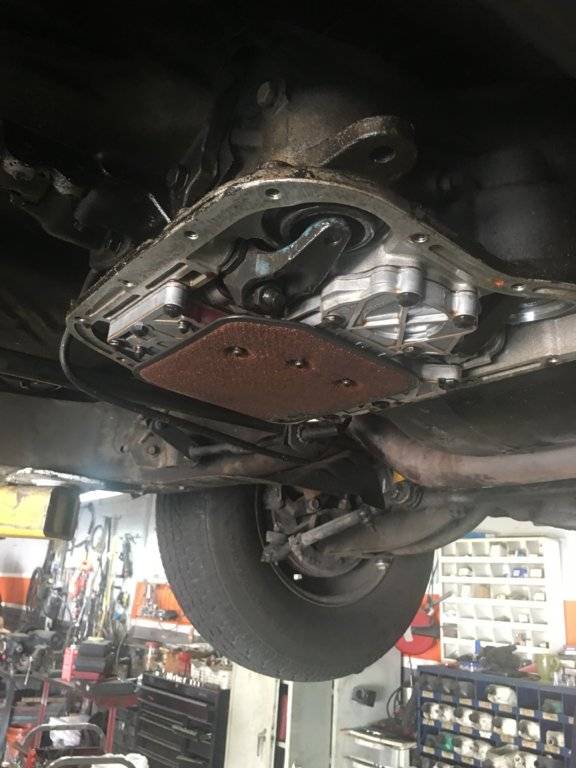

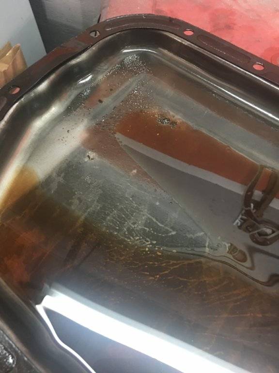

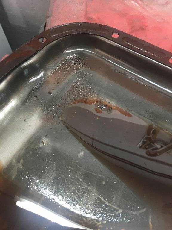

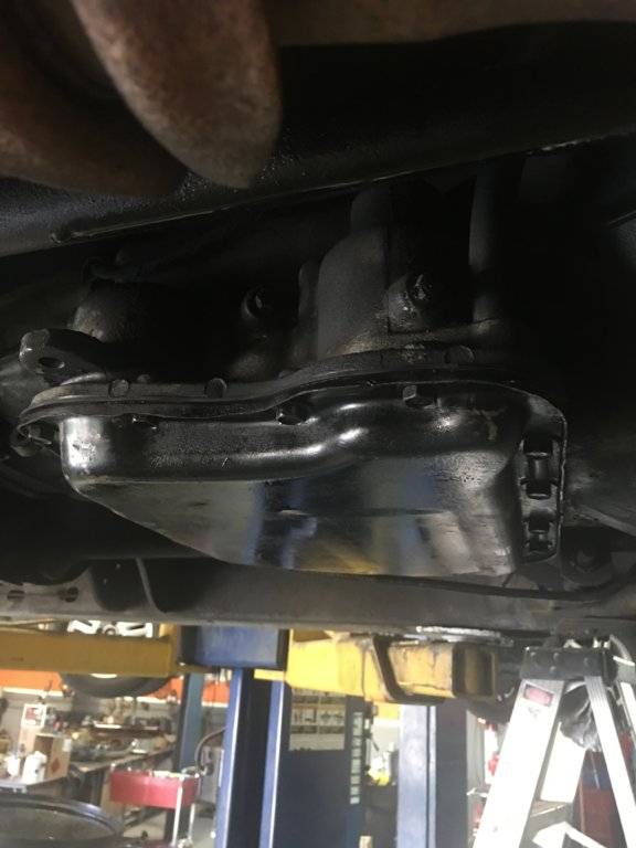

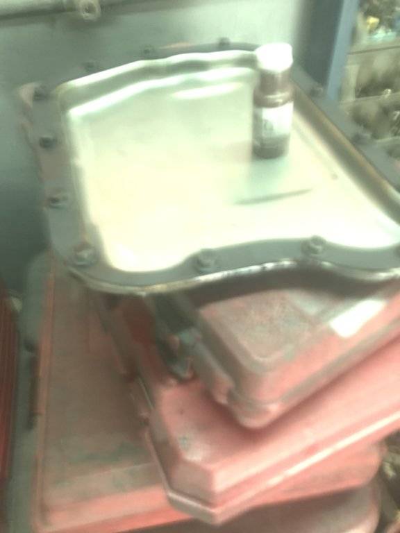

Changed tranny fluid and filter. Some sediment in the pan but I’ve seen much worse

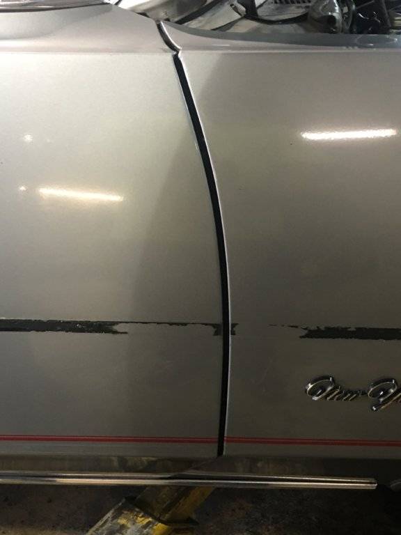

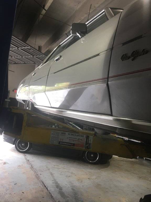

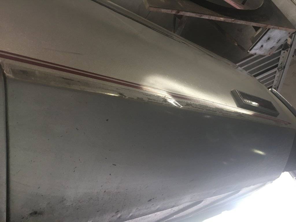

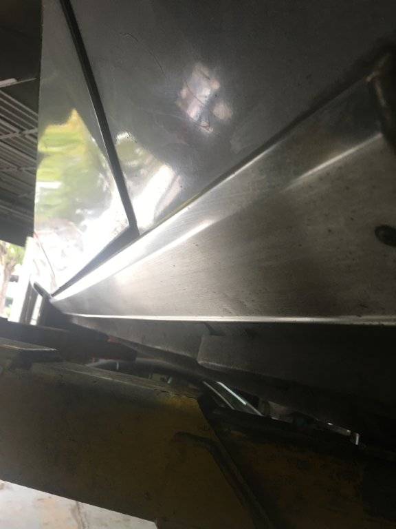

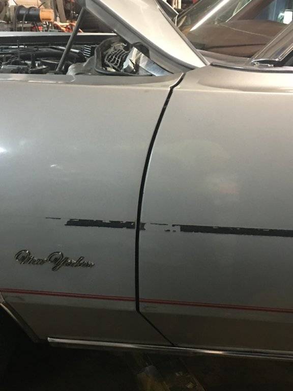

As long as I had her up, cleaned up the glue from the lower sick on rub strips and lower rocker trim.

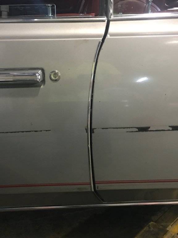

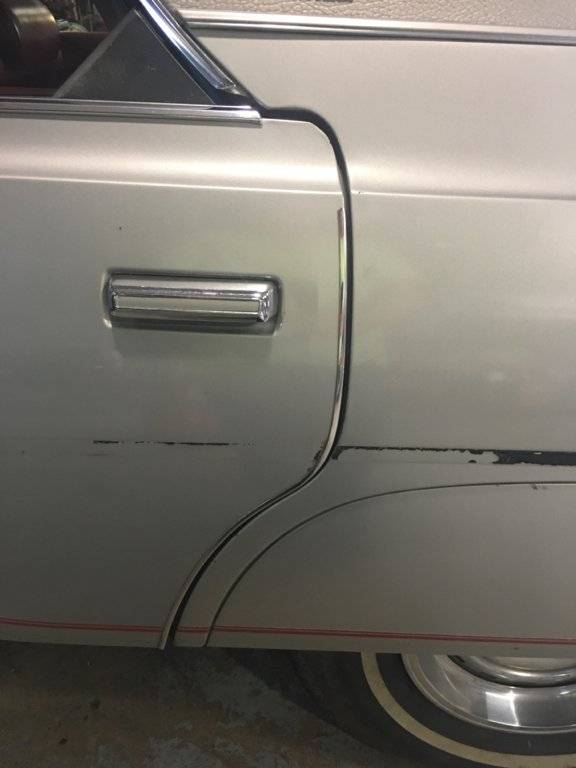

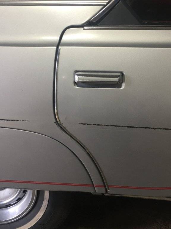

Little dent and previous repair on drivers side... not too bad so far.

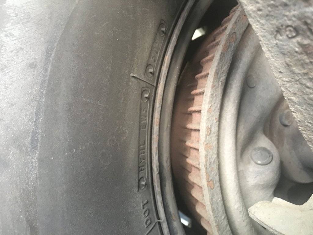

  • Flushed brake fluid was a little brown. Brakes still a little mushy but better. The wagon’s brakes will stand that old girl in her nose but these feel noticeably weaker.
  • Tracking down some oem steel valve covers.

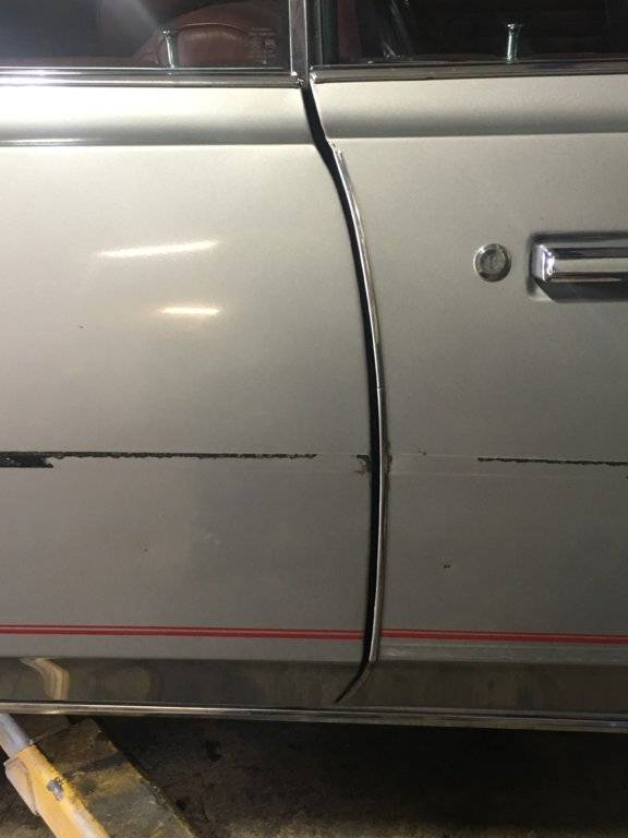

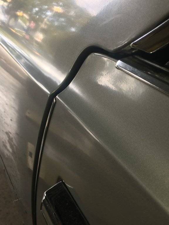

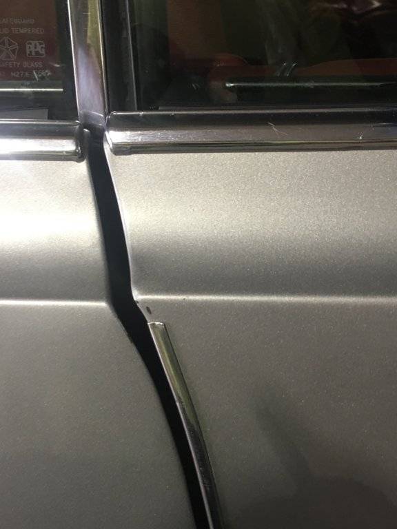

  • Doors and panel alignment is absolute ****.... I know I can do better.

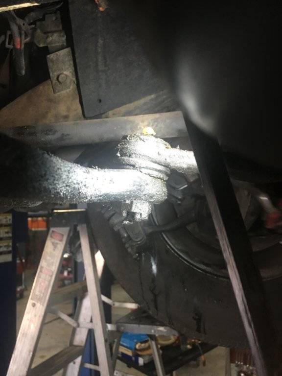

  • Lubed the front end and only the rear universal. Front has no lube nipple (Zerk fitting)......
  • ....and neither does the pitman arm joint. But, it does have this plastic plug that may be there to protect a hole to put one in.

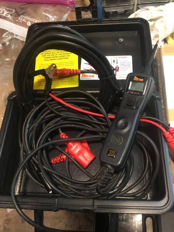

I’m planning to start with the fuse and go from there before tearing into the dash. I learned to diagnose a lot before tearing in. It may take more time on the front end but will save you time and money in the long run. I also have one of these to help me.... which if you don’t have; you need to keep up these or any cars.
Steering wise everything was tight and sericeable on both of my Formal's......except the idler arm. I had to replace them on both cars. Moog has an improved design idler arm that DOESN'T FIT worth a damn. There is a couple of places like Brads that has NOS idler arms but wants a lot for them. I think Tony Diagnosta (however he spells his name) has a few too.
Update on broken valve covers.
They’re from a ‘73 440 which should work fine with new gaskets. And you all know I have a soft spot for anything 73.......
Called the guy direct and they’re on their way....... hopefully tomorrow.
These are the FelPro valve cover gaskets I always use. I never have a problem with them. They are for a 69 Charger R/T 440 severe duty. A heavy fiber/rubber gasket that you will like. AAP will either have them in stock or can get them later in the day or next day.
Best tool ever.
You should have adjusted the bands when pan was down.
Those cast aluminum VC always have problems on crooked iron heads, especially with 1000° exhaust manifold right next to the 1400° melting point aluminum VC.
Valve covers on the way but won’t get here until Friday. :(

3M makes a killer rubbing and polishing compound that comes in a tube. It's expensive $50 a tube and used by the pro's with a buffer that will make your paint look brand new.
Just mho opinion on the buffing.. unless you have done it before and have the proper buffer with the proper pads and most importantly the skill set. I'd get a professional do it.
Those guys do it everyday and make it look easy, but there are certain techniques to doing it right.
By the time you buy the buffer, the pads (many to choose from for the different compounds). Then add in the compounds like Bob mentioned, just how many will it take to do a formal when the guy running the machine isn't quite as proficient with a buffer as a pro. I think you'd be better off plunking down the $250 or so and get a pro to do it.
Unless like I said, you've done it before, then never mind. Lol
