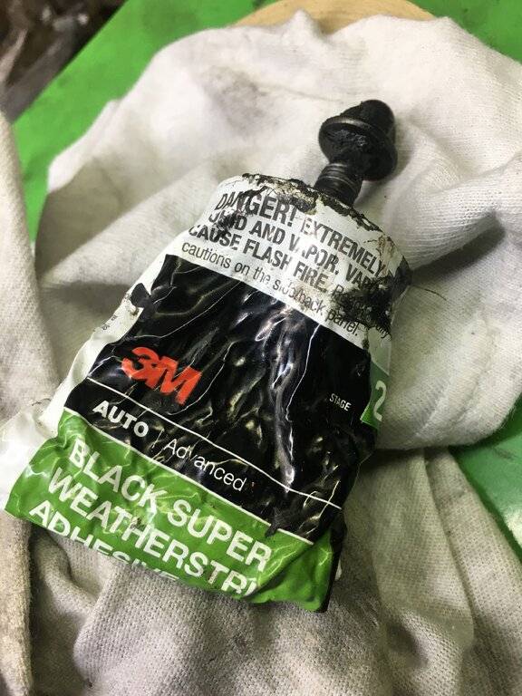

Trunk weatherstrip in.
Very little tape required to hold while it set up. Hint: follow the directions. Apply both sides and let get tacky. Then bravely stick. You get one shot at it.
been using this stuff for years. The black is better than the yellow IMO. Both will work. I think factory used yellow.

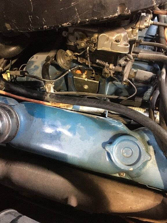

Choke thermostat in and wired in correctly.
