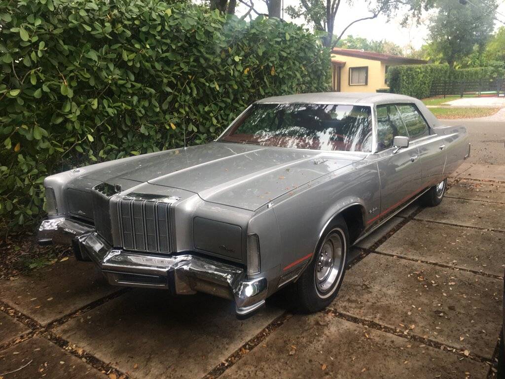

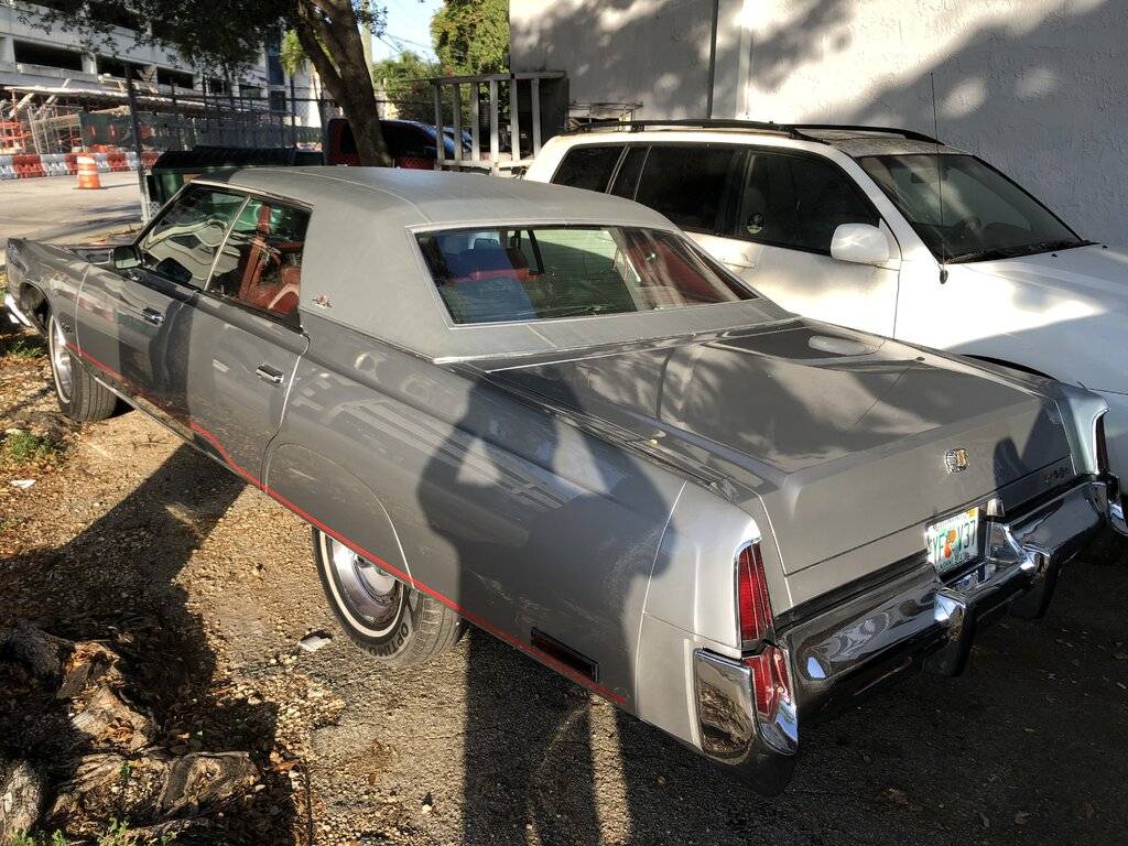

Not feeling it for the original style pinstripe. Too 70’s garish for my taste. Perhaps a more tasteful double thin stripe like what was on the trunk.
I agree. It belongs on the upper crease line. I never liked having the pin stripe down below.
Not the location that bothers me, it’s the thickness that is hurting my eyes. To elegant a design for such an obvious and heavy handed thing. Will try the double thin pinstripes just below the current one. First one side to live with it for a while and then, maybe, the other.
I'm with you. When I had my NYB painted I decided to move the pinstripes to the top, even though in '78 they were supposed to be at the bottom.
No offense, Javier but I'm thinking that red is a bit "Loud" more than anything. I know you stated that that color was original but.... meh. They didn't do everything right.
A nice thin with thicker double burgundy/maroon perhaps? Would kind of match the hides.
i think you’re right. Too bright. Needs to be darker or thinner to pull it off.
