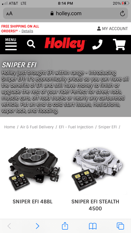

Option 2) Pull the ELB and Thermoquad (much to Stan’s final relief) and install a Holley Sniper EFI system.
Advantages: beyond the obvious... extremely high cool factor, drivability, performance, reliability, comfort, predictability. Takes advantage of the current ELB distributor.... which satisfies the nostalgic in me. (really uses what Chrysler was trying to do to its full advantage with both fuel and timing control) It’s evolutionary not radically different. I can do it fairly easily at the shop over a few days. I’ve rebuilt fuel
Injection systems in my Cadillacs so it doesn’t intimidate me at all. It come with pre set profiles you can actually tune.... meaning hours of fun and digital readout to play with. It’s a throttle body system so it will make some cool sounds, just a little different. And..... will look like a Thermoquad which satisfies the aesthetic requirements I live by. May be a sign if things to come for the fleet as parts get more rare and harder to find.
Disadvantages: mo money (about $1500 all in I figure), mo time to do which will require planning and logistics (and you all know how much I hate to do that) will lock me into the beast a while longer than I had planned.

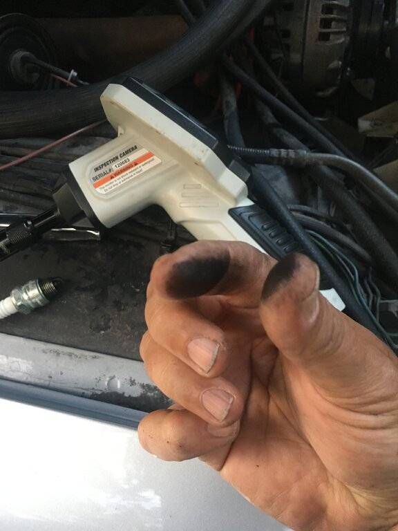

Here are the plugs for numbers 6 and 4. Six is wet oil fouled... four is textbook perfect with a light tan soot on it.

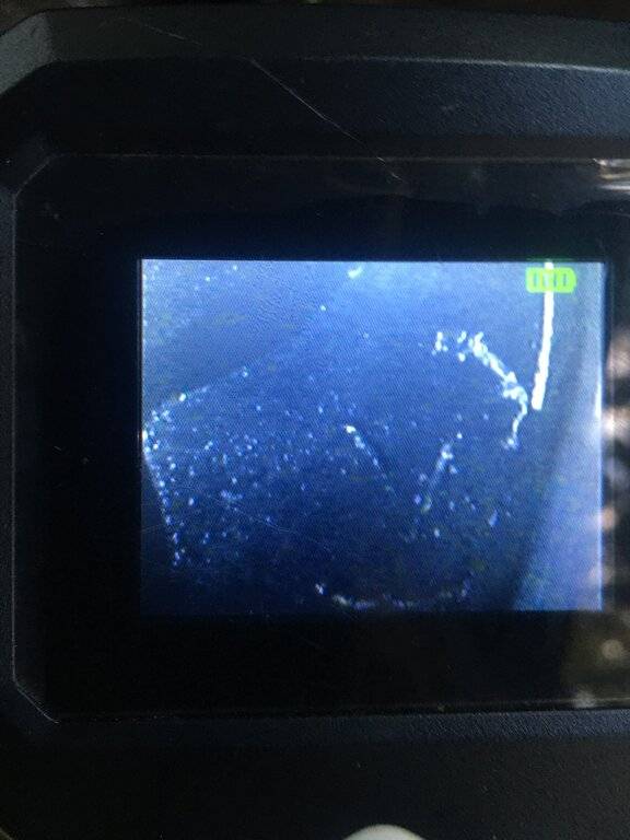

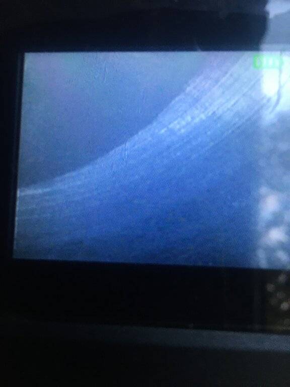

Camera in number six. Top of piston is black with soot. The marks were made by me with the camera as I tried to look around. Camera has a 45 degree mirror attachment that I won’t use because it can fall of. So no way to see the top of the chamber except in passing through the spark plug hole. More soot.
Honing is good with only a little bit of scuffing.

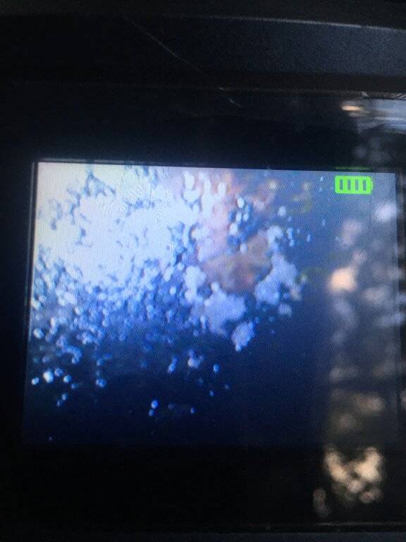

Top of piston is literally wet with oil. I’m thinking valve stem seal fail and valve guides??? So soon? Somethings up.
Pulled the camera head out to clean it. Oily sooty mess.

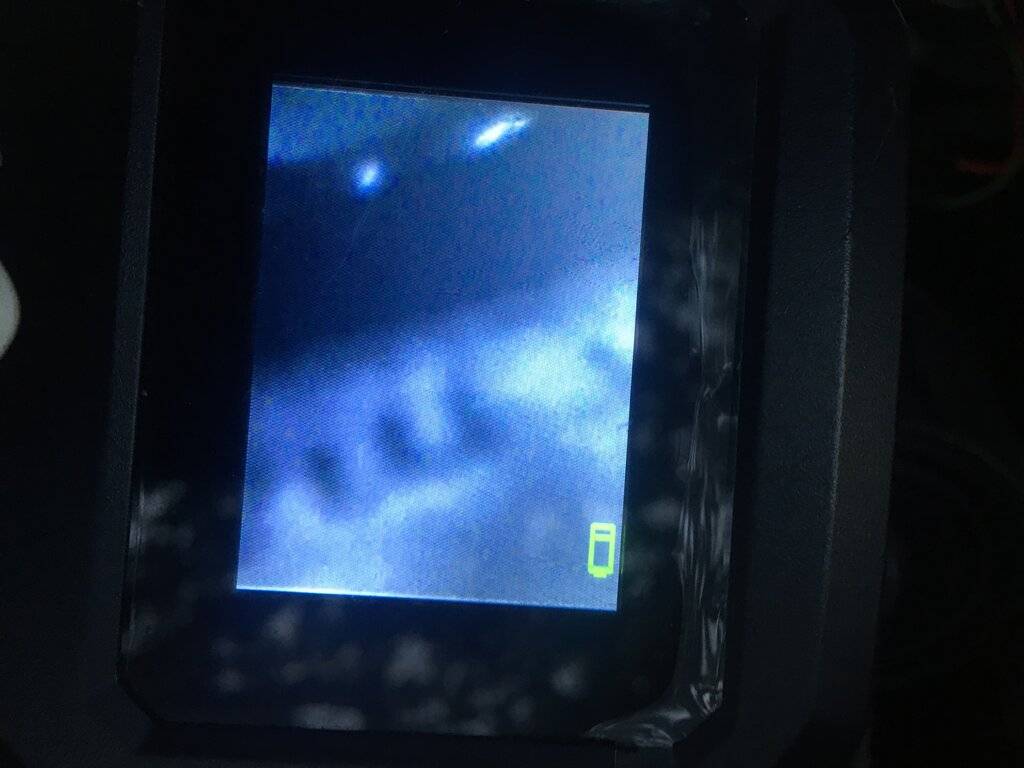

Since the oil filler cap was available, I put the camera through to see what I could see. When I thought I saw writing... interesting.
Yep... that’s an “m” all right. As in “priming” the oil system before initial start.... it’s the instructions/checklist of things to do. Took a while but I was able to read it and figured it out.
Somebody ****** up..... by accident I’m sure.
But that appears to have starved the valve guide which probably stuck the valve which bent the push rod which mashed the lifter that lost valve lift that killed the cylinder on the engine that Javier had built. But that’s just a good guess.

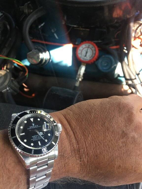

Thinking through the problem.
Decided to run a compression check on number 6.
here is video:
20 min later.....
one hour later only lost 2 psi. Valves are fine.
Oil is probably coming off the cylinder walls and past the rings through suction. I’m thinking the intake may also be stuck (or partially stuck) but allowing mixture in past it through suction because it takes a full 5 or 6 cycles to fill.
That leaves 2 possibilities. Valve train ( lifter, rocker, pushrod) or cam. I hope it’s the former and not the latter...
I’ll get Ivan to pull the valve cover and let him take it from there. Either his people or the machine shop made the oops. We’ll find out Monday.
Am I missing anything?
Sorry to read about your troubles. I will be following with interest. BTW nice Submariner.
