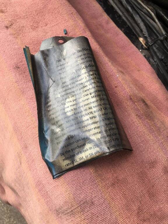

Oh.... and here are the instructions we found in the valve cover.
They were folded up at the top of the cover right over #6. So. There also goes my theory about the paper trough limiting lubrication. Initial turning of the engine showed plenty of oil flowing over the top of the rocker on the the seal and guide. No doubt the paper has something to do with #6 being dead but haven’t yet put my finger on it.

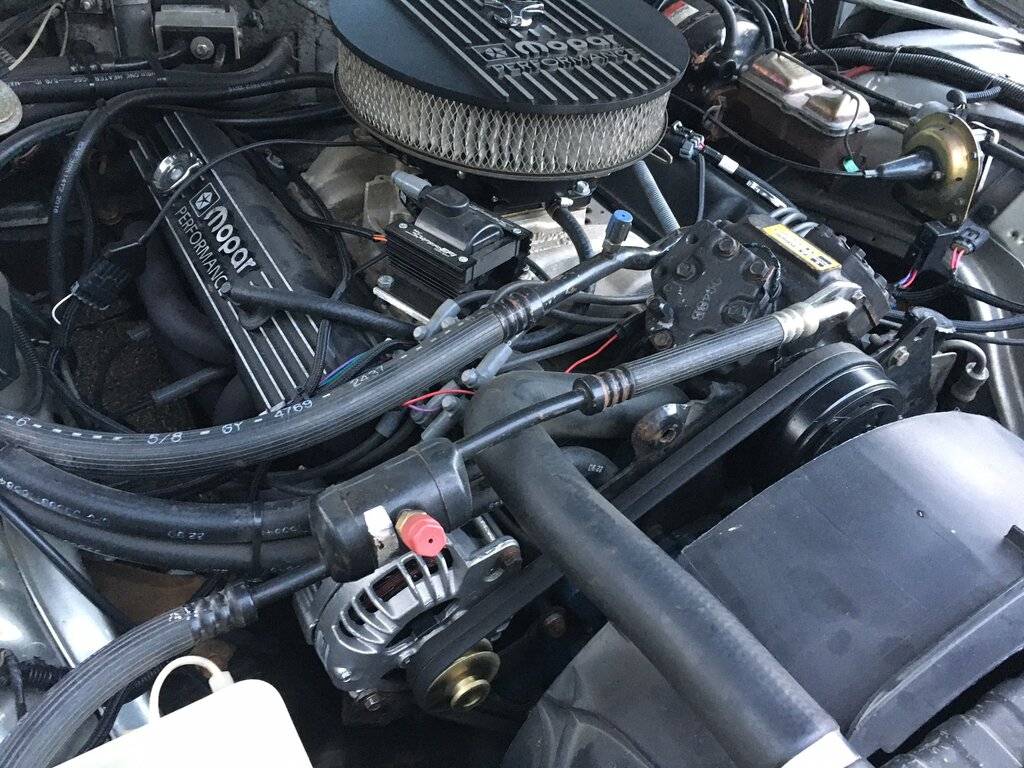

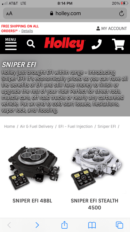

Option 2) Pull the ELB and Thermoquad (much to Stan’s final relief) and install a Holley Sniper EFI system.
Advantages: beyond the obvious... extremely high cool factor, drivability, performance, reliability, comfort, predictability. Takes advantage of the current ELB distributor.... which satisfies the nostalgic in me. (really uses what Chrysler was trying to do to its full advantage with both fuel and timing control) It’s evolutionary not radically different. I can do it fairly easily at the shop over a few days. I’ve rebuilt fuel
Injection systems in my Cadillacs so it doesn’t intimidate me at all. It come with pre set profiles you can actually tune.... meaning hours of fun and digital readout to play with. It’s a throttle body system so it will make some cool sounds, just a little different. And..... will look like a Thermoquad which satisfies the aesthetic requirements I live by. May be a sign if things to come for the fleet as parts get more rare and harder to find.
Disadvantages: mo money (about $1500 all in I figure), mo time to do which will require planning and logistics (and you all know how much I hate to do that) will lock me into the beast a while longer than I had planned.

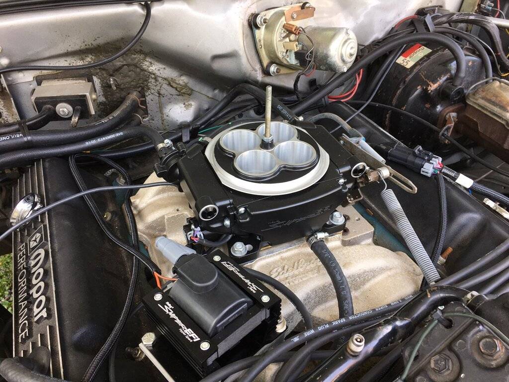

I currently have the holly sniper EFI full system in my 440 Chrysler New Yorker Brougham I love it. It took 2 separate runs on the Dino. The first run got about 276 hp 365 foot pounds of torque at the rear wheels. The engine was pulled and built by the previous owner board out mild crawler cam TRW pistons Edelbrock intake hooker headers and a junk carb that wasn’t working correctly. It started running rough only to find out several of the plugs are getting fouled out due to some oil getting past the rings. The engine said before I got it assuming the rings scored the Pistons and that’s why the Oil is getting bad but anyways. Change the plugs put it back on the Dino re-tuned everything went through all the programs and settings much more thoroughly this time I ended up getting 295 hp and about 380 foot pounds of torque at the rear wheels. Car is like night and day now you stand on it and it pushes you back in a seat for 5000 pound car that’s pretty damn good.

I currently have the holly sniper EFI full system in my 440 Chrysler New Yorker Brougham I love it. It took 2 separate runs on the Dino. The first run got about 276 hp 365 foot pounds of torque at the rear wheels. The engine was pulled and built by the previous owner board out mild crawler cam TRW pistons Edelbrock intake hooker headers and a junk carb that wasn’t working correctly. It started running rough only to find out several of the plugs are getting fouled out due to some oil getting past the rings. The engine said before I got it assuming the rings scored the Pistons and that’s why the Oil is getting bad but anyways. Change the plugs put it back on the Dino re-tuned everything went through all the programs and settings much more thoroughly this time I ended up getting 295 hp and about 380 foot pounds of torque at the rear wheels. Car is like night and day now you stand on it and it pushes you back in a seat for 5000 pound car that’s pretty damn good. View attachment 456221View attachment 456223
nice install!
