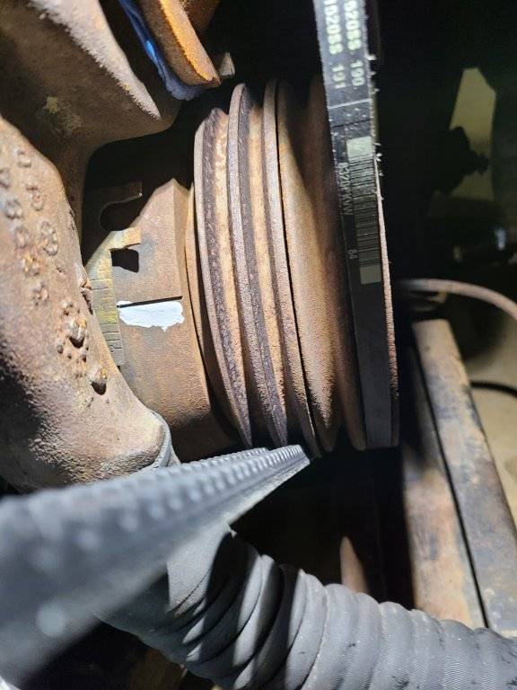

About 9 degrees of play in the chain, as shown below, gonna repeat test a few more times just to be safe
Second try, had 6 degrees of play, pretty good imo!
OK, what you've done is verify the chain slack.
Your first reading is on the excessive side and your second reading sounds better.
There's a couple things to still consider. First thing that jumps out at me is you tried it in one spot, backed it up and tried it again in the same spot. Really the way to do multiple tests would be to pull the engine through one rotation and check it again. That would do two things. First is it checks the cam gear (the one that fails) at a different spot. Crank turns twice for every one rev of the cam. Second is that you might be not completely taking up the backlash in the chain and gear by backing it up and trying at the same spot.
Now, let's say that even if you do this again, it passes muster. This still just looks at chain stretch at only one point and doesn't take into account that the cam gear may have jumped a tooth.
Since (IMHO) the chain is really still suspect, I'd check it again, even doing it at approx 1/4 turns of the crank. Make a chalk mark on the damper if you need to at these spots.

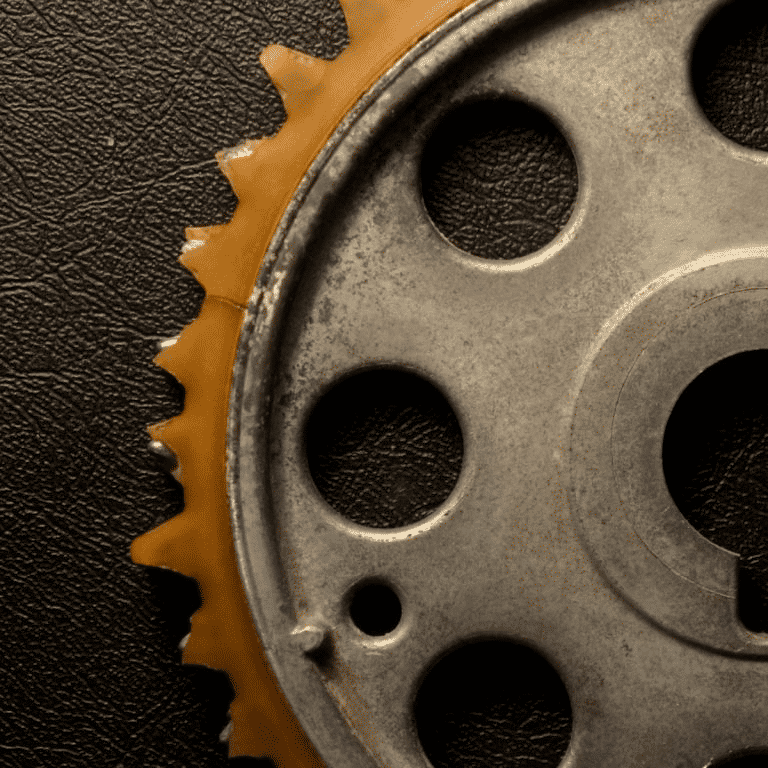

I tried to find a good pic and couldn't.
This is the best I could find.
This is what fails and not the chain. Yes, the chain will stretch, but the main culprit is this plastic gear.
Note how not all of the teeth are broken. You can have a good part of the gear where everything checks good and a bad part where there is a ton of slack... or even jump a tooth.
Now... I'm not saying the chain is your problem, just want you to understand what the magic is before you discount it completely.

Okay, I realize it may not have been clear in my post, I did actually take it around a full rotation before testing again.
